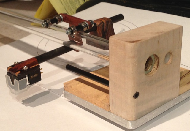

Hi Bill,
I set the latest arm up with a tracking force gauge then dial in by sight. With enough practice you can see where the cantilever should be displaced to, being a short arm it is hard to fully set by a gauge. Your ears will tell you when tracking is just right.
As far as glass, as long as its harder than the bearing material it's good enough, as long as its smooth you will only just be spending more money with exotic quartz and sapphire.
Colin

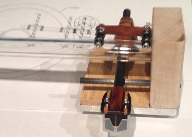

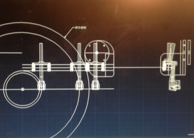

The Build Continues
Progress is being made slowly. Had a few design details to complete such as how to keep it simple but yet allow alignment and height adjustment. This is just pieced together for the moment. That will become more obvious at the end of the build. A version of what has already been done. Need to finish a few parts and drill/tap a few holes before final assembly. Hope it works!
I am no engineer so do not know about the finer points of arm design but I do wonder about the leverage between where the arm tube is mounted in the carriage and the mounting points of the bearings. this, I imagine would cause a small rocking movement with any vertical movement of the cartridge therefore moving the cartridge back and forth very slightly. If the arm, counterweight assembly was pivoted on ball pen tips or a knife edge on brackets suspended from the bearing shafts ( similar to the terminator), would this be a better arrangement or would there not really be any difference?
jamikl
jamikl
if you want to be able to play severe warps that is the way to go. The focus with the Cantus is to make the arm/carriage assembly as rigid as possible and to eliminate as much motion as possible. The less back and forth motion (tip scribing an arc) the better. You want the arm to have free motion in the horizontal plane and that's it. Best regards Moray James.
So is anybody listening to their builds yet?, since the addition of the 3/4" Alu support bar this has made another leap up in sound quality in the bass, better solidity reaching deep Down with the addition of lowering the tubes resonant Q. This is similar to what clearaudio does with the simplicity of a single larger tube which is internally damped with foam sheet for potential ringing.
Colin
Colin

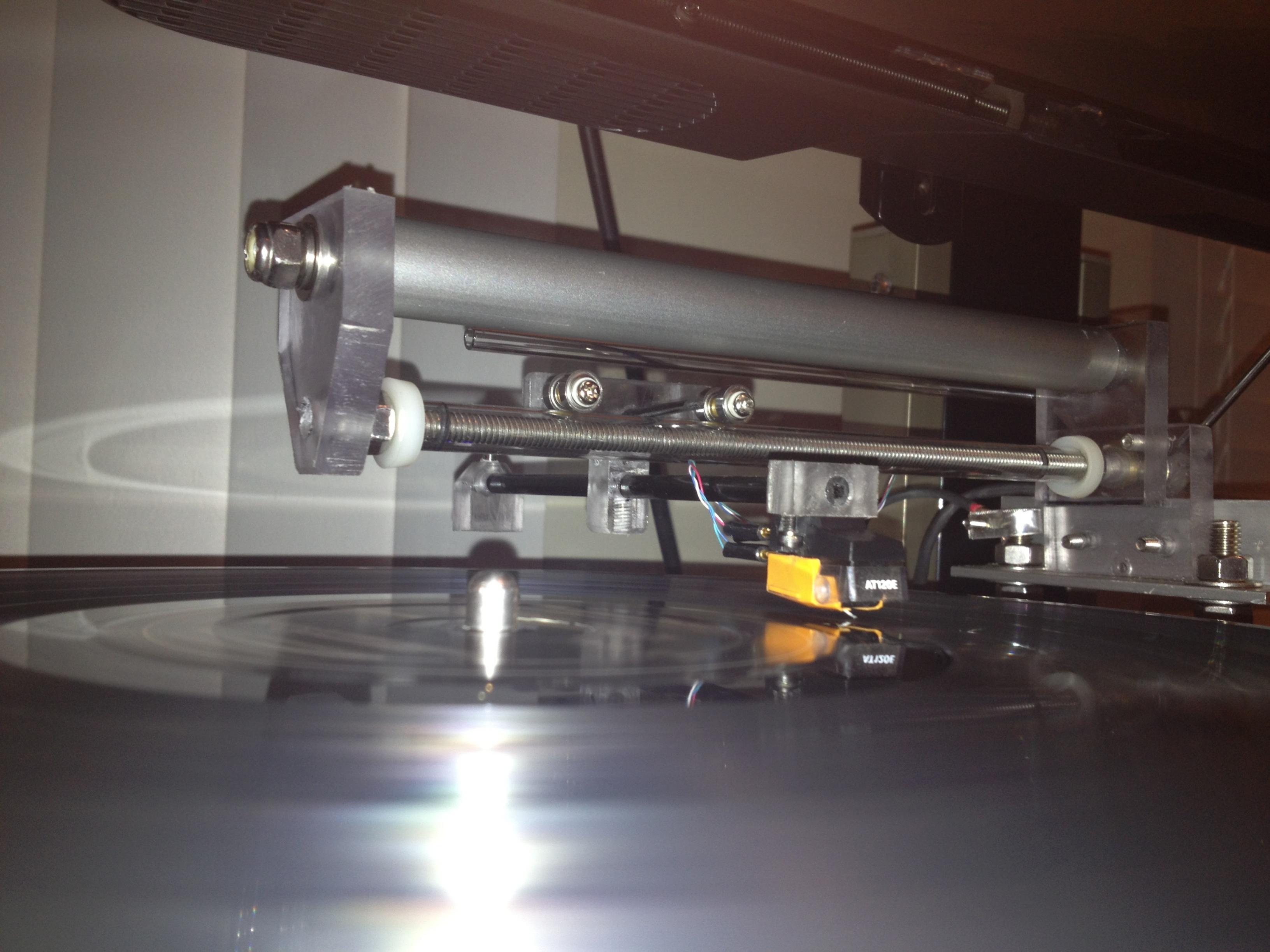

Hi Colin,
Thanks for this...it's definitely in my to do list! Just a few projects to get out of the way first. A question though. What's the thinner glass tube above and behind the arm for?
Stuey
Stuey

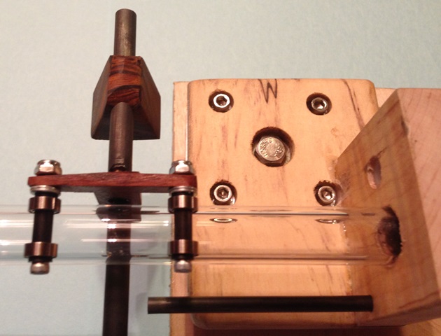

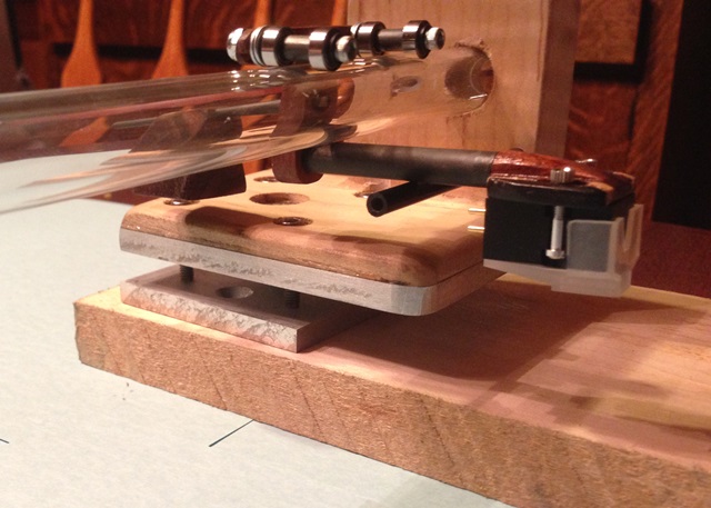

Leveling and Height Adjustment Set-up
The Base is pretty much completed now except for cue arm and wiring. Here it is mounted on dummy arm board to test the mechanism. Some fit and finish to complete as well but so far pleased with build.
If you see opportunities for improvement let me know.
Nice work sgregory!,
