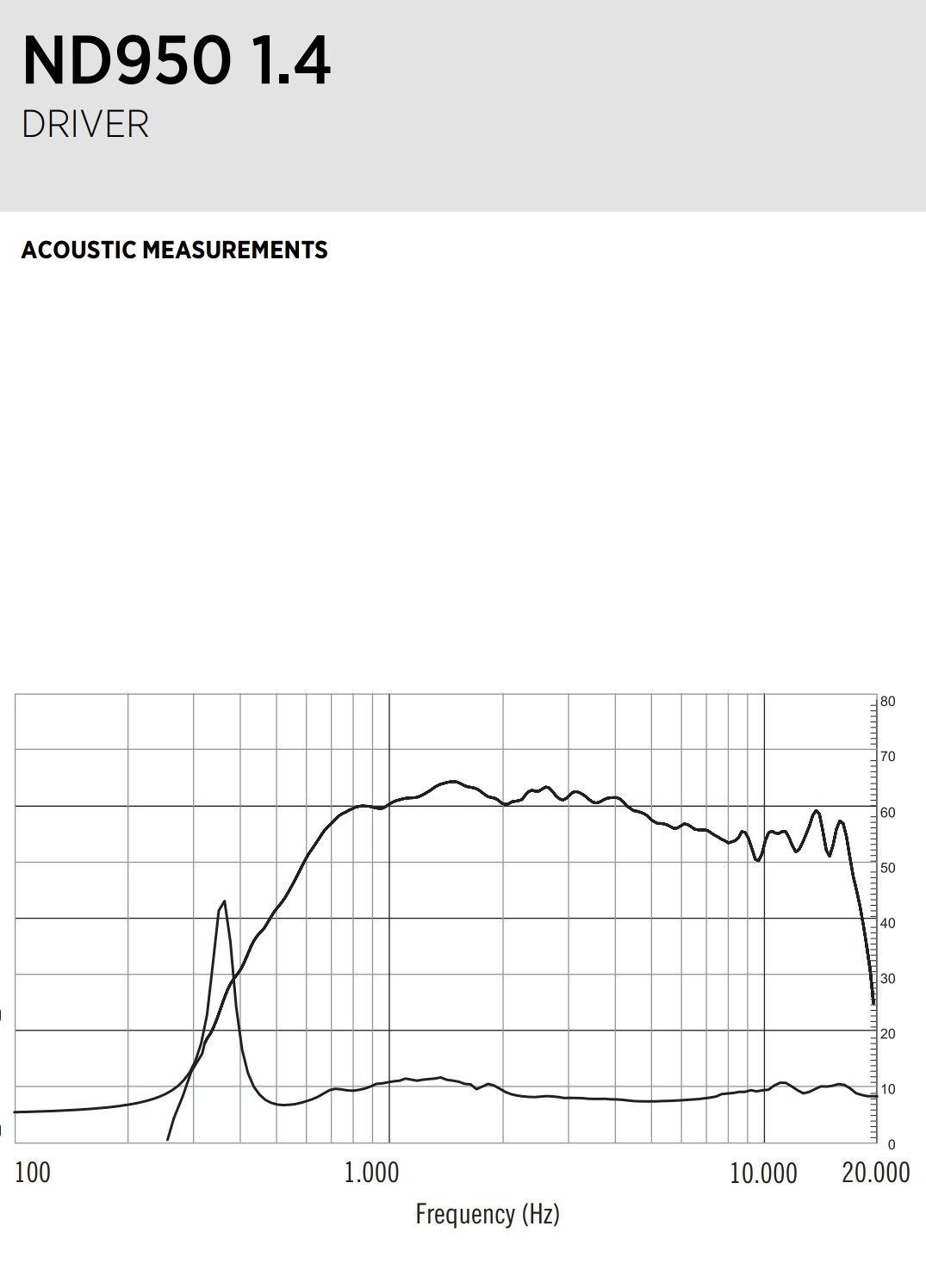

That is super helpful feedback. I do see the 18sound NDS1480N looks very nice. Last evening I managed to find a couple RCF ND950's in stock so I grabbed the last 2 they had. Definitely was not my first choice. Depending how they sound, I may replace them when B&C, 18sound's inventory problems are solved.

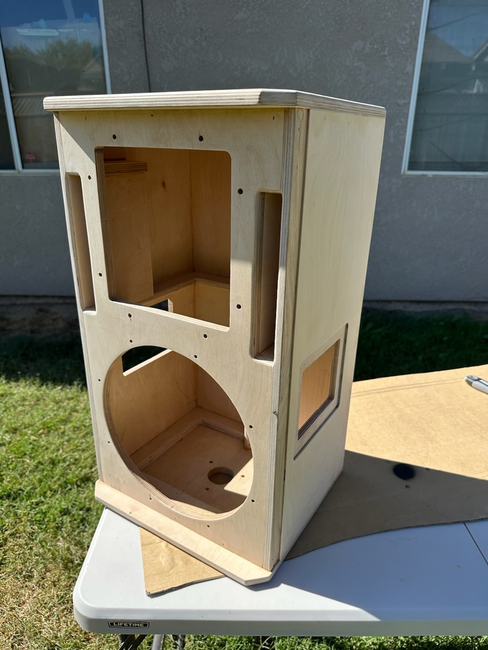

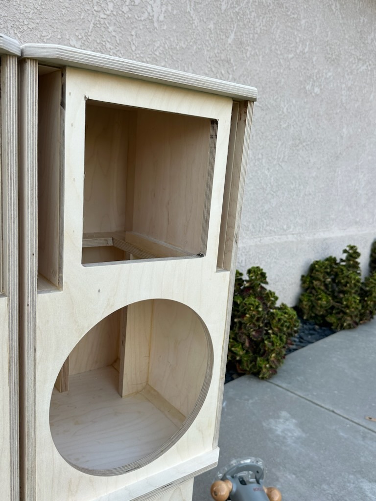

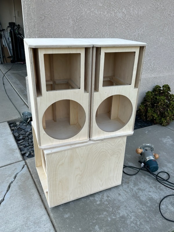

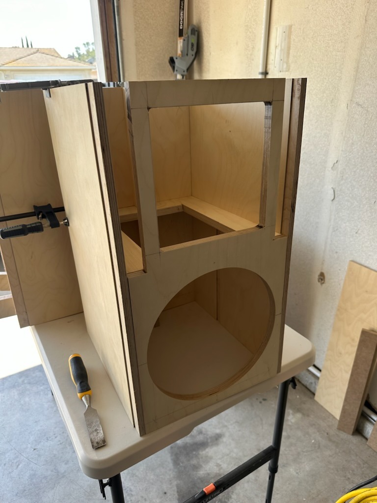

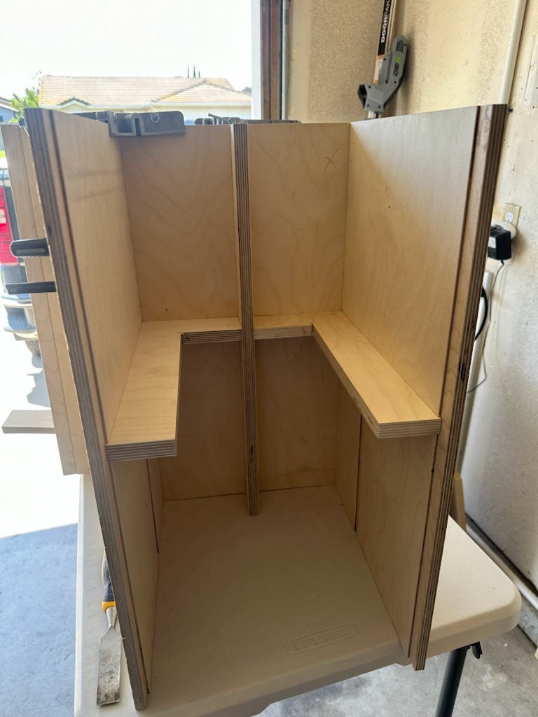

Okay so the prototype cabinets are done, minus the routing for handles and pole cup. See Attached. (waiting for horns to do COG) I do not plan to upload "as built" drawings because the end product was just to heavy and not necessarily a simple build if you don't have a proper router table, which I don't. I intend to follow through and use these as a learning experience for the final design which will use 15mm bb plywood. It was quite time consuming using mdf templates and a handle held router. I just feel there are better way to do this but they are still compact enough that I plan to use them for the next 6 months or so. Let's just say this has been a learning experience for sure. Lots of mistakes were made 😡
I have about 2 weeks until the horns come in. So I would like to use that time to focus on the crossover. I am having trouble finding affordable inductors for a 4th order crossover.

I find that I really like the sound of the RCF horn crossed between 750 and 800, granted the little exposure time I've had, has been somewhat limited and not in ideal situations. Additionally, I haven't compared that to a 1k or 1.2k crossover using the same drivers.
1. Do you guys have any thoughts on the ultimate crossover frequency for this particular combination should be? (RCF 950 1.4, RCF HF94, B&C 12NDL88)

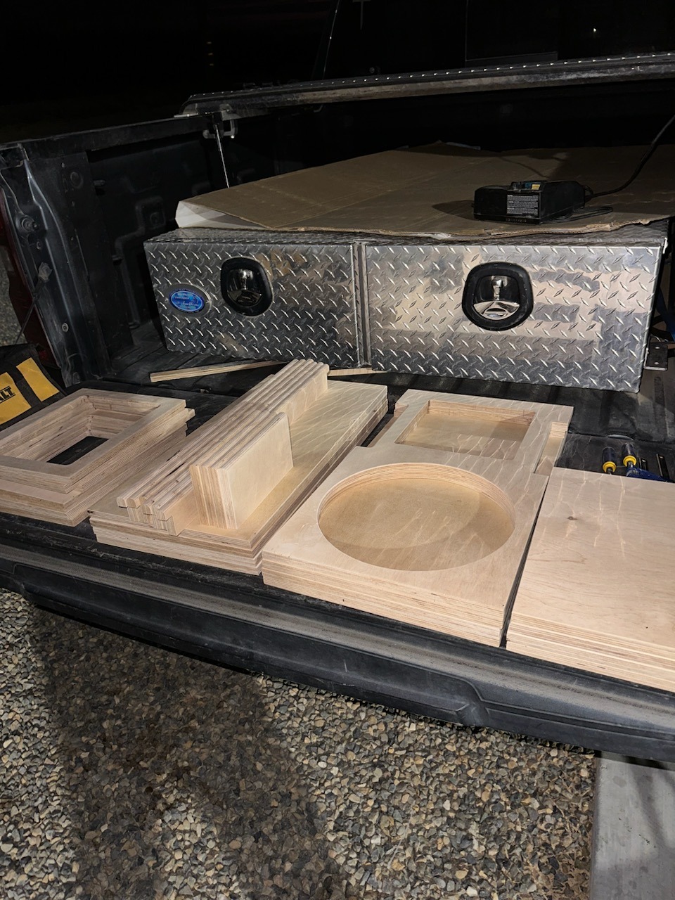

1. It may not be noticeable but I guess the idea was to keep the enclosure volume as close the B&C recommended volume as that is the volume I sized the vents for.

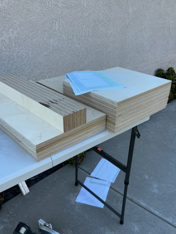

2. They are to heavy. Started on a more compact 15mm version last night. Should be a much easier build. I am going to have to live with these things for a long time and I really want to get it right. Weight is incredibly important to me.

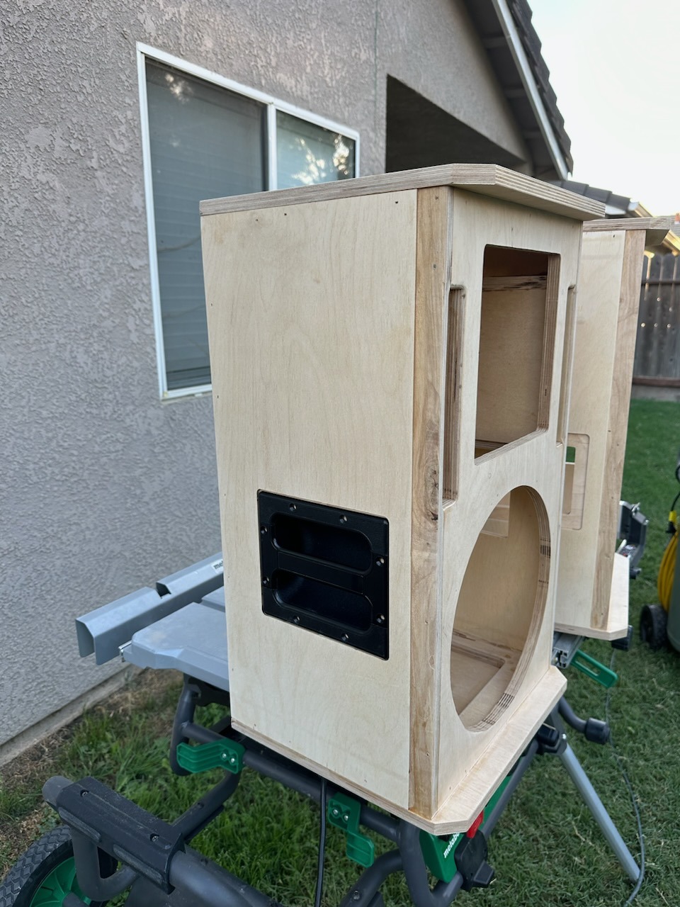

So I ordered the horns from France. They were cheaper and delivered in like 3 days. Panels are cut and ready to assemble tomorrow.

Looks like you're building something I've done. 2x Faital 10FH520, 1x 18Sound ND1460 on an RCF HF94:
Mine are rear-ported, as I wanted to minimise the frontal area. I arranged 4x 3" dia ports for convection cooling of the drivers. With all ports open, they get down to about 75Hz. Blocking two off gets me 60Hz, and blocking three gets me to the mid-40s, albeit with limitations on LF output (excursion and port velocity).
The TMM format maintains vertical directivity control for an octave below what the horn can manage, which results in them having quite a lot of "throw" if you get them up high.
Each box will keep up with 4x 15" ported subwoofers quite easily, and that's for live rock 'n' roll. If you're working with DJs doing EDM shows, you could add considerably more subwoofers. Here they are with 2x 15" subs per side:

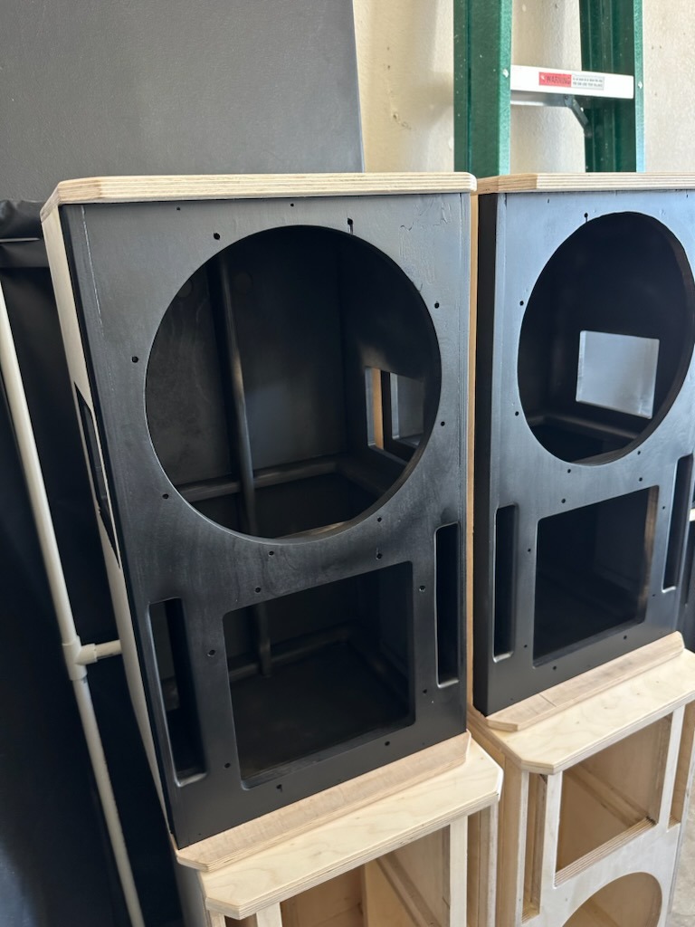

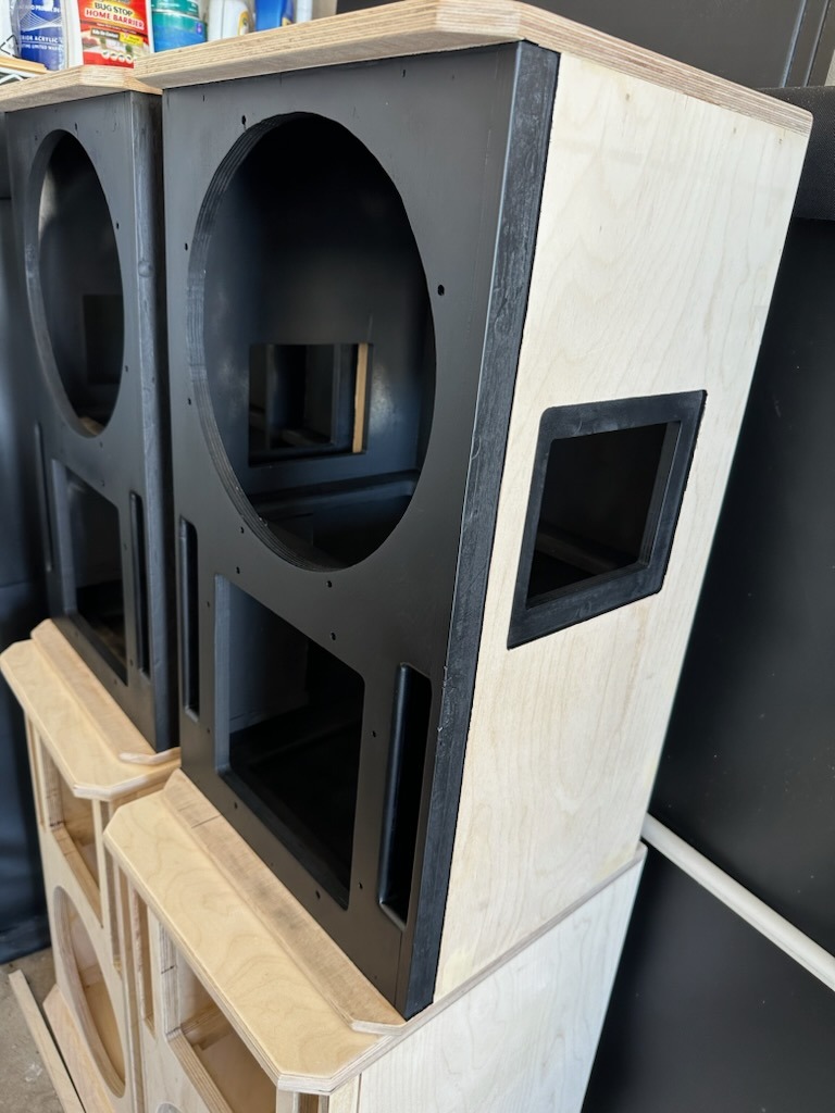

That looks like a very nicely done system. 3 tries later I feel like I am finally have something that meets my goals. Hoping to coat with durtex this week. With the drivers installed they weigh in at 41 lbs. Definitely not perfect fit/finish but they are solid and I am confident they are leak free. If they perform well I intend to have a new set of panels cut with a cnc machine.
