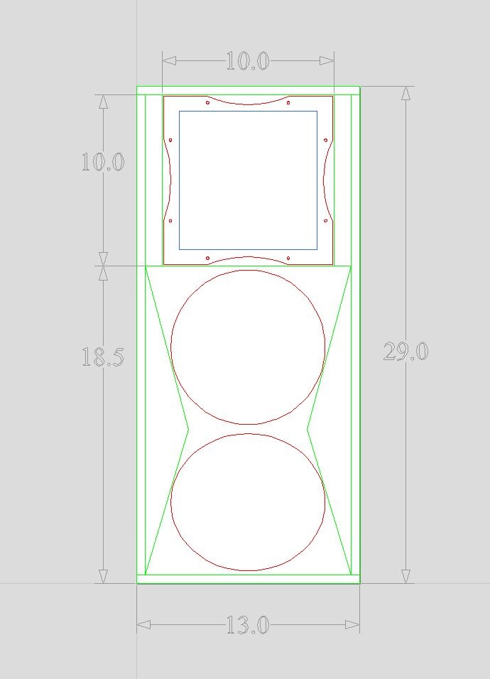

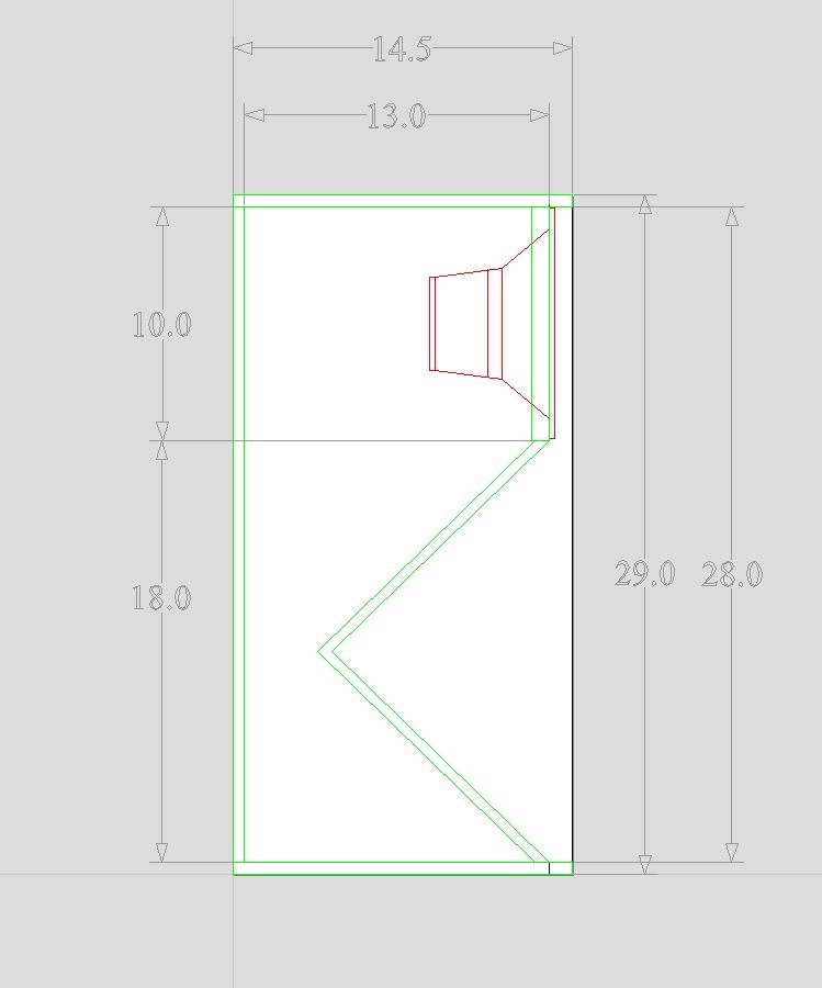

I don’t consider the crossover design to be the barrier here. Sure, it’s a hurdle you have to cross. Either with a passive XO or bi-amped you are going to spend the same time an effort out in the back yard with a measurement mic and a DSP unit, and sitting in front of your favorite simulator. I don’t mind sitting at the bench winding inductors when each one saves $20-50. A passive XO option is nice to have - even if the primary application is bi-amped.
Figuring out which configuration is going to fit in the 40 pound requirement is the biggie. IME, 8’s just won’t cut it below 400 Hz unless SPL requirements are modest. There is just a lot of power in the two octaves between 100 and 400. 8’s just don’t have big enough coils to deal with the thermals or big enough spiders to handle the excursions. The question is whether two 10’s or a single PRIMO 12” is the way to go. Can a good double 10 get under 40 pounds? Maybe start by making a couple of mock-up cabinets for the two configs and see how much they end up weighing. Then you can figure your weight budget. With $2k to spend the cost budget is there - drivers like a 12NBX100 are no issue, with just as much to spend on the HF. I’d hate to see the retail on a cabinet that uses one of those.
I get 80% of the way there output wise with a sub-200 ferrite 12” and B&C 1.4’s I got on close out, but they are a bit over 50 pounds. If money is an object you live with weight. It’s the same when building a house - you either tote 80 pound bags of concrete and 20 foot 2x10’s or pay someone else a LOT to do it.

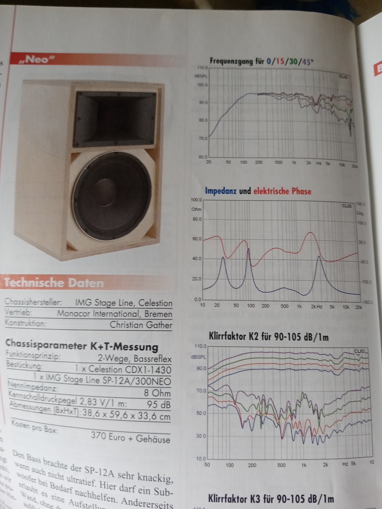

Monacor had a brochure with PA designs but could not find it any more. Its years ago I had one in paper form at home.
I am sure there are lots of other free available designs - so no necessity to buy a DIY audio loudspeaker magazine.

I think I may have found a way to do this using dual B&C 12NDL88's. They are super light and very efficient. I did a quick sketch up to get started. I am not fluent in any 3d software but this should give you an idea. There is room for a 1"x10" port on either side of the HF94. Still need to dive into whether or not having the two 12's angle towards each other will work or not. Hoping it will, if I keep the crossover to the compression driver low enough.
I should be able to get 125db quite comfortably at around 900 watts rms without pushing xmax limits at all. Will definitely be pushing the 40lb mark. Maybe closer to 45 but still doable and fairly compact.
Box Volume 35l
Tuned to 65Hz
(2) 1" x 10" ports

If you use the plan of a serious design, you can not change anything. A rule often broken, with the expected negative results. So better take it as is or leave it.
Maybe read a little about comb filtering and why you should never place two mid-woofer like you show on that sketch. The sound from the horn will have a different distance to the listener than that of the lower mid-woofer. Messing up the response. Some frequncy are erased, other increased. Makes no sense to buy expensive linear chassis and then beat that linearity to pieces. On the other hand, in your case maybe no one will care and as we say in German: A man's will is his heaven.

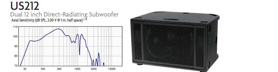

It could work, but the response above 600Hz will be ugly, you would want to use a HF horn that could be crossed lower than the RCF 94.Still need to dive into whether or not having the two 12's angle towards each other will work or not.
The Fulcrum Acoustics US212 will give you an idea what the short "V" horn does to the upper response of two relatively flat 12" woofers:
Considering your desire to use a passive crossover, I wouldn't advise using a "V" loading.
Using 2x12" front loaded really requires a 2.5 way crossover (rolling off the lower woofer to avoid comb filter problems in the crossover region) to get decent upper mid sound. That makes for a more complicated crossover.
Using a single 14" B&C 14NDL88 would get you ~125dB while still within Xmax, save about 10 pounds of driver weight over 2x12", and simplify both cabinet construction and the crossover.
