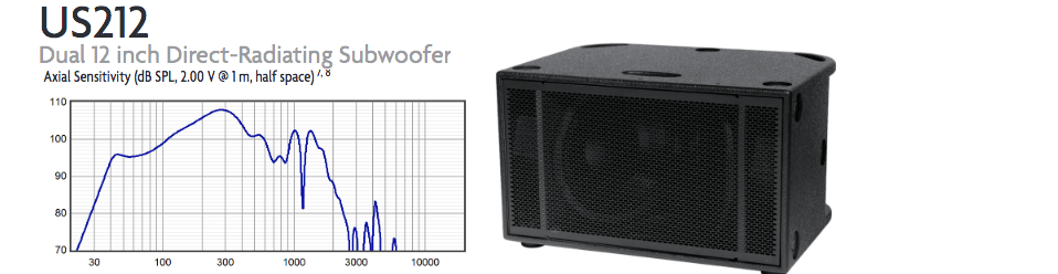

The Fulcrum Acoustics US212 will give you an idea what the short "V" horn does to the upper response of two relatively flat 12" woofers:
Considering your desire to use a passive crossover, I wouldn't advise using a "V" loading.
Using 2x12" front loaded really requires a 2.5 way crossover (rolling off the lower woofer to avoid comb filter problems in the crossover region) to get decent upper mid sound. That makes for a more complicated crossover.

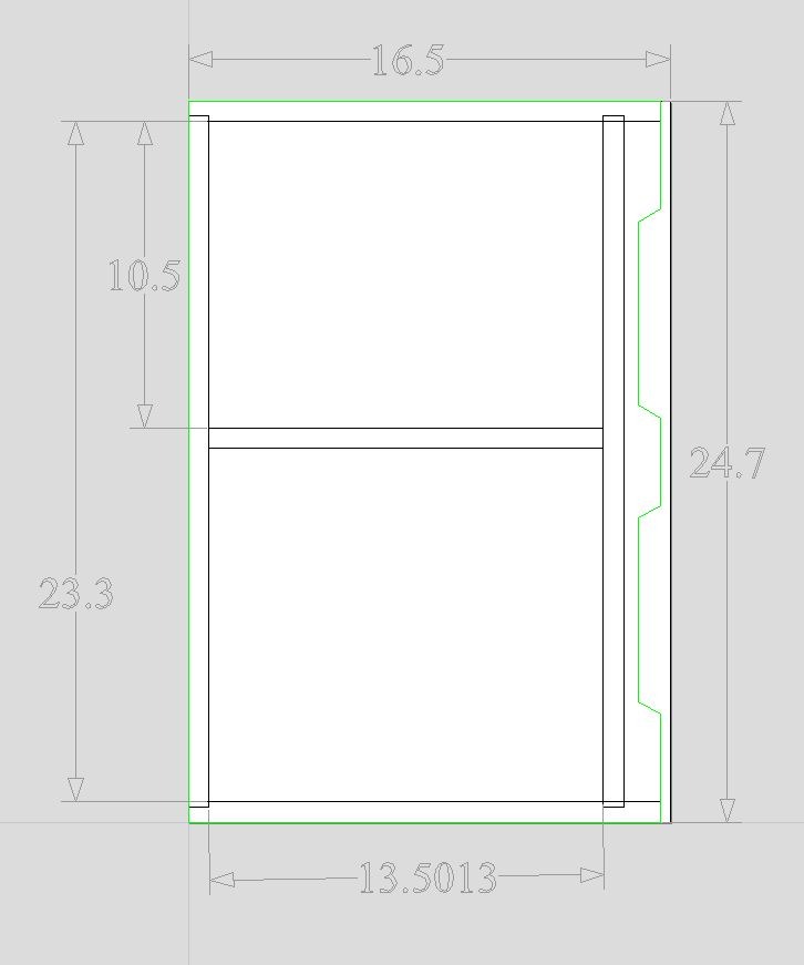

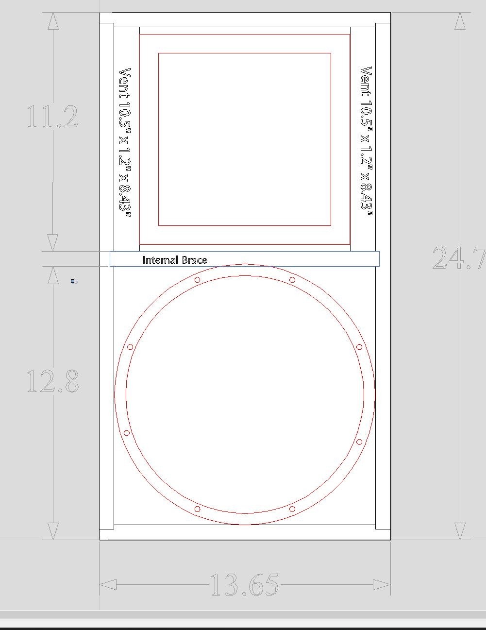

Okay here is what I ended up with. Weight should be right 37Lb using 18mm BB for plywood. I basically ended up using the B&C's recommended box volume and tuning parameters. Cost should be under $1,500. Outer dimensions are pretty much 24.5T x 13.5W x 16.1D.
If I am careful, I can get two cabinets out of one 4x8 sheet of plywood. I am lucky enough to have a local supplier that carries 4x8's. Should be a fun weekend.

Basically, everything needs stiffening ribs. The braces don’t need to be solid all the way across. I’ll ususlly put one in behind the driver - with a half-moon cutout. Can put vertical strips along the side walls between it and the top and bottom. Double-thick the front baffle if you can since stiffening it is harder.
