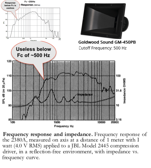

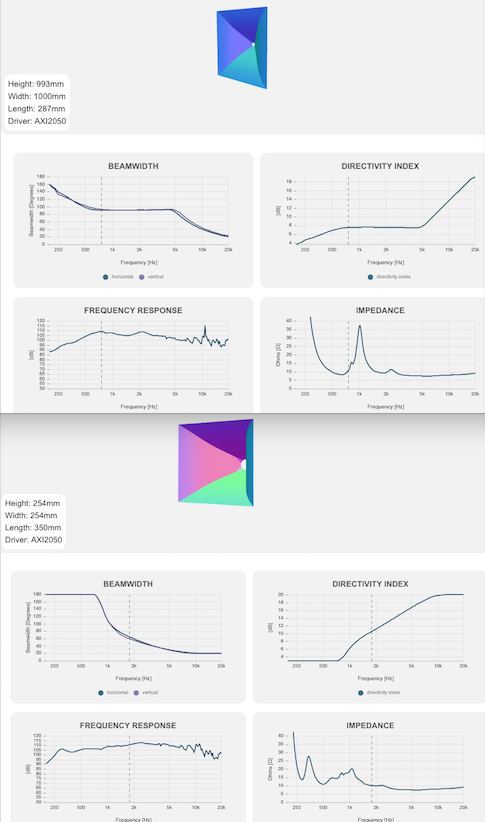

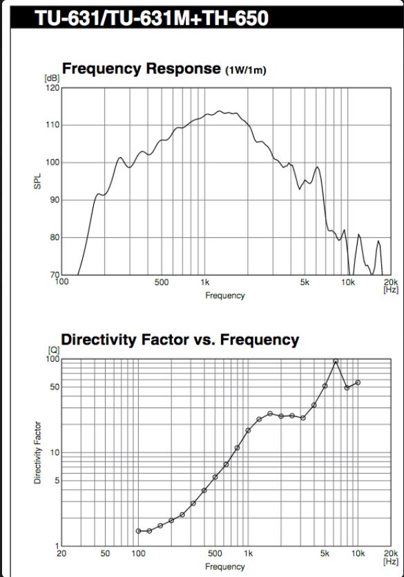

maybe a round and angled piezo array down to 1.8khz, like with this one would be lightweight enough and help the dispersion of highs and mids.
