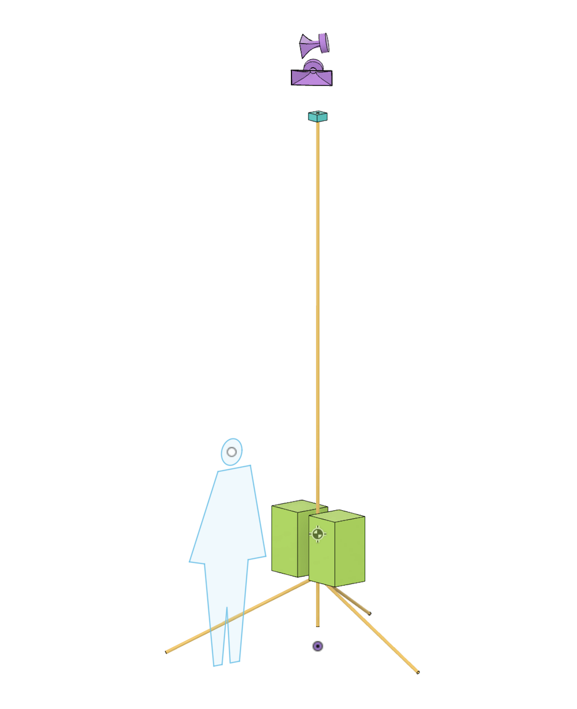

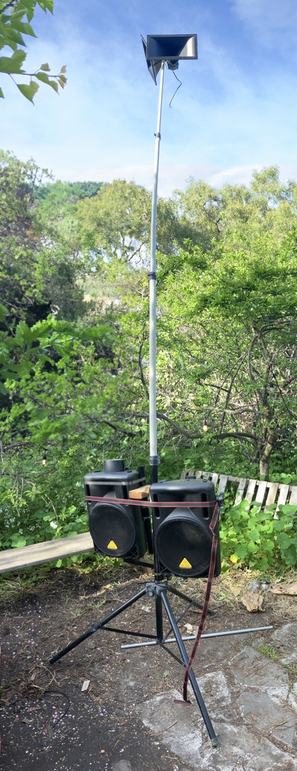

DIY Lightweight 5-meter tall Delay Tower PA System
The pole deflects under load but shows no signs of instability, cracking, or uncontrolled oscillation.
Carbon fiber is fine, until it isn't. It doesn't undergo plastic deformation under load before failure like metals experience. CF might be OK for a horn.
Using only half the original 24′ carbon pole, the system benefits from a significantly higher load margin — likely 3–5× the nominal safety factor, since we're working within the thickest and strongest sections of the pole. The moment arm is shorter, and the flexural stiffness higher, reducing the risk of dynamic failure.
Likely 3-5 times isn't a statement you are capable of defending if you ever end up in court.

I’m hoping to generate a lighter-weight horn design with comparable or slightly better frequency performance than the Goldwood GM-450PB, ...
My takeaways are to pay more for a better driver, one designed for midrange with a bigger coil, such as the B&C DCM420. Also to consider a folded horn, or perhaps a longer one
I think you should accept advice from weltersys and buy TOA TU651/TH660 combos - they are better performer than yours JBL D250-X/Goldwood GM-450PB, with much more low frequency extension.
I am not aware of any commercial folded horns for B&C DCM 420, BMS 4592, BMS 4594, or available data for folded horn DIY printing.

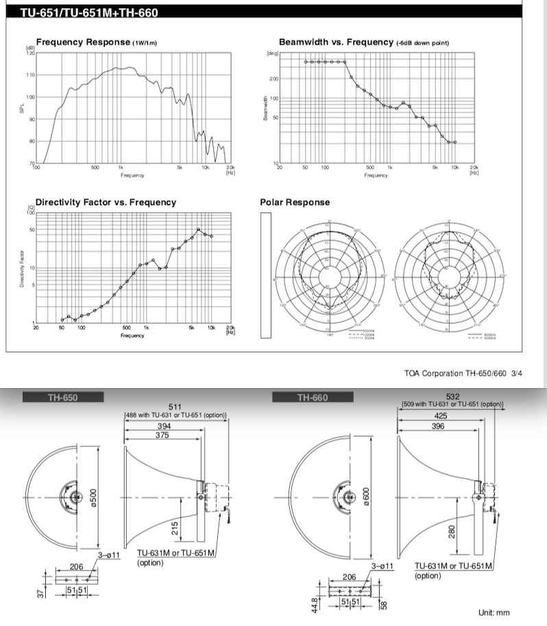

Is The TOA TU-651a good choice, even on the Goldwood GM-450PB smaller horns? the driver is affordable, and goes down to 150hz, and I wonder if they even bothered to test the Goldwood GM-450PB that low.
Yes, TU-651 is a good choice, but it can't go down to 150 Hz - absolute minimum is 250 Hz with a steep high-pass filter (3rd order) on a TOA TH660 horn. On a GM-450PB horn it will not go down that low, because of much smaller horn mouth and length.
Interesting! Can I ask how that was determined?
The data sheet for the driver says
“Frequency Response: 150 Hz – 6 kHz”
And the frequency response graph seems to be 90dB at 200hz with the toa th-650 horn
Graph source:
At 250 hz, the horn and driver combo will do about 102 dB, which is already down more than 10dB from it's peak output level. This will sound about half as loud, more or less. Around 175 hz, it's going to be about half as loud as it would be at 250 hz, about 92dB or so according to the chart.
