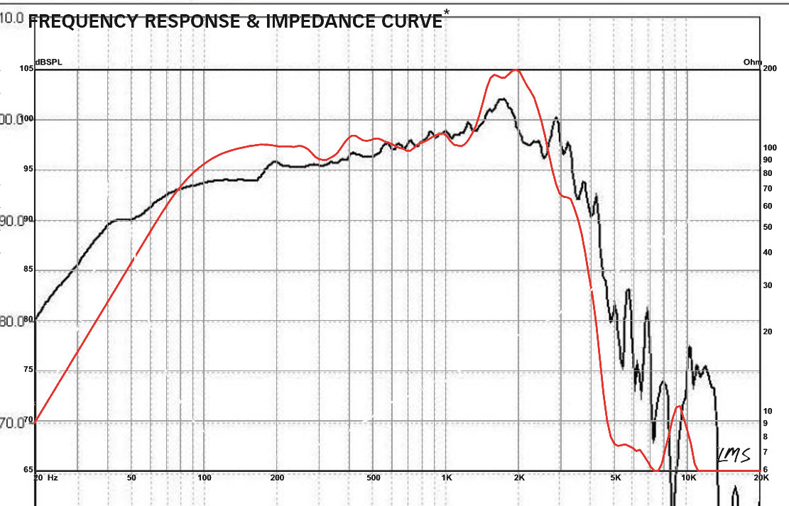

I did a lot of research and after dropping the idea of aiming at something like the JBL M2 but now I am back at it.
Here is what want to build:
A two way speaker EQed and crossed over digitally/active with a minidsp hd.
Eminence Kappa 15LFA. In the attached image you can see that the response is quite close to the JBL M2 woofer. The JBL has a slightly more extended response in the top and bottom frequencies. The eminence is the red line.
Faital Pro HF10AK. The faital is more sensitive and has greater extension up top. The low end is hard to compare since the M2 measurement has the high pass passive filter in place. The faital is the light blue line.
I read the M2 uses a 6th order crossover which is 36db/octave if i am correct.
My question is this: Would the Faital driver be happy with a crossover that low (800 or 900HZ)? Advised is 1300Hz with 12db/octave crossover. So would 800 with 36db/octave work?

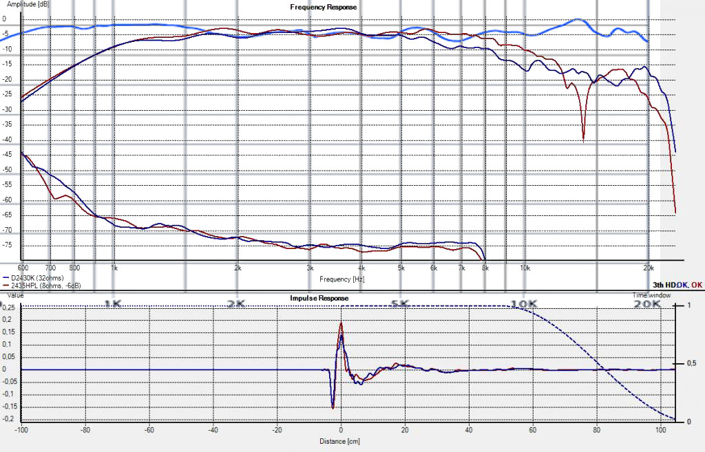

The measurements shown are quite close to the ones I did on my JBL D2 and my Faital HF10AK (on an Eighteensound XT1086).
How well the HF10AK would fare on a Karlson pipe with a x-over frequency of 800 Hz I can't say. They don't give a rating for lower crossover frequencies like the do for some of their larger drivers. I will use mine crossed at 1300 Hz from an 10".
Just keep in mind that the D2 is a driver originally developped for rough handling in PA situations. It can take 200 Watts continuously !
What works well crossed at 800 Hz are some 1.4" drivers with the proper horn/waveguide. Faital HF144 and HF 146 should be very nice (perosnally I have only used the HF146). They don't extend as high as a HF10AK but they go still high enough for my taste (but I am over 50 so maybe I don't count in this respect).
