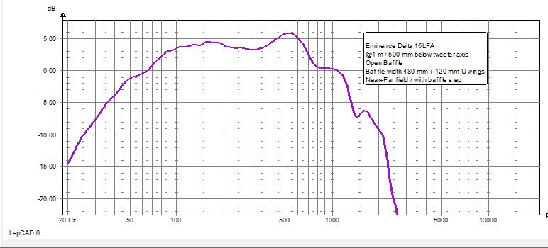

After finishing my Fostex fe206n Karlsonator I am thinking about going two way for my second build. My technical knowledge is limited so I will need some help and opinions from more experienced builders to prevent me from building a Frankenstein.....
I want something vaguely resembling the JBL M2 Master Reference Monitor. After some research I have two initial drivers I like but I doubt is they overlap enought to be used in a two way system.
For the bass I was thinking about the Eminence Delta 15Lfa.
For the compression driver I like the B&C DE250-8 1" Polyimide Horn Driver.
Crossover point should be somewhere around 900hz. Is that at all possible?
As a comlete noob this might be a stupid question, but the response graphs of both drivers look to me as if they already cross over quite naturally (when i look at the response graph of the large vented enclosure recommended by Eminence). Could I get away with just a sharp low pass on the tweeter for protection purposes and run the Eminence without limitation?
Also, the compression driver seems to drop of sharply above roughly 16khz. Is it possible for an L-pad to tone down the tweeter below that frequency only and leave the response above 15 or 16k as is?

Drivers choosen are more for an "econowave" than for an M2 type of...🙄
The Delta 15LF is not a good choice for a 2-way speaker. The LF stands for Low Frequency, it's a pure bass or sub driver. The B&C DE250 can't be crossed over that low either (B&C says 1,6kHz, I wouldn't a xo of lower as 1,2kHz even in a hifi setup), you'd need a lot bigger compression driver for that, probably 1,4" exit.

I used Sonido SCW300 and Eminence Deltalite II 2512 with DE250 in JBL PT waveguide and with 18sound XT1086 waveguide - xover at 1600Hz.
Eminence Deltalite II 2515, Acoustic Elegance TD15M, or Beyma SM115/N can work good with DE250 but you need very large horn/waveguide. Mine OSWG with lipover was about 50cm in diameter and it could be xovered acoustically at 900Hz easily. One must differentiate electrical xover from acoustical - in B&C datasheet electrical xover is mentioned. WG my friend made was based heavily on Gedlee's Summa WG with big lipover added.

Take a look at the AE td15s,x or h woofers for f3 mid 20s in room. And surf around for Faital 1.4" drivers and either the FAital tractrix horn or Eighteen sound 1.4" horn. Cross at 700hz for decent off access.
A bit pricy but it covers many bases. mid 20s to mid 10Ks at 94 db with good off access and high output. Hard to beat

15"+horn 2 way is a classic design and has too many variations. The things that makes M2 standout from the rest are digital crossover, dual diaphragm driver and a huge and ugly waveguide.
