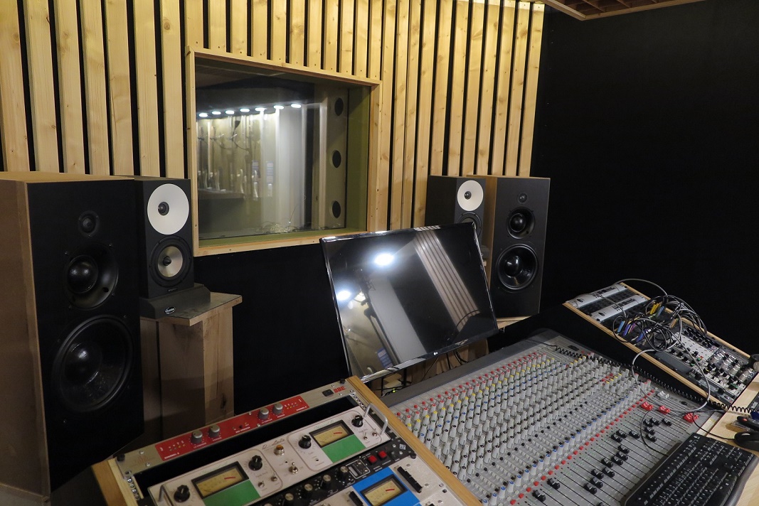

ive done some ATC/Quested 3 way Studio monitors and they are impressive! activated by Hypex fusion amp 253. Got the Drivers from A.O.S (Volt, scan speak).

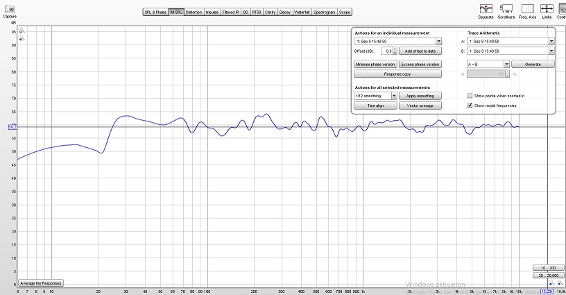

the SPL is +/- 4db measured in listening position (2 meters)

Amphion! 🙂
What is the green outboard above 1176?
spendormania, I read the German forum about your Kii clone (Google translated). What a journey. Congrats.
Plasnu: i will play at "guess what the greeny is".
My answer:[Silent:arts]'s Dla-2a electrisizer's own implementation.
Harder is the 1u rack between the greeny and revA... i guess it is a... IJR Mixbuzz1!
What did i won? 😀
More seriously both are (very) nice compressors. Dual la2a and a Ssl4000e/g mixbus comp variation.
