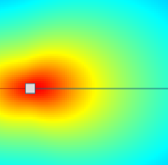

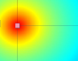

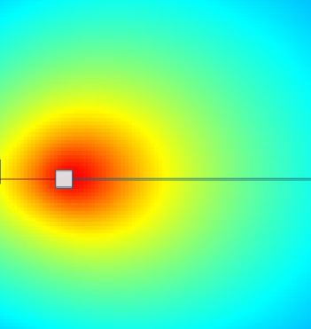

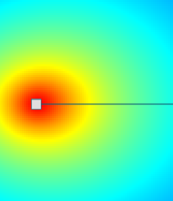

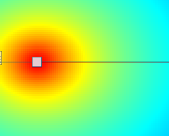

Here are some simulations from Ease focus 3, basically putting same speaker 3 times in nearly the same spot. So its hypotetical, and what's called broadband in the software. Using specific freqency bands give very different results.
The first image is 3 drivers forward.
Second one left, one front, one right.
Third 2 front, one back
Fourth, 2 front one back with reverse polarity
Last 2 front one back with reverse polarity and 1 ms delay
In this simualtion of some random, speaker, the 1 forward and 2 to the sides gives really nice omni pattern. Best with 3 drivers for cardiod is here to have one of three pointing back inverse polarity and delayed a bit. (1 ms here). Looks to that this is 100% frequency dependent though.
