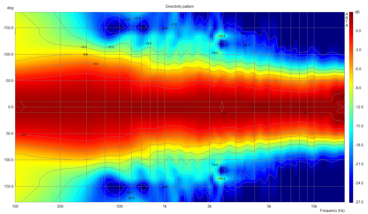

Jag768 are this plot from the waveguide design you show in your other thread?

20" x 16" 3-way Synergy horn measurement data shows good directivity down to 200Hz with simple DSP or passive Xover.
