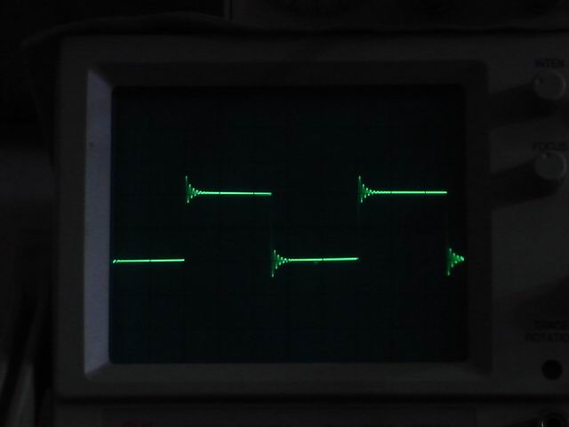

Placing 20kohms resistors from collector T8 & T9 to the ground improves stability, placing 27N over R31 makes it even more stable. This modification does not effect the output results what so ever. C8 & C9 really need to be placed on the PCB, placing only the power supply capacitors is not enough without these capacitors placed, the results are poor and some times the thing starts oscillating even with the modifications (as mentioned above) done. Amplifier seems to work flawlessly now. If every thing is assembled in to its case I will do some testing.
3 things to change to get it work(stopping it from oscillating and instability):
- Add a 27N capacitor in parallel with R31.
- Add Resistor from T8 collector to the ground/earth.
- Add Resistor from T9 collector to the ground/earth.
You can place these components on the backside of the PCB, The other components are original from the schematic drawings.
Besure to use some good caps for C11 & C12, some low ESR types will definitely improve performance.
It works for al twelve I made, they run great now.

Hmm...
I have some serious doubts...
You could show us a picture of the leading edge from a
10V 10 or 15 Khz square. In a resistive load for pic 1.
With a resistive load and 2uF parallel for pic 2.
I think by loading the CFP driver stage with the resistors to
ground, you would like some extra current coming of the
diff pair which is fed by the CCS.
This, at least, will be true for higher frequencys. As you
know at a higher frequency the prveious stage gets loaded quit
a bit more. Lower impedance due to 1 / (omega*C), where
omega equals 2*pi*f.
I would like to ask for proper testing of a single channel, before
changing all the other channels.
For instance, when you do the reactive load test, use bursts. Not
a contiuous signal.
There is more, but nuff said...

ok i did some stability tests keep in mind that i have some cheap caps used to test the module, soon i will place low ESR types on the boards. It does not have a proper casing, cables are 0,75mm2. The resistor load is free from induction.
The images with two lines, the upper line is the output the lower line is the input (it has a slight bend because of the capacitive load from the input of the amplifier)
All images are clickable.
This is the output if you don't have assembled C11 & C12 assembled. 20khz 10vpp 4ohm speaker load.
This is the output with the caps C11 & C12 assembled. 20khz 10vpp 4ohm speaker load.
This is the output with a capacitive load of 1,2uf. 20khz 10vpp
This is the output with a resistor load of 1 ohm. 20khz 10vpp. It draws almost 150Watt from the mains.
This is the output with a resistor load of 4 ohm. 20khz 10vpp.
This is the output with a resistor load of 4 ohm and a 1,2uf capacitive load in serie. 20khz 10vpp.
This is the output with a resistor load of 4 ohm. 30khz 10vpp.

Hmm, practically all scope shots show temporaly oscillation when slewing. Thats likely to sound extreme bright. (only conditionally stable)
You might consider reducing c5, until the amp starts to overshoot.
I would say, that amp is definitely not correctly fb-compensated.

Probe Calibration
To get a better view, it would be nice if you calibrate the probe
of your scope.
Referencing the last picture:
The lower trace shows the input signal. That only resembles a
square. Top of leading edge is rounded off, bottom trailing edge...
The upper trace the shows the output signal. Garbage in...
This way it's to difficult to draw any conclusion.
Looking at the pics, I would say sub-obtimal compensation.
Slewing problems, etc...
In all, I should urge you to look at my previous recommendation.

Okey this is a misunderstanding, I got the probe calibrated on the calibration point, if I put the probe on the rc oscillator it gives a very nice square wave but, if I connect the rc oscillator to the amp, the load thus the amp is misinforming the square wave I guess because of its capacitive load is there any way to improve performance?
