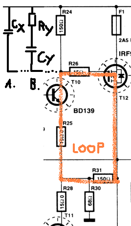

I remember this IRF540 / 9540 HEXFET from Elektor magazine.
The output drivers T10 T11 and output transistors T12 T13
has a voltage gain of 2-3. Gain ~= (150+68)/68
There is a local feedback in this stage using R31 R30 to set this gain.
The problem is you have no capacitance to compensate
and so make this local feedback amplifier stage STABLE.
These HEXFET like most MOSFET are very fast, compared to normal BJT Power transistors.
The usual way, as you mention, to put a cap in parallel with R31
may not work as well in this type of Current, Emitter, Feedback configuration.
The same problem can sometimes happen in Complementary Fold-Back darlington configuration.
In this case we can say we have two CFB in push pull. With some resistors to reduce gain.
When emitter feedback is used ( R31 is providing feedback current to EMITTERS of BD139 BD140 )
you will have to try to break this oscillation loop
using the slow down fiter capacitors in some other place.
What we have to play with is the loop ( I only speak of the upper part now):
R31 - R25 - T10 - R26 - T12 - R31
See my attached part of schematic.
Somewhere where is best place, we have to put a compensation, slow down, capacitance.
See alternative A. in my drawing.
The usual way is to put a cap across R24. Cap Cx.
I would try a cap with value:
1nF ... 22nF
Of course you would put same value cap in the lower half of amplifier
.. cap across R27
The procedure is the following.
1. Begin with the higher value caps, 22nF
2. If amplifier is stable, take the nest lower 50% value = 10nF
3. If still stable take next = 4.7nF
Repeat this until amplfier is no longer stable.
Say it starts oscillate again at 2.2nF.
And is stable at 4.7nF.
Then I would, to have a safety margin, use 6.8nF for these compensation caps.
Don't forget to add same value cap
across BOTH R24 and R27.
The optimal way to compensate is to use alternative B. in my drawing.
Ry can be maybe 2.2 Ohm - 22 Ohm
and the cap Cy same as in alternative A. .. 1nF - 22nF
To determine the optimal values we would use oscilloscope
and adjust for best possible looking squarewave.
If I am sure this will work for your amplifier project?
The truth is ----- I AM NOT SURE.
I have to put in a disclaimer, isn't this what they call it.
But
the method I describe is the way I have seen used
in other same type of amplifier stages.

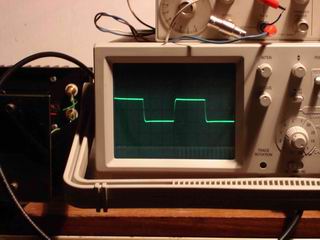

With increasing resistance in the Zobel network,
from originaly 3,4ohms to 11ohms, I got them very stable,
no ringing, no overshoot,.... and very good sound
....without changing gate stoper,...
.....R30 and R31 inductive, or not, it is stable, I was tried...
.... and no extra pole

I will test the amplifier, but the audio generator I use does not produce nice square waves so I first need to calibrate the unit. Why use a capacitive load? most amplifiers wont survive doing that why is this useful to test any way? because the load that will be on is inductive. I will test a resistor load (4ohm) and capacitive/resistor serie load. I did some small testing and all responses look quite good.
I would like to have some powerfilm resistors(non-inductive), to replace the wirewound ones but couldn't find a reseller for this. Any one knows where to get these resistors?
