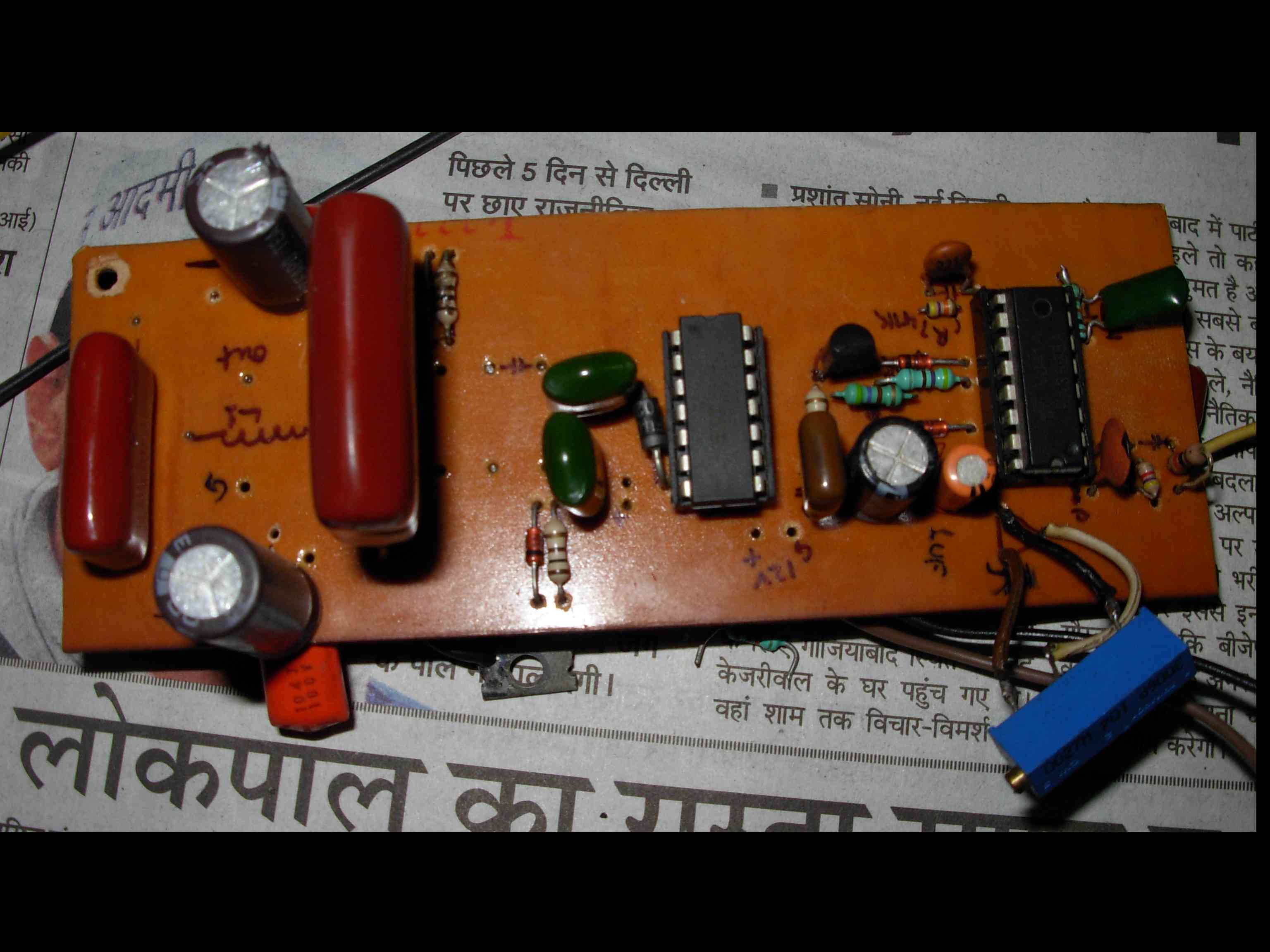

Measure current from power supply of fets with gnd short and post here
Maybe level shifter make problem,and both transistors conduct at same time,shorting psu and making ripple.

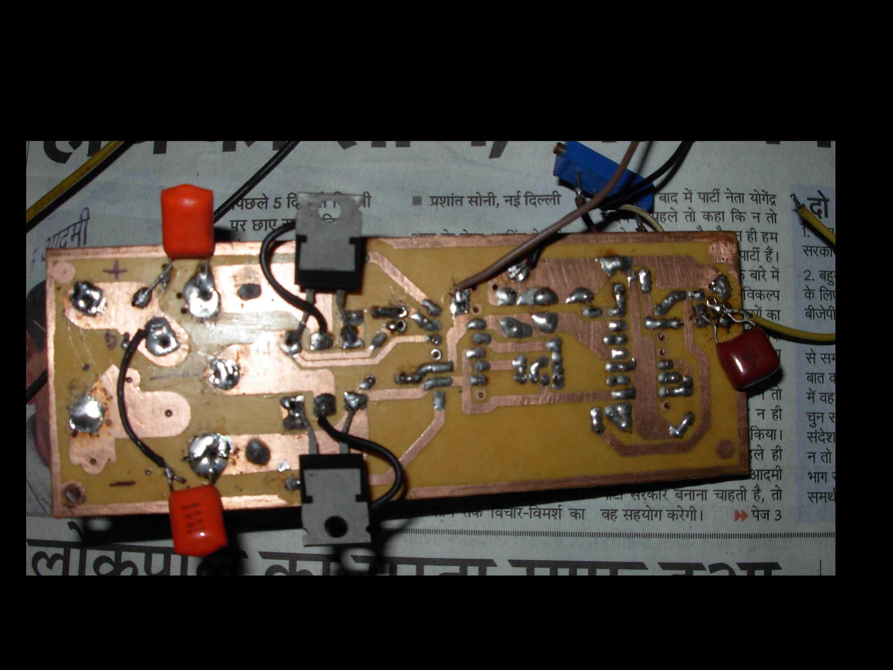

hi acca,
no not 50hz nosw.using 50hz transnsformer 24-0-24 ac as a source ets are irf540n.one side fet get little warn and other remain cool.
ill measure the voltages and post later .
thanks
ravs

Try to filter your psu.
Both fets must have same temp.

using mains transformer not smps 4700uf per rail.sometimes only one side mosfet get warm
Try to source IR2184,I don't know now do ir2110 have internal dead time.In few days I'll try with optocopuler drive,and post here if have success.

Ok.Try to decrease freq. first.
If not help,try to merge inverting input and output of SG internal opamp with input to gnd.
Crackling and 50hz isn't switching noise.
could be emi,i knew a lot of people with this problem or defective or fake chips,but i think it is a bad solder joint by the crackling,very common problem
Fake chips... 😀
My friend have one IR2153 for smps,and set freq to 50khz with R and C according to datasheet,and when measure freq. he have 180kHz 🙂
Yes,maybe have bad solder joint.Try to press PCB and see do it any change.
