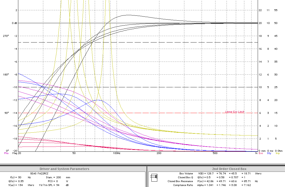

Indeed. One of the few is the SEAS FA22. It is quite good. 50-60 litres or so IIRC.

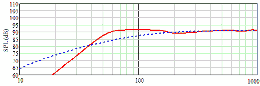

How well the extention works depends a whole lot on the room. F3 of a Pensil will be a smaller number, but Toole has shown that to be meaningless to the human ear/brain. Best look at F6/F10 and think about how much room lift you get in your room (speaker placement factors in as well).

If you want simple, as i said earlier, 50-60 litre sealed box with SEAS FA22. Almost any shape. Choose a shape you like.

Keep in mind that while shape of sealed enclosure of optimal volume would be far less critical to LF extension / tuning - whether for single driver/full range systems, or multi ways - it can still effect external acoustic properties such as baffle step loss and edge diffraction frequencies.

The FA22RCZ could easily go to 40hz about flat in a vented box though. Going to 30hz will not be "humongous" either.
Closed box is easy + good and all. But if you got the potential, why not use it?
Would have to turn it up fairly high before you ran into doppler issues, not crazy loud, but should be adequate for most needs.
