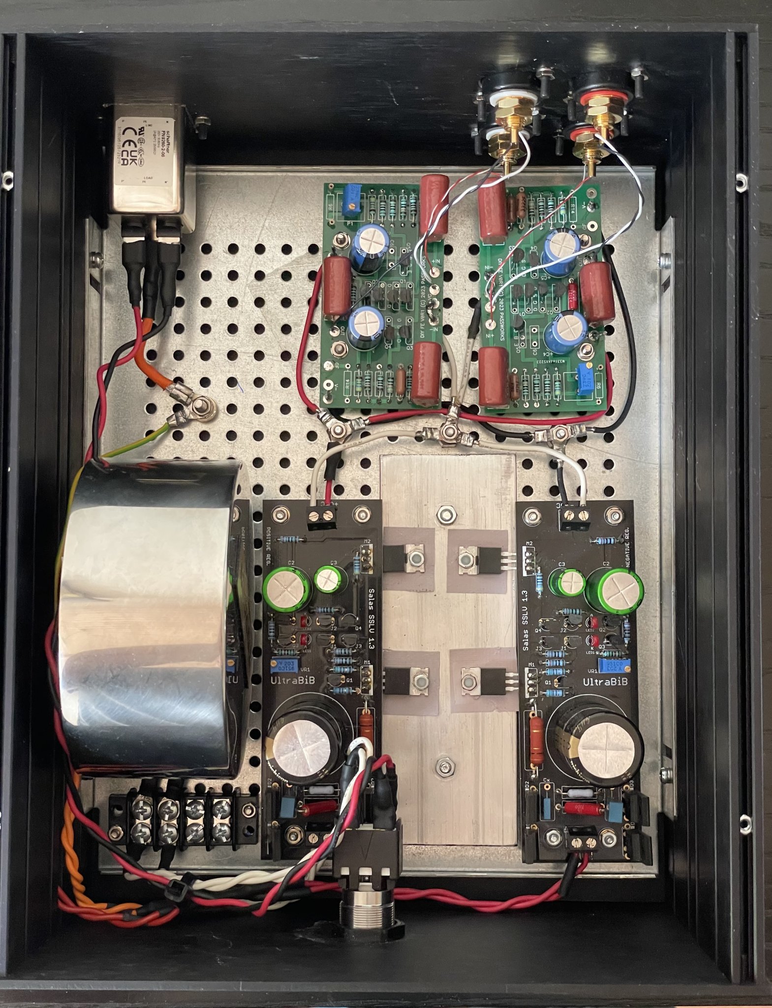

I been listening to FE2022 (V0R1) a few days now an I really like it, perfect performance. Built mostly from older project parts. I’m using it as gain stage between Turtle Iron Pumkin and F4 with 10dB gain, which is more than I need. The pots are fixed at 750 ohm. I had no need to use them so resistors will take their place as soon I get the motivation to open it.

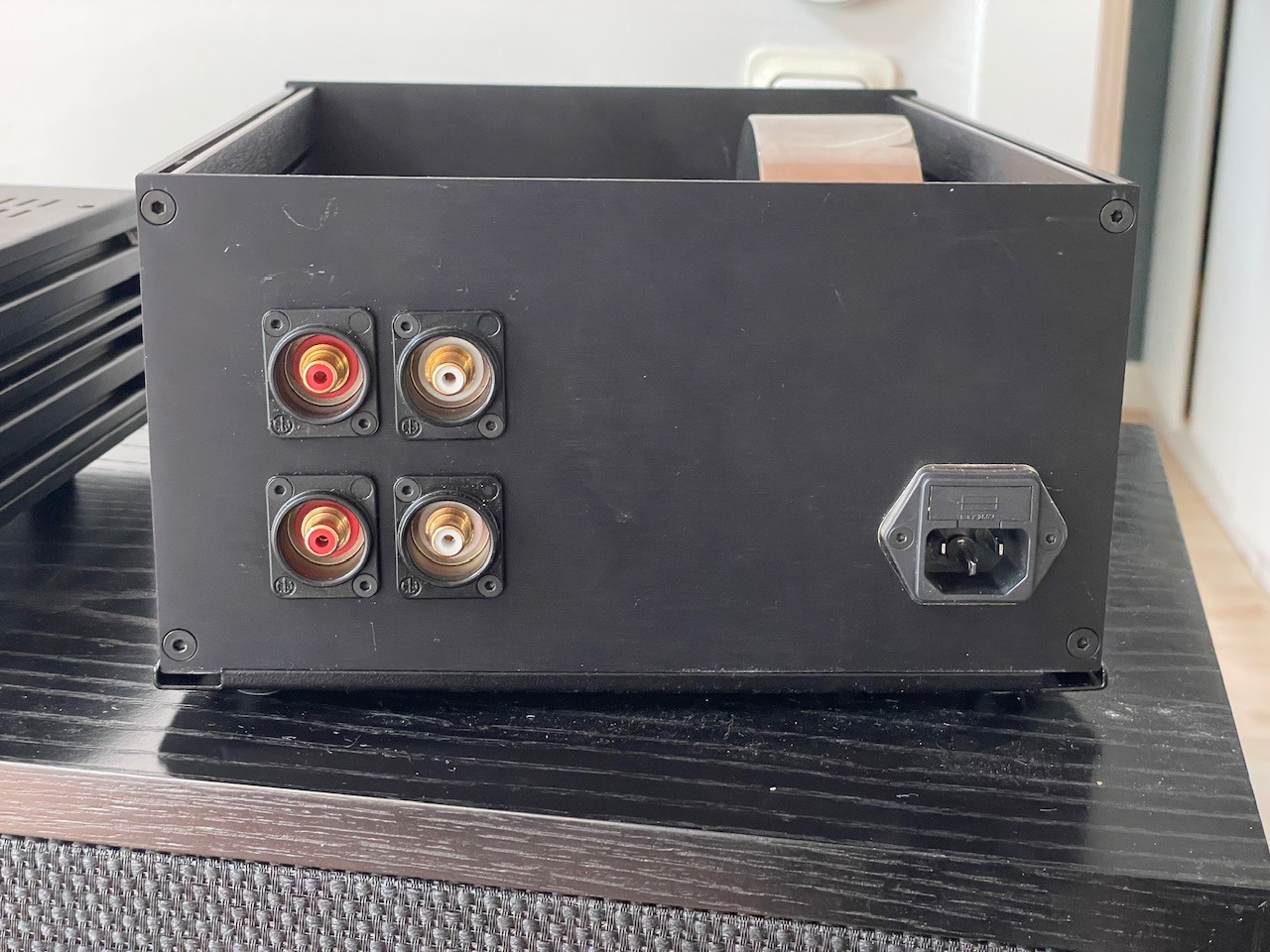

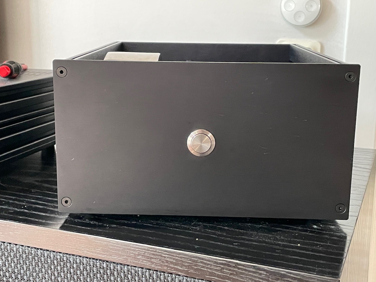

Nice! Some more porn, please. 2U chassis?
What xfmr are you using, and what value resistors did you settle on for the UBIB?
Was thinking of exactly this approach to try the FE2022 as a pre - with one of Lenny’s VCX that I can remove from a project I have on a shelf. Need to catch up on the UBIB GB/availability.

The inside is more interesting than the boring outside, bad porn. The FE is done with j113 from Store kit but it is tempting to open the octet unobtainum I found in my stash. Ultra BiB is set on +/-24. I have used UBiB in several projects. AVC is ZM-Turtle in Iron Pumkin .
edit: 3U chassi to match height of Turtle. UBiB resistors is long forgotten but I can check if you are cu enough.

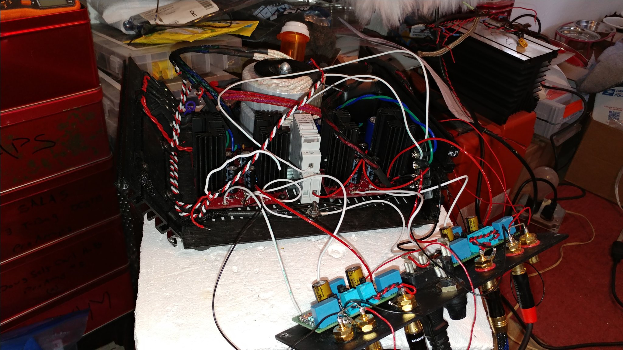

I haven't seen any 48V Dual Mono FE 22 built yet. Over 2 months with only one channel operating and power failures at house level. Rebuilt now 4 times and will not put back together until volume is corrected or just use on other PASS amps. Had to discard the one channel and use up the spare the Store allows Greedy Boyz to buy at a time. It is severly cobbled together to get both channels up.
6L6 stated no problem with loudness on his MOFO's.
It has the highest R3R4 for 10 Gain. It is not enough.
Can I install 150K resistors or is this it? As it stands volume is less then public movie house level.

Installed in series another 100K on R3/R4 one channel. "Improvement" if there is, not enough.install 150K resistors
