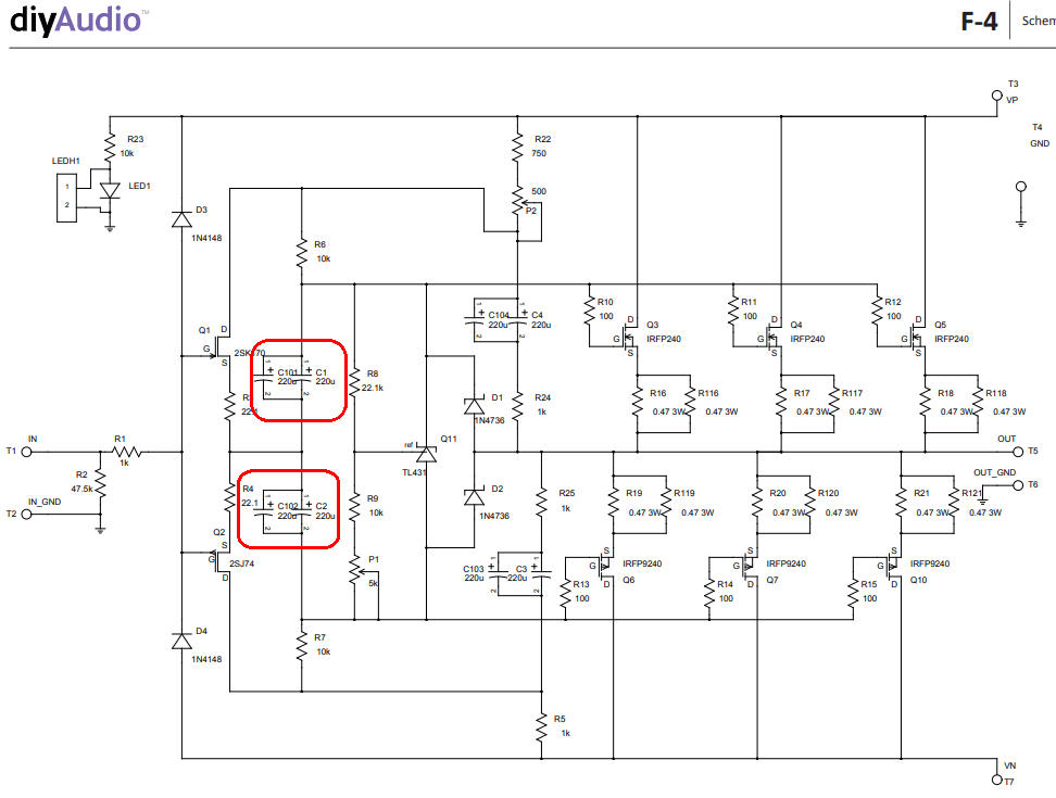

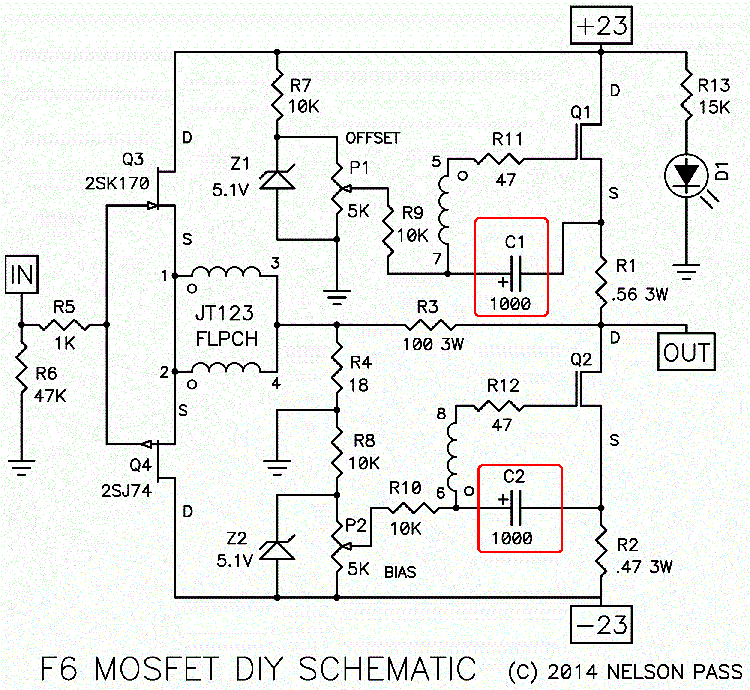

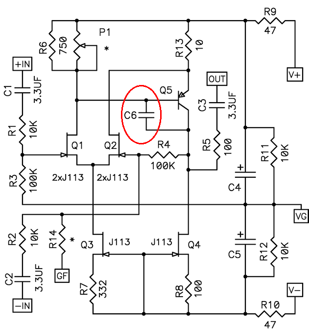

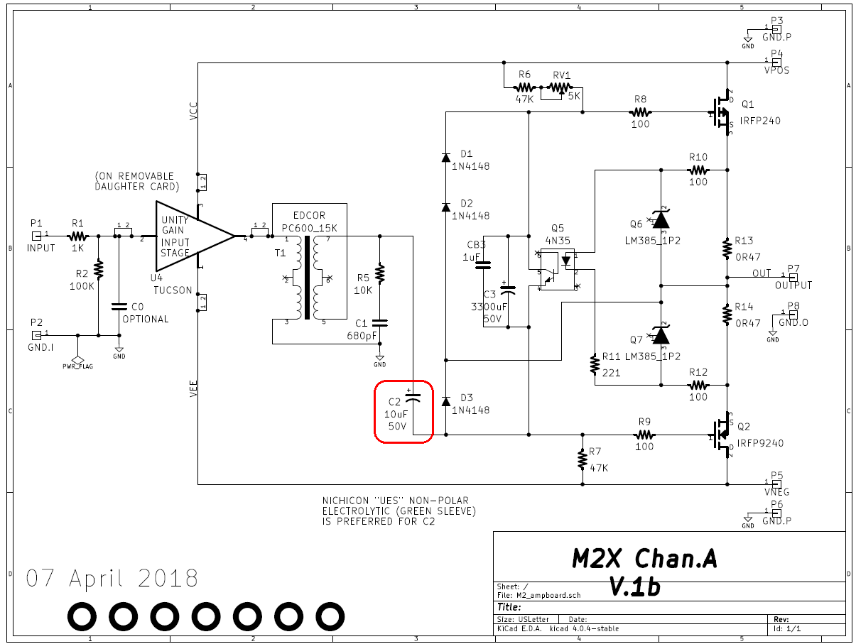

Some people prefer to eliminate one or more AC coupling capacitors from the signal path; dual rail power supplies are one way to implement this.
Keep in mind, though, that the complete amplifier contains a "back end" as well as a "front end", and there are more than one FirstWatt back ends which contain AC coupling capacitors. Even with dual rail power supplies.

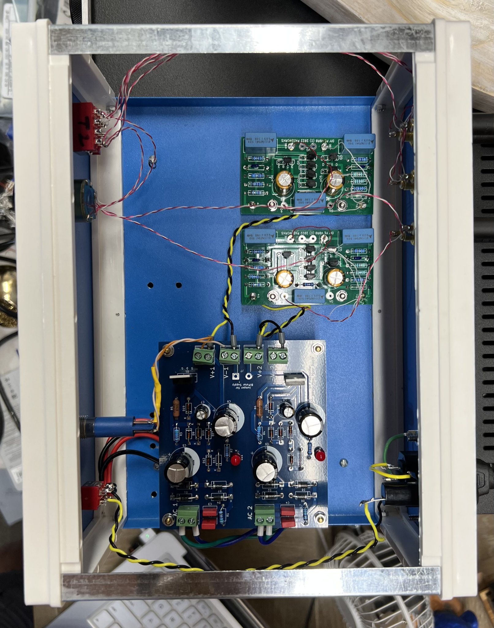

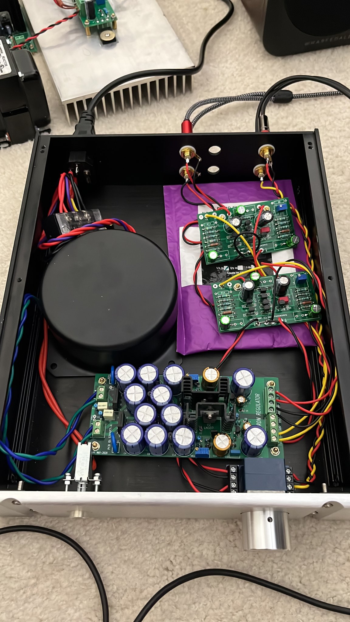

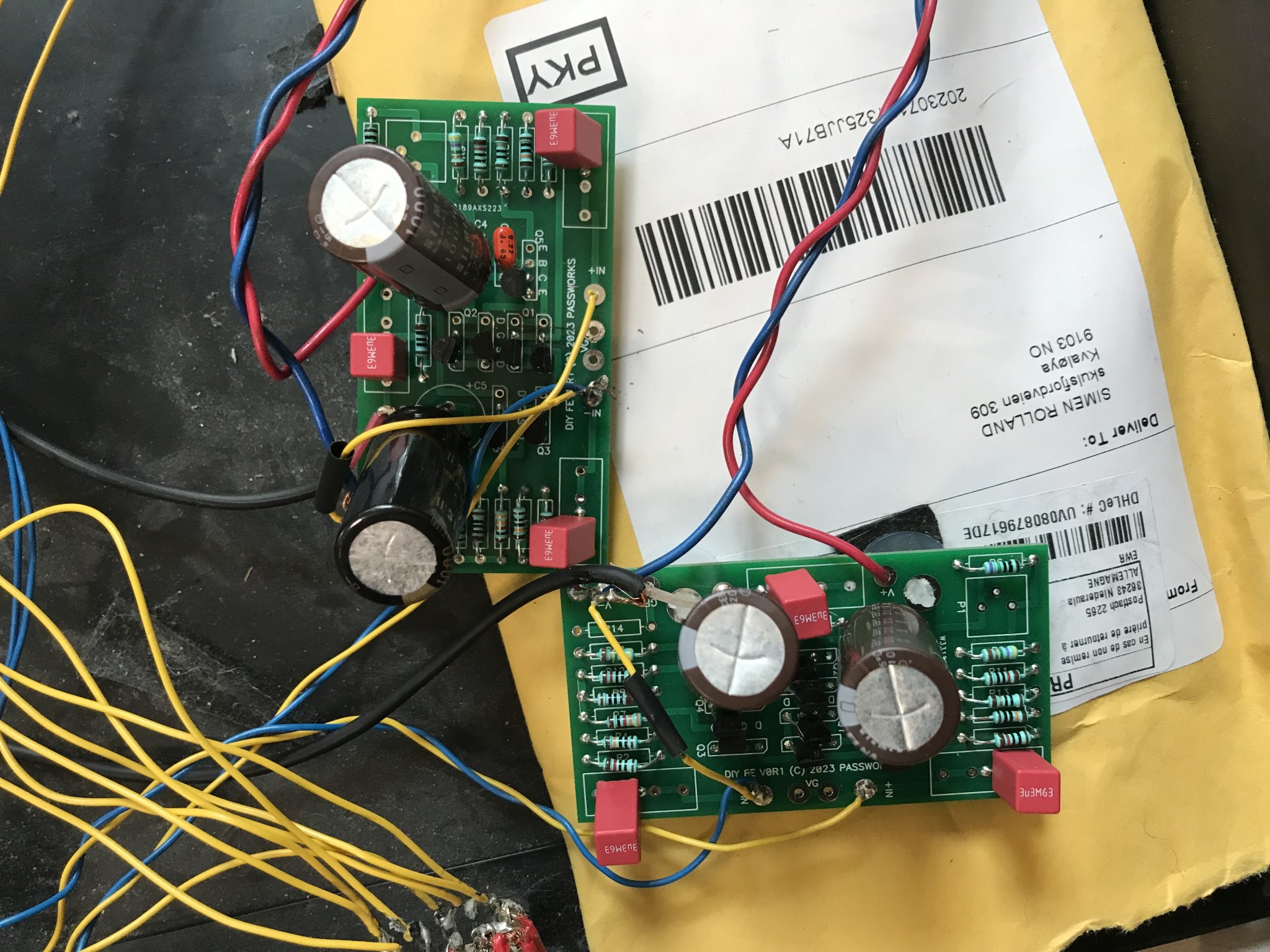

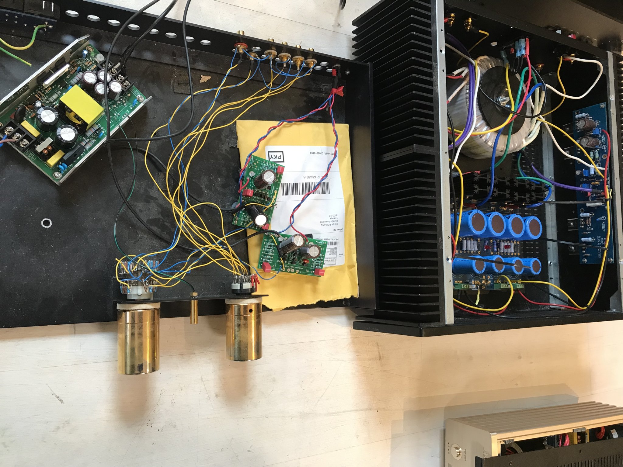

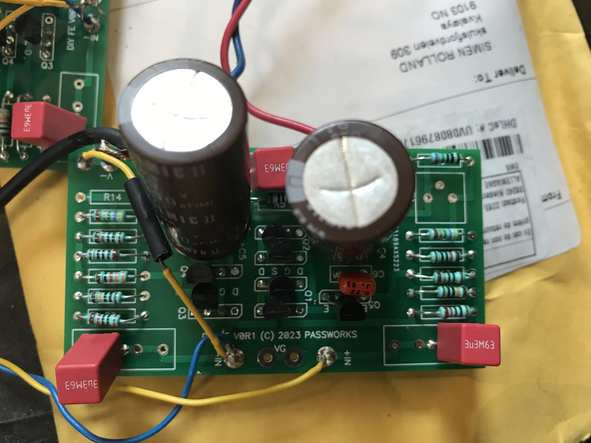

Hi, I've got something wrong, the sound is dark and a lot of bass, very withdrawn and low, uses 42v, is it too low. Or have I connected something wrong
