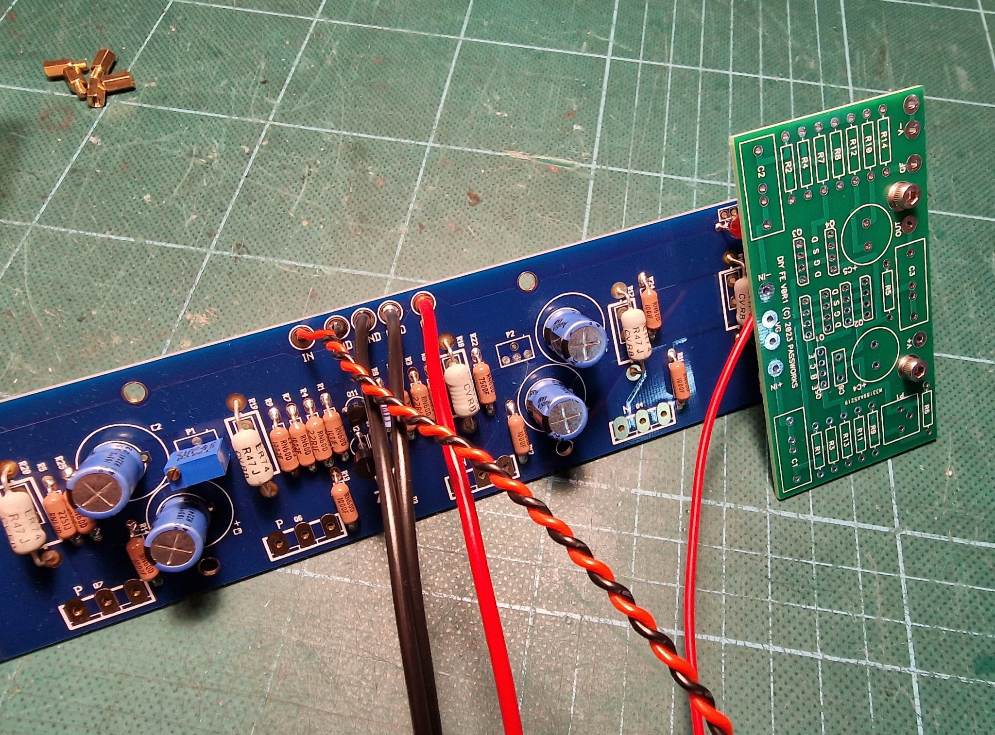

I built something similar to what you are asking about @jpeterson1 but not balanced out. I believe you need another pair of boards
I have all my sources now on a shelf I converted from a closet and had to run 15 foot xlr balanced cables to my preamp/amps.
I have a BBA3 with F4 monoblocks but wanted a simple option for experimenting with other single ended amps.
I built a Front end kit with VRDN, some Wima caps from @poseidonsvoice, a quad alps pot, 2 inputs, 2 outputs, and gain switches to change from 10 db to 20db. I mainly wanted to experiment with the Mofo and the F4s I have but having the 10db switch allows me to try other amps.
It sounds lovely.

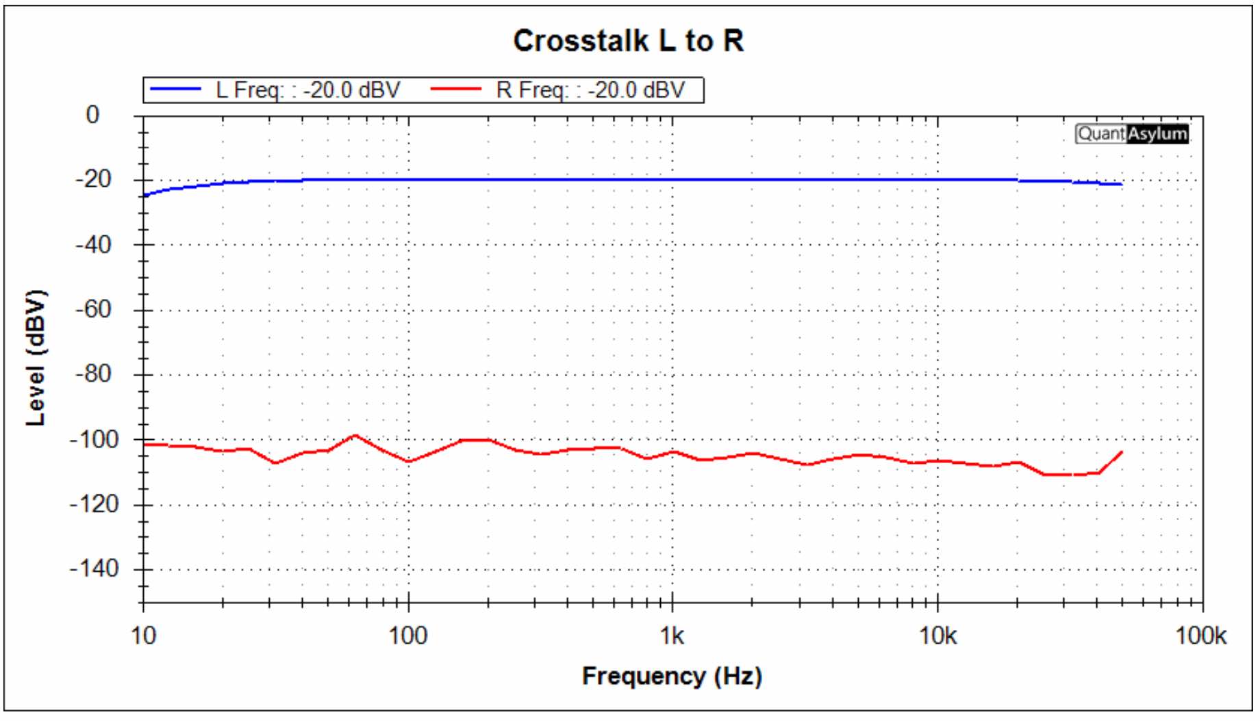

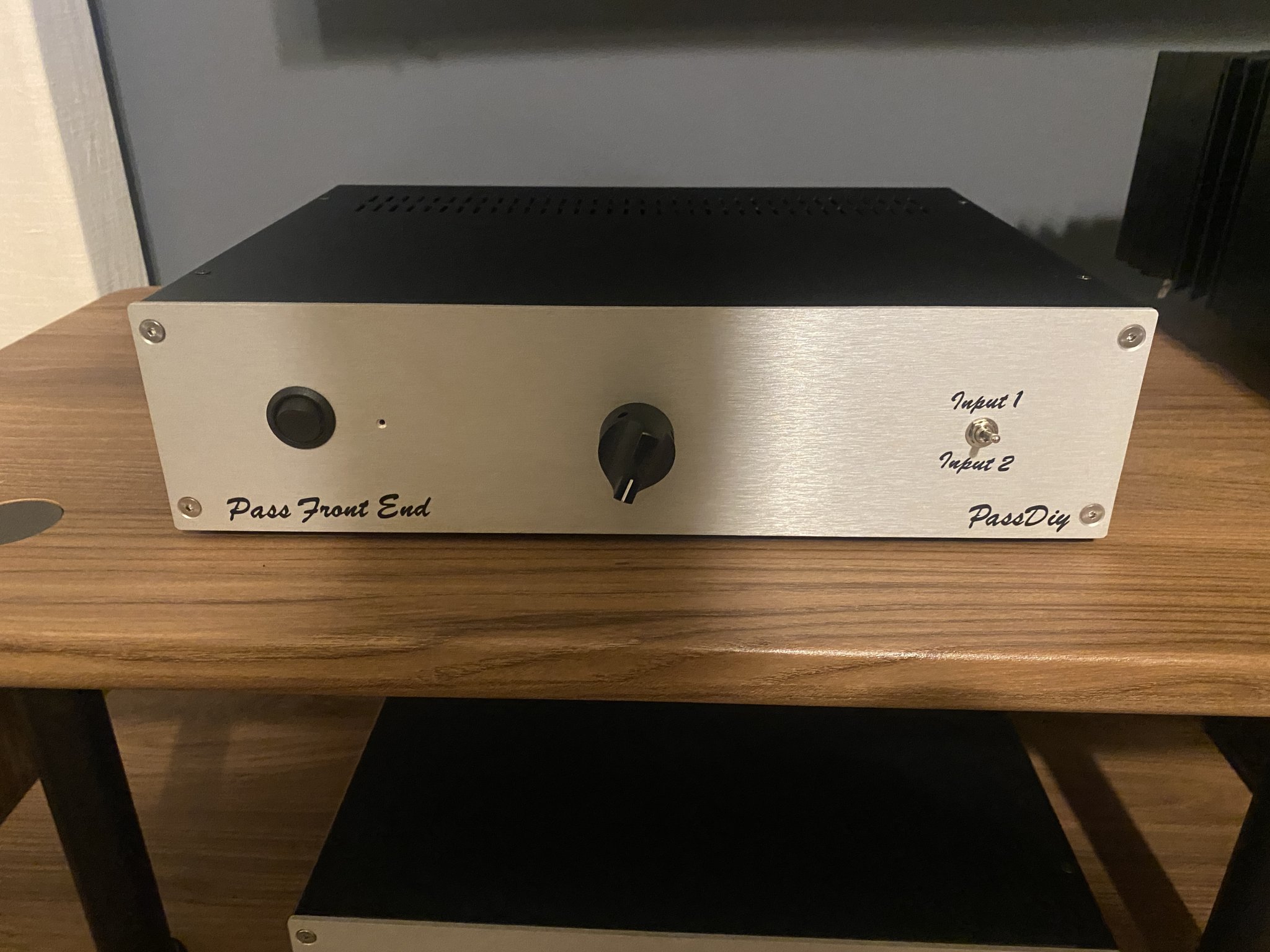

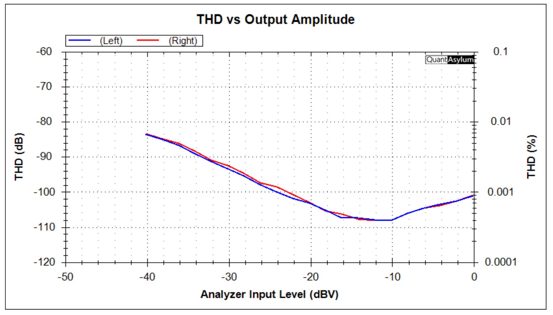

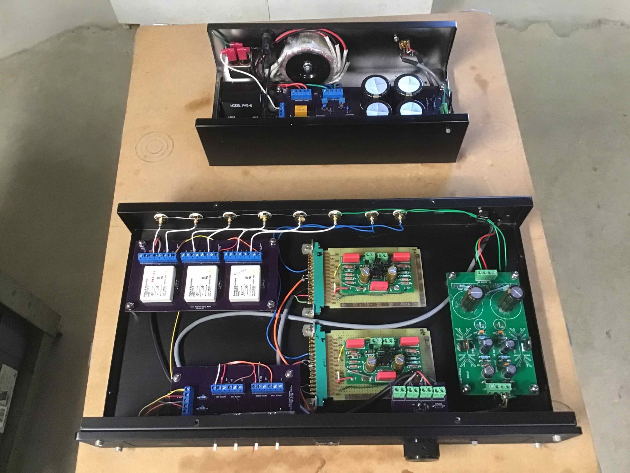

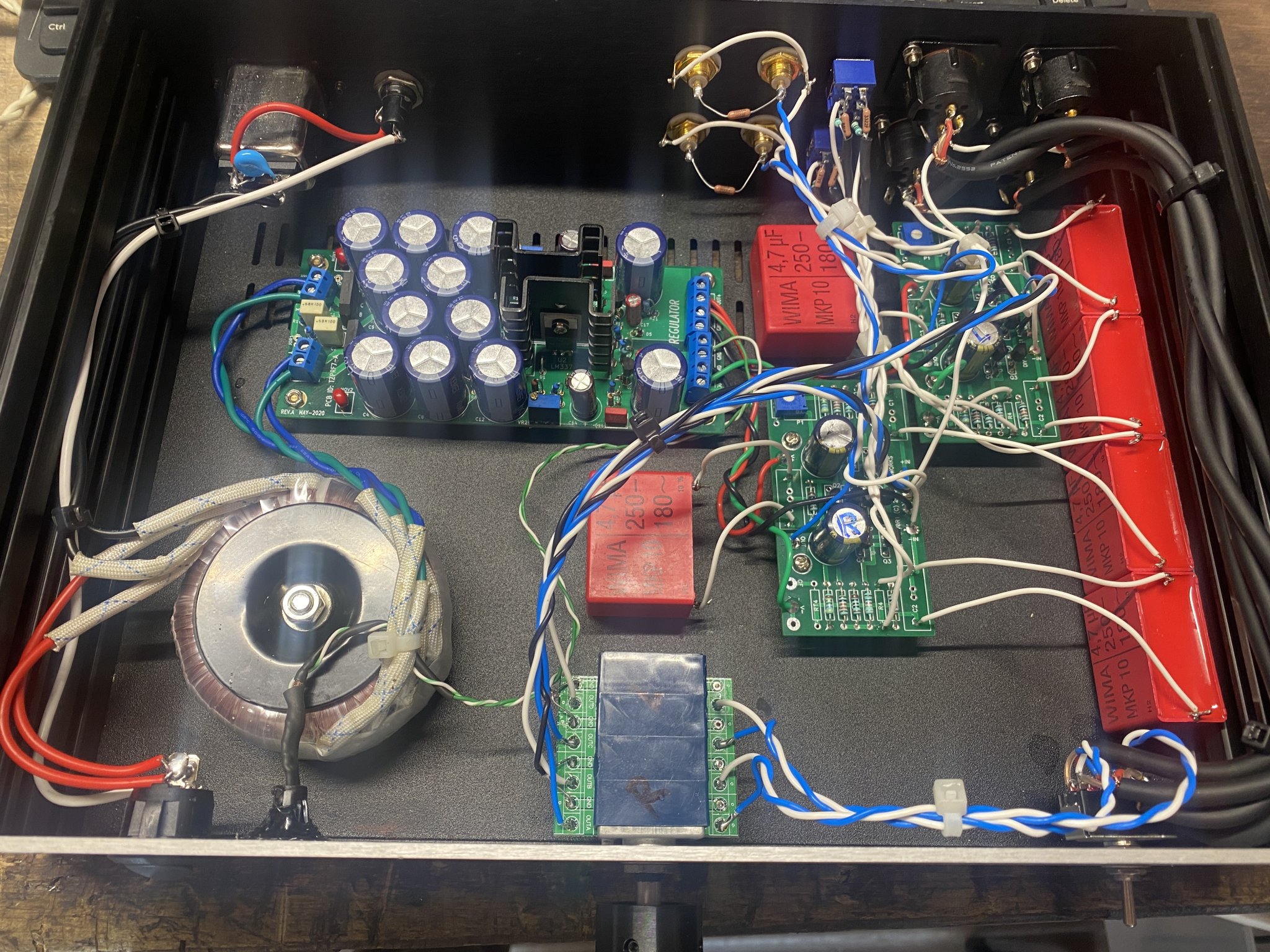

Finally completed my V0R0 DIY Front End preamp!

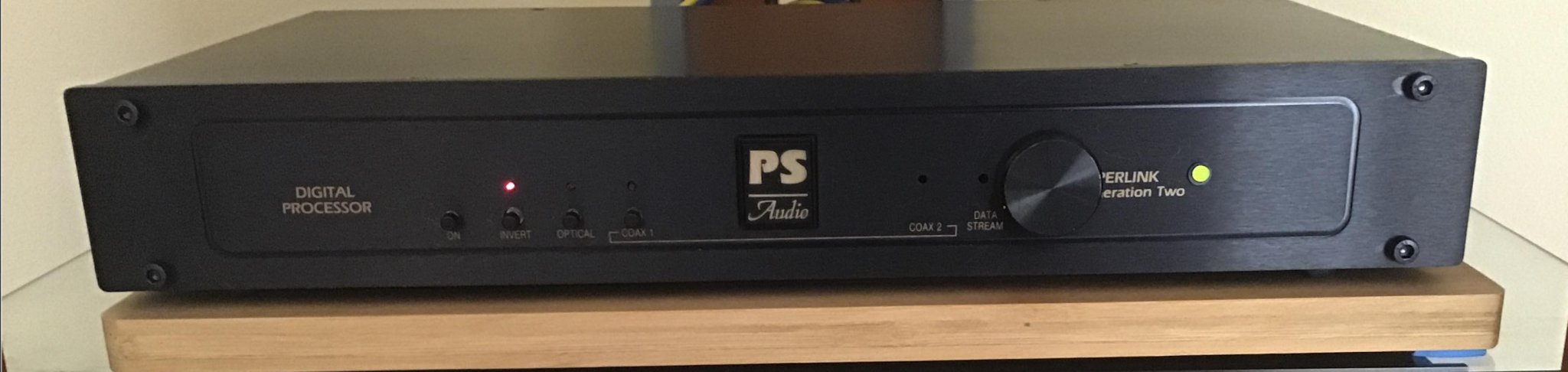

I planned on using this preamp in my living room, so I thought the case should look a bit better than an aluminum box. I had an old PS Audio Superlink DAC in the cupboard that I elected to repurposed for the job. The biggest challenge to using this chassis was to reconfigure the capacitive-touch buttons for control of power and input switching. Since I was not able to find a ready-made interface to these buttons, I decided to go old-school and use pushbutton switches. I was able to use the existing holes in the front panel for the switches, indicator lights and volume control. The old lettering on the front panel is a bit distracting, but I am going to live with it for now.
Previously, I had built a line-level preamp with removable circuit cards so I could compare different op amps (the AD845 wired for unity gain turned out to be my favorite at the time), so I decided to put the DIY FE on the same card so I could inter-change them for making comparisons. Since single ended and unity gain worked for me previously, I decided to stay with that topology. I decided to socket mount all the transistors and the gain setting resistors so experimenting with alternate arrangements would be easier. I elected to use a regulated +/- 20V for power, 2.2 µF input and output capacitors, and an Alps 50K input potentiometer.
I used relay input switching in my previous design, and since I still had some relays available, I decided to go that route again. Also common with the previous design is the external unregulated power supply.

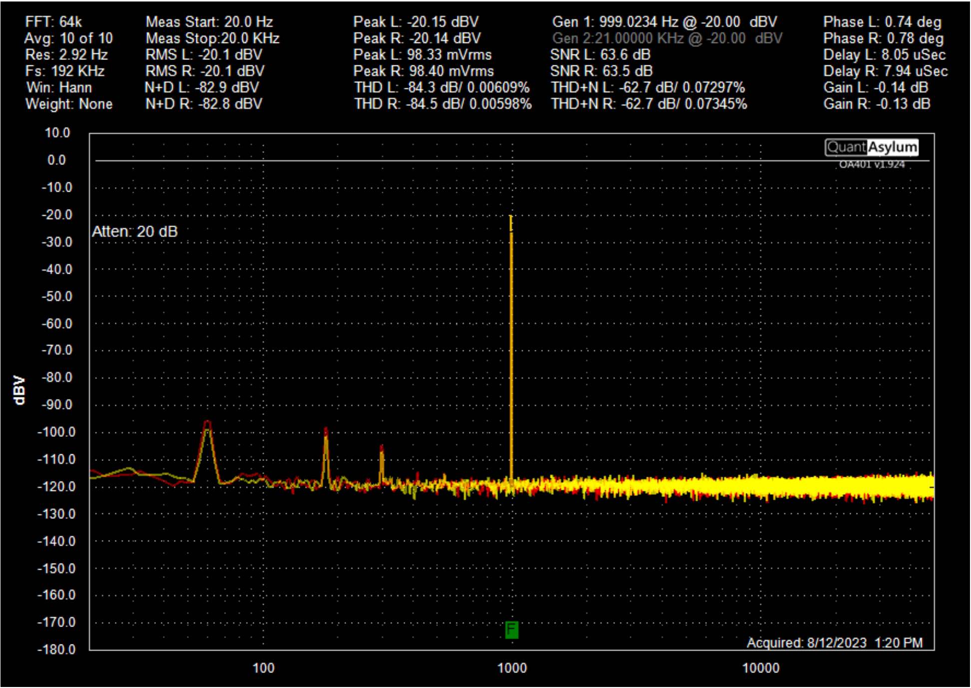

Measurements on this unit look very good. This is, by far, the quietest preamp I have ever had in my system. The residual noise and distortion areabout as low as I can measure. The distortion level and profile are the same as the QA401. Some of the measurements are shown in the attachments. One interesting result is the crosstalk measurements, the right to left is not as good as the left to right. I might be able to fix that by re-routing some wires, but I wonder if it is worth it, considering that I am working with such low levels.
So, how does it sound? Before I tried to make that assessment, I measured the voltage of a 1KHz test tone at the speaker for each preamp. For the DIY FE preamp, with the volume set at maximum, it was 1.46Vrms. For the preamp I have been using the past few years, a tubed Assemblage L-1, with the volume set at the level I normally use, I measured 1.67Vrms. If I did my math correctly, that 0.2V amounted to about a 6dB SPL difference with my 4Ω speakers with an 86dB / 2.83V sensitivity. That’s a larger difference than I expected, but I went ahead and listened to a few tracks before I made any volume adjustments. On 8 out of 11 tracks I compared, the DIY FE preamp sounded just as loud as the Assemblage preamp. That 6 dB difference should make the DIY FE preamp sound about half as loud, but that is not what I found. Not sure what that means, if anything. Maybe someone can offer some ideas? But what I did notice was that music through the DIY FE preamp sounded crisper, with greater clarity – using the visual analogy – it is like a thin scrim has been removed. All told, I could not be more pleased with the look and sound of this preamp.

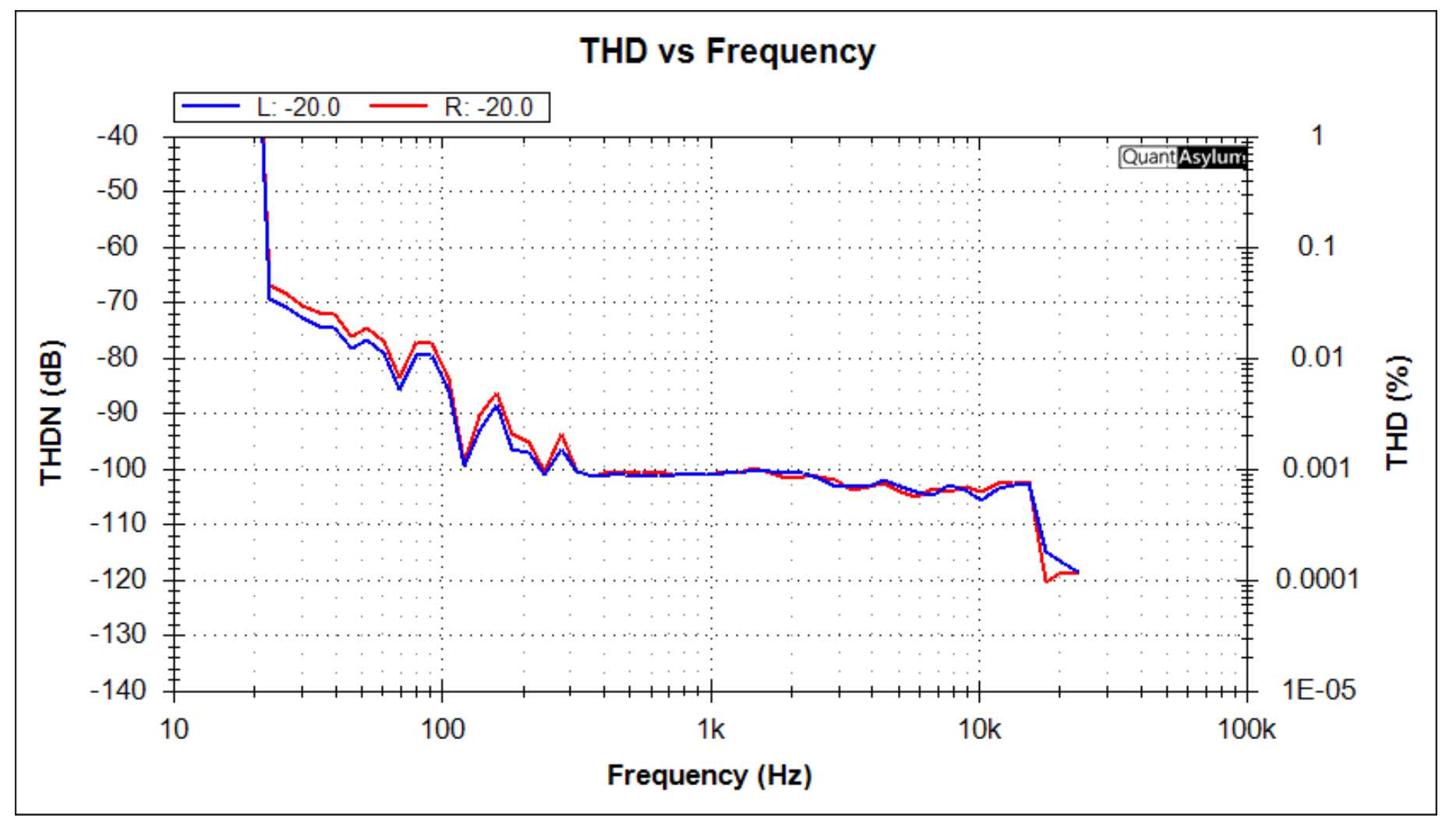

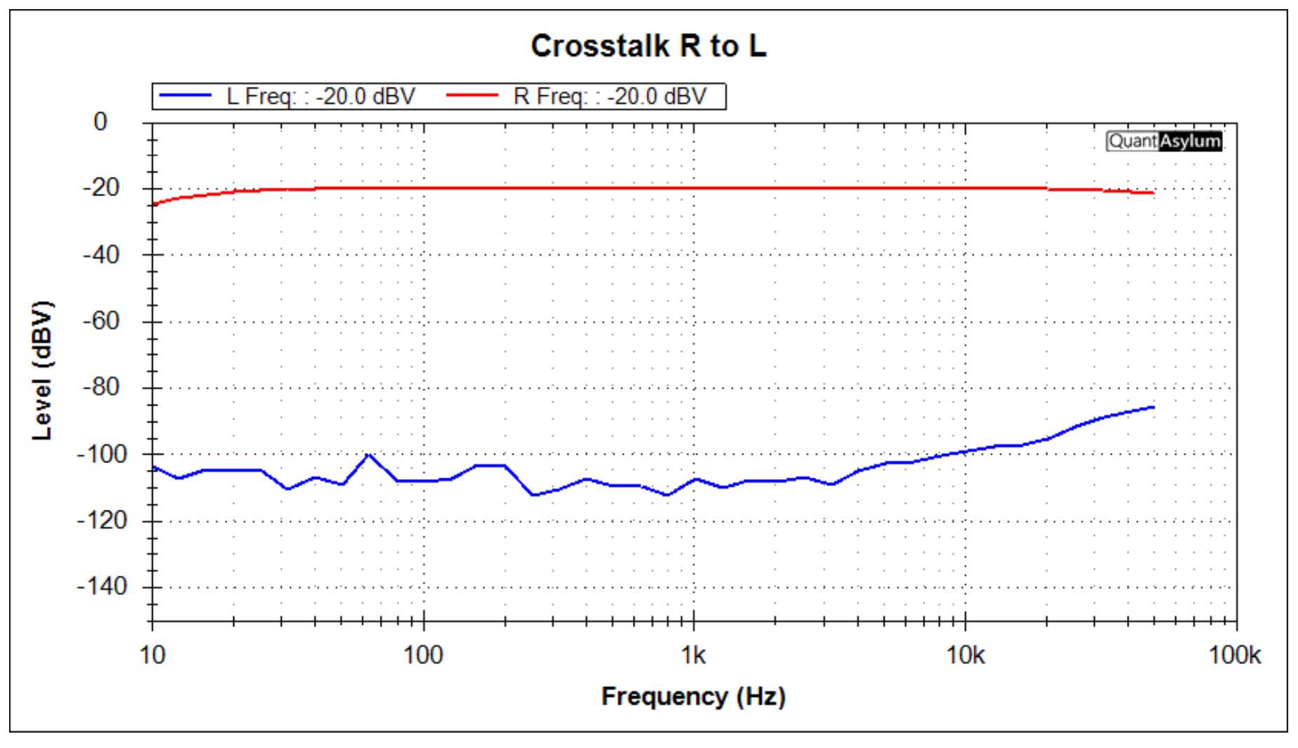

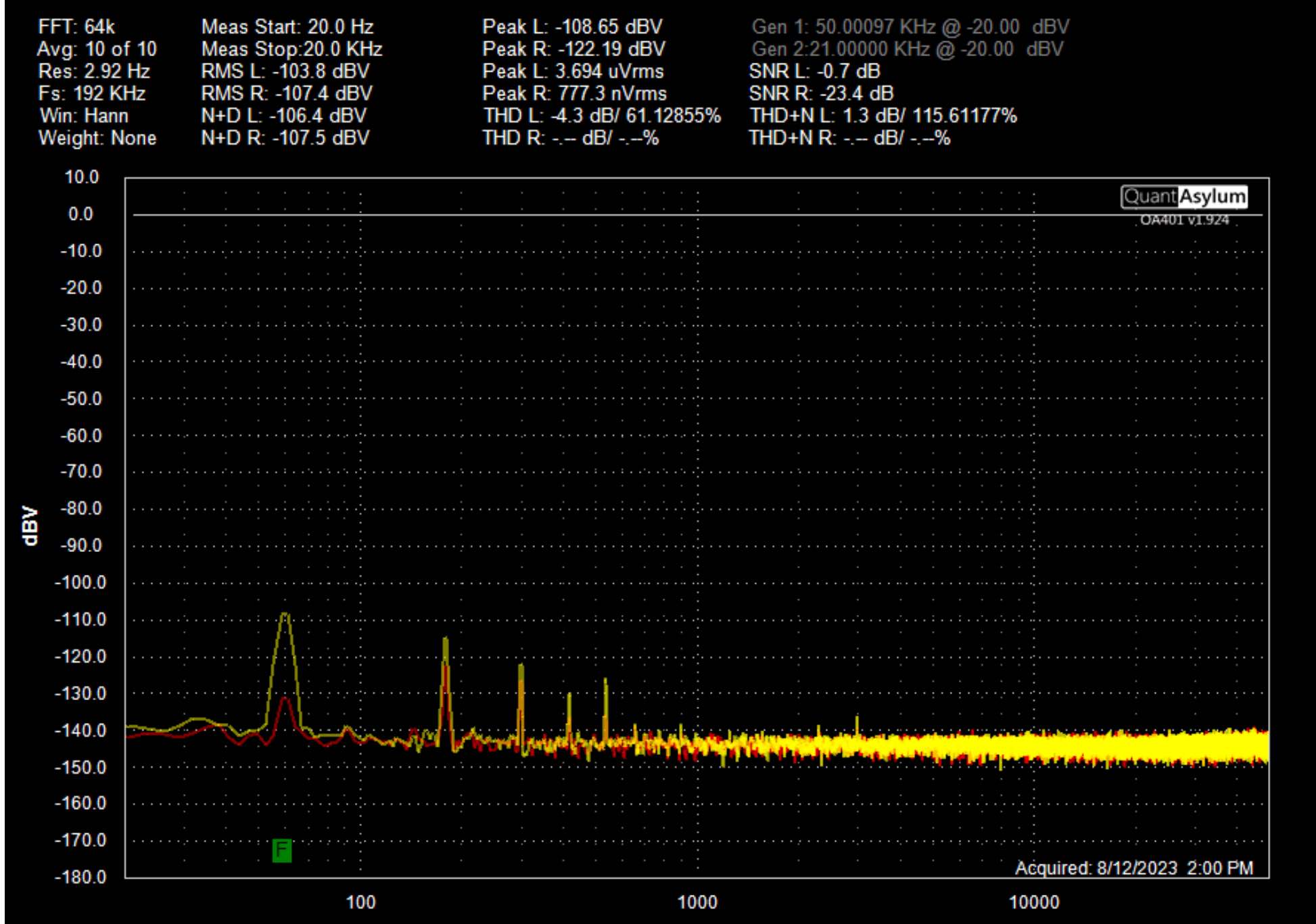

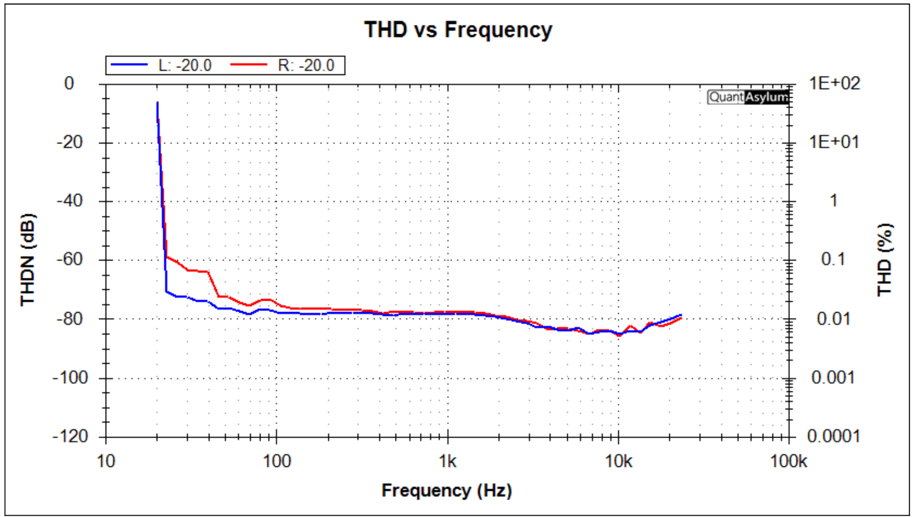

The noise and channel separation may be improved if each signal wire is tightly twisted together with their ground wire from input RCA to board input and from board output to output RCA . Twisted pairs drastically reduce the wires' ability to behave as attennae, to broadcast and receive electromagnetic radiation (signal and noise).
The THD versus frequency plot looks not so good below about 300Hz. Build issue or testing issue?

Hello Dennis, thanks for the reply. Yes, I did that same calculation, but I thought I needed to compare the sound pressure level produced by the two voltages, and not the voltages themselves. Maybe that logic is not, correct? If it is correct, then, I thought the way to do that conversion is using the sensitivity factor for speaker, and then did I do the calculations correctly?
Hello Ben Mah, thanks for the reply. Your point on twisted pairs is well taken. The wire connecting the input switching to the volume control is a 3-pair cable, not sure how the twisting goes, so that may be a problem I can fix. The wire from the volume control to the amp input is miniature coax. I agree, the THD below 300Hz does not look good. That data was collected with the QA401 20-dB attenuator turned OFF. I have other data that looks a bit better (see attachment) that was taken with the 20dB attenuator turned ON. At the time, I assumed the difference was just due to the difference in sensitivity. Comparing the two now, I’m not so sure. Build issue or testing issue? I will work on it.
ceulrich
ceulrich
The coax and 3-pair cables have their conductors side by side or twisted together internally so they should not be an issue.
The main issue is the separation of the input signal wires from their ground returns and the grounds from the RCAs connected directly to the power supply. The ground wire from each RCA should be twisted together with the signal wire and taken to the selector. The L and R outputs from the preamp board should each be twisted with a wire from the ground on the preamp board and taken to the RCA outs.

I do not have a QA401 so I have no idea what is going on there. I suggest you use a meter and monitor the AC input voltage and AC output voltage of the preamp when testing to confirm levels. Did you load the output with a 10k resistor for the test? And was the preamp output 1Vrms?
I use REW and a Focusrite USB audio interface along with a diy voltage divider (Akitika) for my tests so I control the levels and use a meter at the preamp output to measure the output voltage.

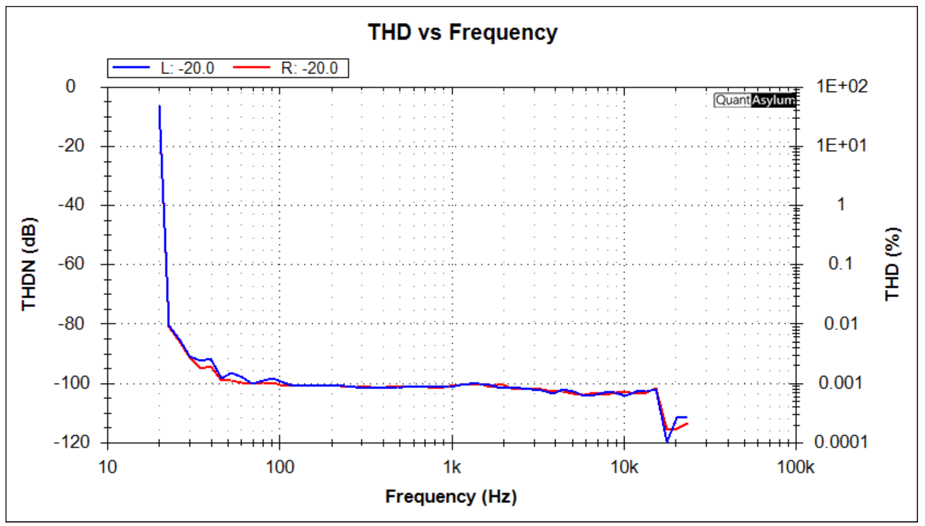

I put the unit back on the test bench and re-ran the distortion measurements. THD vs frequency came out much better (see attachment), THD vs output was the same.
So, I guess the problem was a testing issue.
Ben Mah,I understand what you are saying about the wiring topology from the input connector to the selector switches, and that this is commonly considered the best approach. But, from my research, in practice, many designers seem to do what I did. Look at the picture of 6L6’s construction on this forum (sorry I could not quickly find the post #). In addition, with the distance being only about 7.5”, I thought it a reasonable compromise.
The wire from the amplifier to the output connector is another matter. 6L6 uses coax, and I thought about that quite a bit. I finally decided to just use a wire, and if I had interference problems or noise, I could easily change it. In fact, the differences in crosstalk between L>R and R>L may be due to not shielding or twisting those wires. But with crosstalk around -100 dB, does it make any real difference?

Twisted wires and minimum loop areas are based on science. But if you are happy, then all is good. 🙂
As for the calculations, what Dennis said.
