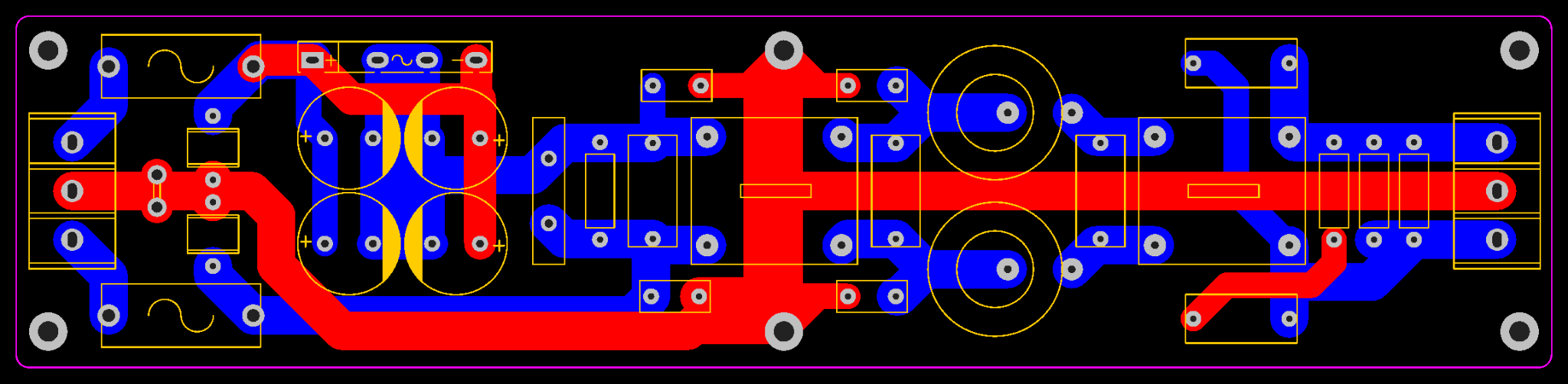

This was the last version of the threads subject isn't it? The thread itself seems to need a good filter.You still have to do the notations for the component values.
I hope I didn't make a mistake... I did it quickly. 🙂
In the future, take care of the symmetrical arrangement of the components. If I can help you with anything else, I am at your disposal.
A list of the components used would also be necessary.
BTW it likely needs ferrite beads over the incoming mains cabling. The uninterrupted isolated ones are optimal, the click on versions are less good.
Please let's go back to the original subject. There really have been enough infiltration attempts which have resulted in dynamic loss of proportions.
From my point of view it's the latest version. I just helped with the correct drawing, nothing more.This was the last version of the threads subject isn't it?
I don't know what components he used, etc. etc, etc. 🙂

Thank you for separating the various posts. This thread was about designing and making a JLCPCB version of the EMI filter suggested by the original poster message #1, including the edits suggested by @jean-paul and @Julian RO .
Everything else is unrelated and was deviating from the main discussion of this particular project.
Now that the boxes are here I will proceed as usual trying to fit everything in them and arrange the components differently if necessary. I'll come back when I have more updates.

Splendid! Thank you very much, I will do everything and post the gerber file when it's done. A few people got interested and want to build the filter now.
Thanks again for your time and dedication.
I'm new to filters, but love the work you all have put in this post. I have a few questions about the revised schematics vs. latest layout.
In the first revised schematic (not OPs original, but Mimiragons rewamp from March 13th), there were two bridge rectifiers with two caps, for each N and L. In the latest layouts I see only one, but with all four caps. What was the reason for this? And are there any pros/cons of just one? Also, 4x 1000uF vs 2x 2200uF, in a DC block?
I also wonder about the reasons to remove the 600 ohms resistor between the 1nF caps and PE?
I also see one choke has been removed in later revision. Was it unnecessary to begin with?
