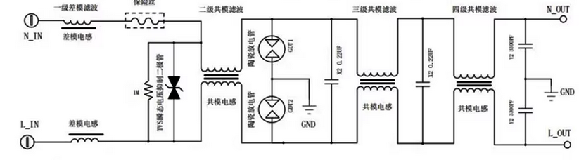

Well then, let's go back to the beginning. Take a look at the OP schematic. Other than the fuses, what other thing did you need to adjust? At this point it would be easier for me to do a new PCB all together than editing the existing jpg picture of the bottom layer.
Well, I looked and think this device should not be built at all in its current form as it interrupts PE by means of L3 and R1 in parallel. This is against code. The ground loop breaker should be in a device it feeds and then from Audio GND to PE. The way it is now also means that the shielding is “lifted” which can not be allowed as the shielding can possibly be touched. The situation around the GDT and RV1 and RV1 and that of R2/R8 and C3/C10 is plain bizarre and already concluded in post 16. They of course won’t be a problem as they will never see action 🙂 Resistors F1 and F2 (fusible?) limit current when the MOV triggers but why? Normally one wants the MOV to clamp and let the fuse blow ASAP to protect the load. Also it would be good, besides the fuse, to use the correct terms L, N, PE and 230V.
Sorry. Just think what the situation is when connecting a 3 prong amplifier to this device. The amplifier casing will not be connected to PE but via a 6A maximum coil in parallel to a 20 Ohm resistor.
Hi, I have seen a lot of commercial EMI Filters like from Schaffner the E types which have a Choke in the PE line, and then I remembered from my education 20 years ago that PE is not allowed to be broken as you mentioned. Hmm can you clarify this for me. Maybe choke is allowed? Sorry it's a question, not smart as talk 🙂

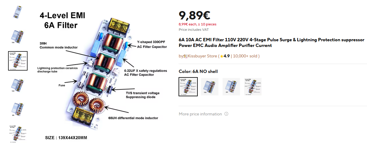

I just stumbled upon this, maybe some of the elements here can be taken into consideration for modifying the circuit, like the connection of the GDT. This version has also a fuse.
Something cool could also be rebuild the filter around these chokes and inductors, they're easily available on the internet. You could even buy that filter, harvest the components from it and use them for the filter If needed, making the new board around those components. 👌
