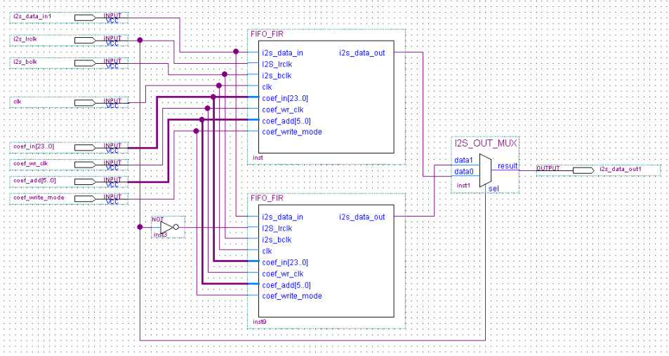

...each FIR block only processes the left channel of an I2S stream, but this is good as it is easy to add more channels and still process both channels of a stereo I2S stream (most surround receivers I've seen use stereo pairs.)
The attached screenshot shows how simple it can be to add more channels. You simply add a NOT gate to the LRCLK of the second block, then add a mux at the outputs to combine the data together. The result is a stereo filter.
To use this on surround data, or for crossovers, you just add more blocks (as long as they fit the FPGA.) I haven't done any accurate calcs on how big an FPGA is needed for decent length filter....
...but, a 2048 tap mono filter takes around 5% logic elements, and 81% memory bits of an Altera EP2C5T144 device. This is a cheap device and is used on the Pluto-3 board.....
http://www.knjn.com/ShopBoards_RS232.html
So, it could be used for say an 1200 tap stereo filter, and you would still have tons of logic left for a user interface (LCD), USB and all sorts.
Few actual logic elements are used for the FIR blocks even if more taps are added, so if the FPGA's memory blocks start to run low, I'm sure external RAM could be added instead of buying a more expensive FPGA.
(The coefficient inputs in the screenshot are connected to both channels for simulation, but it would be easy to load separate coefs for each block / channel.)
