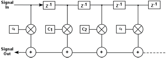

Am I getting this roughly right?.... (I've never found a really good diagram of this process, but the attached image is a basic 4-tap FIR filter).....
The "Z -1" sections are where each incoming audio sample is delayed by one sample as it goes "through" each tap and onto the next "Z -1" section. This happens once every clock tick (ie. at the chosen sample rate.)
The FIR filter samples are loaded into C0, C1, C2, C3 etc. (known as the filter "coefficients"). You then have to multiply all of the incoming samples (stored in the "Z" sections) by the FIR filter samples (stored in the C0, C1, C2, C3 sections). The results of all these multiplies are then added together to give the new output audio sample.
As each sample clock "tick" happens, the incoming samples progress through to the next "Z -1" section until they reach the end of the filter. The filter coefficients (C0, C1 etc.) only change when you want to change the filter itself.
(ie. the incoming audio samples are in a queue which is as long as the filter length. Eventually, all incoming samples will have past through every tap until they reach the end and are discarded (or "fall off"!). In the example diagram, this is only 4 taps, but we would need a few thousand taps.)
The reason it can get expensive is because all of the stored taps need to be multiplied by all of the filter samples, and then the totals added together before the next incoming audio sample arrives. (ie. all calculated 48,000 times per second, or whatever sample rate you're using.)
(People with keen eyes may have noticed that I've changed from "bits" to "samples" because I realized that each incoming (and outgoing) sample is actually a discreet sample, and not just one bit! eg. for 16-bit audio, each sample can have a value from 0 to 65535 etc.)
If this does describe most of the basic process, then I'm sure it could be quite easy to achieve using an FPGA instead of a DSP chip. Even fairly long filters could be processed in parallel at high clock speeds. I even have a small FPGA kit (Pluto II) which I could try some code on.
Now I just need to work out how long the filter needs to be (as a minimum) to perform decent enough room correction.....

OzOnE_2k3, your description of the FIR filter sounds just about right. Wikipedia has a reasonable diagram of the process, which you might find useful.
That's pretty well it, except filter coefficients are never called samples - it's too confusing. That term is reserved for audio data.
