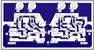

well normaly they shouldn´t get hot at all, maybe a little warm.
I use 30 AC transformers so that means around 42 volts after the bridge and caps so the voltage drop is around 12 volts.
current draw should be 20ma (10ma for each IRF Mosfet).
if only the 317 runs hot and not the 337 than the problem is either the PSU itself (maybe a short or bad component or somewhere in the circuit).

I use the same transformer.promitheus said:well normaly they shouldn´t get hot at all, maybe a little warm.
Not sure the PSU itself is the issue (tho' that's what took the hit -- esp. the 317 reg -- when I had a short in the power-connecting wiring between the PSU and the IV; I replaced the 317, but new one gets v. warm after about 10min -- its being asked to output 37mA).
As noted earlier: when I disconnect the IV, the 317 runs fine. Also, the IV sounds fine (haven't 'scoped it out or taken any detailed measurements, tho').
Well, after all this checking and testing and such, there's not much choice about what to do - either strip out all the parts and start from scratch, put a big heat sink on that poor suffering 317, or try a different power supply -I suggest a discrete reg as they usually sound better on this unbalanced version of the D1 o/p stage.

I replaced the IRF610s, one-by-one (taking current measurements after each replacement). I ended up replacing all four, but the current draw on the (+) rail is still 36.5mA.promitheus said:well normaly they shouldn´t get hot at all, maybe a little warm.
Current draw should be 20ma (10ma for each IRF Mosfet).
If only the 317 runs hot and not the 337 than the problem is either the PSU itself (maybe a short or bad component or somewhere in the circuit).
I also DMM-ck'd many other components on both the PS and main boards. They all ck'd out "fine."
I installed a larger heatsink on the 317 to better protect it; as a result, it now only runs moderately warm.
