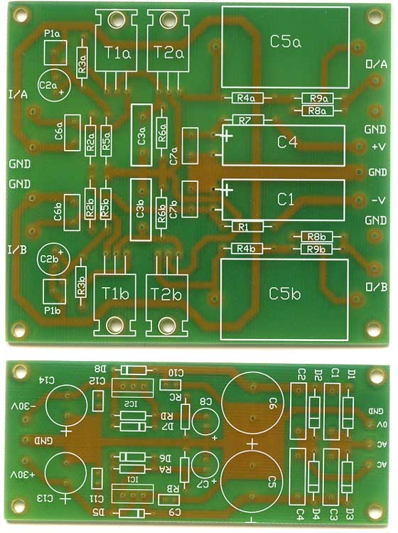

The cap is still there.
The difference here is that there is no balanced volume control.
In the Pass DAC there is a volume control that has a low Resistance value.
That means to block DC without the High Pass filter getting into Audio you need a large capacitance.
In my Version I only have a 100K resistor at the output so you only need 4,7uF Cap there. For better quality I use an Audyn Cap MKP Capacitor.

Important notice !!!!
Hi everbody.
I want to thank everbody for the great interest in the pcbs.
I have sent most of you an email with an order form you have to fill out with your address and what you want to order say I can tell you what it will cost, how much the shipment is, how you can pay me and some info on parts.

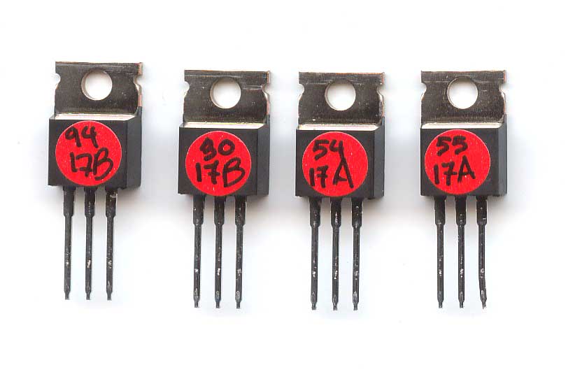

The IRF610 I matched look like this.
All are in quads but the ones with the same letter are better matched.
First I measured the Vgs of every one at the same temperature and same time. After that I made groups that exactly the same voltage to the 3rd digit for instane 3,917 Volt. Thats what the 2 numbers on the Fets are. They are the last 2 digits of the first measurement.
After that I put 2 Mosfets at a time on the JIG with presisions resitors and measured the voltage difference between the 2 Vgs. You get a better measurement this way bacuase the Multimeter is scaled at mV.
The pairs are matched to better as 5mV normally at 2-3 mV.
Thats better as 0,1% tolerance.
Attached is a picture of what a quad looks like.

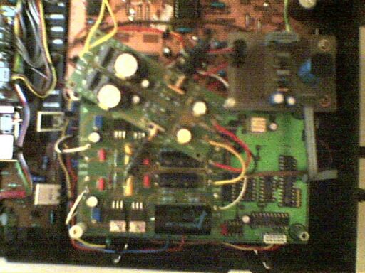

One is up and running now. Just for testing. All seems to work well, but i only listened for a moment (it's getting late here and it's not great to run a class a amp with these temperatures
Connected just one pcb, so no balanced mode. What you see in the picture (top2bottom):
cd650 main pcb
display powersupply
d1 powersupply
d1 stage
dac underneith (two tda1541 full balanced, clock on dac with feedback to player).
I'll stick to this for a moment and concentrate on the preamp now.
Using a meridian 201 for the moment and it's not that great🙄 cmos logic for volumecontrol....😱
Then a redesign of the dac pcb and stuff all in the cd80.
The things sticking into the regulators are hf diodes with a heatsink, the lm's were getting a bit hot (anyone just running them without heatsinks?)
