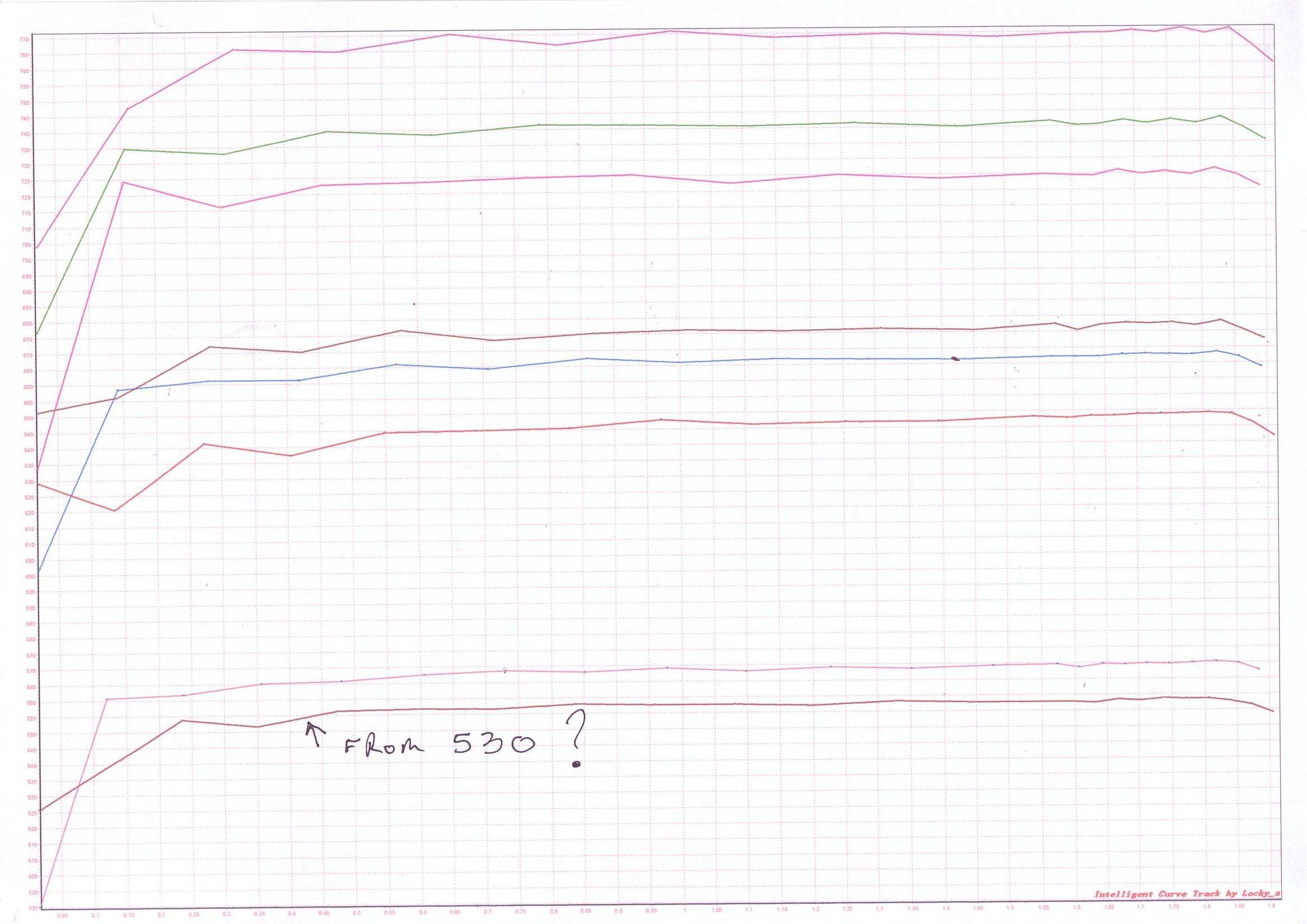

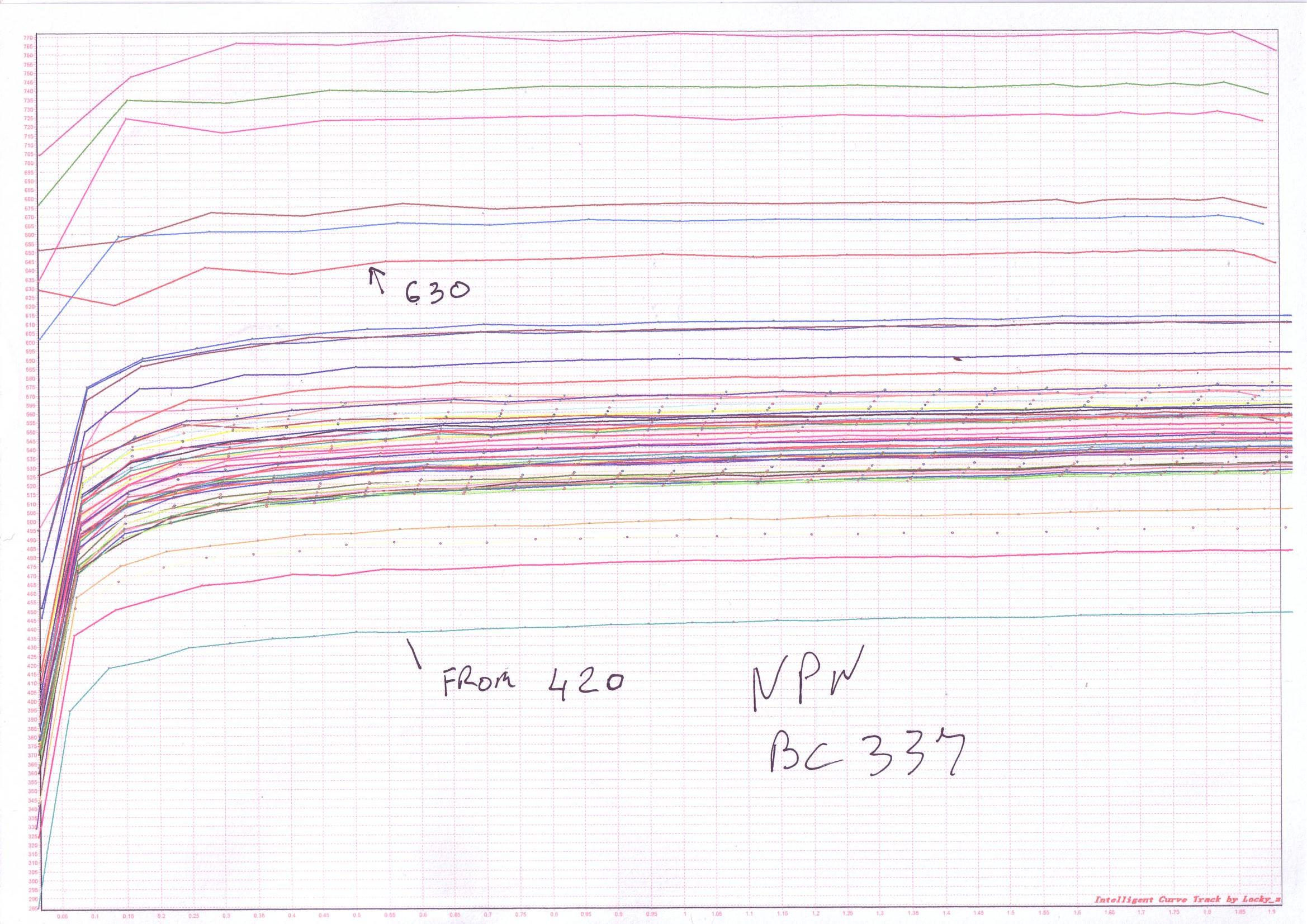

Here are curve from BC337-40 NPN and BC327-40 PNP
PNP mesure is wrong, very hi HFE
Transistors are original Fairchild from manufacturer
I have mesured 400 PNP and 1000 NPN
NPN ok PNP vrong go up to 770 big offset
I don't understand why?
When I mesure with Atlas component tester PNP HFe is ok and same as NPN

When Ic is less 0.5mA,The Ib is less than 0.5mA/Hfe=0.5/700=700nA,
The buffer(OP07) bias current is 1.2nA,offset current is 0.5nA, they all less than the Ib, So the system measure the Ib is right,
So I think the pnp curve is right. Its Hfe is more than 700.
I look at your picture,The Ic is less 1.8mA, I suggest use RC=12K,
When ic less 0.5mA, the Vrc=0.5*12K=6V,
If you use RC=1K, the Vrc only 0.5*1K=0.5V,
System measure the small voltage may have less 15mV error.So if use RC=12K is better than RC=1K
Tanks locky I will try with 12 K still PNP mesure different from NPN.
Error shuld be same if there is error.
When I mesure with different instrument HFe is as on data sheet.
Data sheet say HFe is between 400 and 630 for both transistors
Many NPN mesure at around 520
PNP around 640 if I change formulae to Hfe=abs(Ic/Ib)-120 then HFe is ok
I do not understand why ?

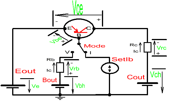

Their no polarity inverter circuit,
The PNP measure diagram is below
attachment.php
If test PNP, System will set Eout to 36V,
And step down the Bout inorder to generate Ib.
System measure the Vrb,Vrc and calculate the Ic and Ib and Hfe.

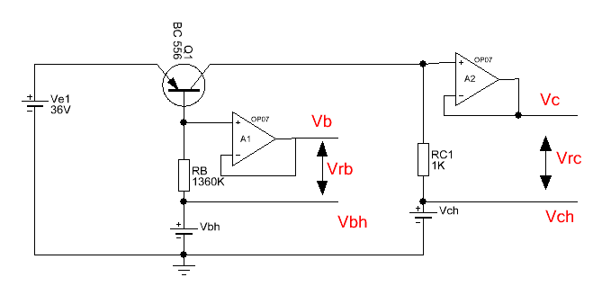

The Vrb Vrc measure circuit is below
attachment.php
It use a OP07 as follower, The op07 bias current and offset current will have some voltage drop on RB. But Op07 bias current and offset current less 5nA,and Op07 offset voltage is less 1mV,so OP07 only a little affect to DTU base current.

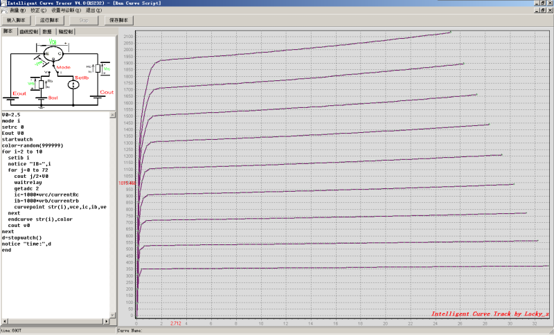

Softwere update ,It can support script control.
The script is
V0=2.5
mode i
setrc 0
Eout V0
startwatch
color=random(999999)
for i=2 to 10
setib i
notice "IB=",i
for j=0 to 72
cout j/2+V0
waitrelay
getadc 2
ic=1000*vrc/currentRc
ib=1000*vrb/currentrb
curvepoint str(i),vce,ic,ib,ve
next
endcurve str(i),color
cout v0
next
d=stopwatch()
notice "time:",d
end
