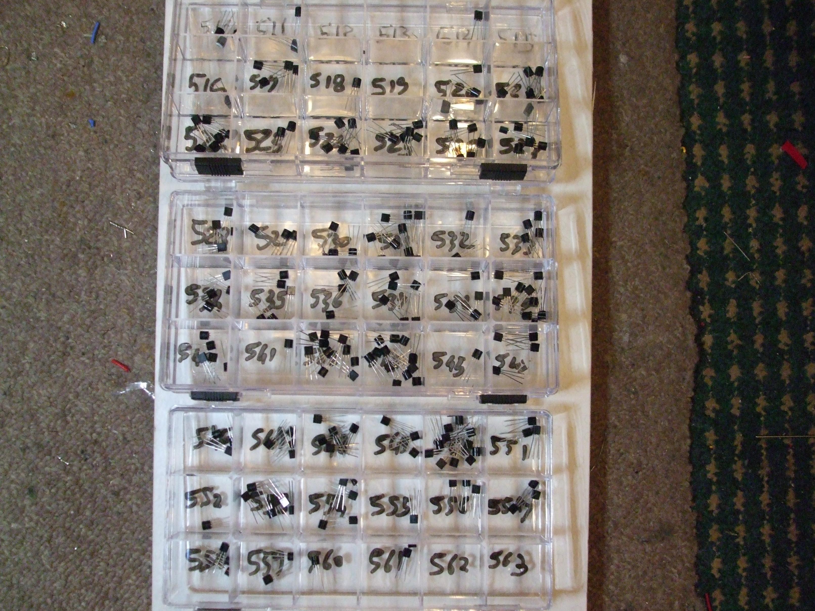

Got about 600 more then start again bin by bin
Then 1000 PNP
Then again fine sorting before they get soldered
No problemo boards not due in for couple of weeks

Got the labeling part down pretty good. Need to learn how to sort in excel. Could do it with progrgam I guess, but a streamlined process would be nice. Going to be trying some things this weekend with sorting. Bet LockyZ sort feature would be nice hint. OTOH, when you get em from the factory, they tend to stay nice and tight anyway😉 I have been able to get my fets pretty hot by using .01V step up. Dont know if others have experienced this Right now settled at .1V, but thinking of more dtatpoints for more accuracy. I wish there was a way to pick Vgs measurement points. THen you got primo control. Anyway, LockyZ, dont listen to me. I just fussing ove a phenominal piece of equipment.
