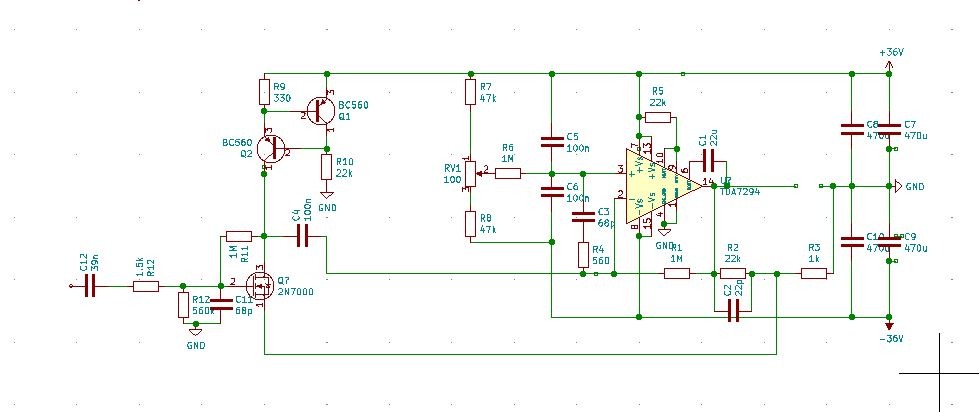

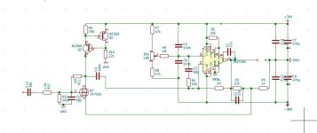

I have designed many amplifiers where all the posted files sing in perfection, not to mention SET 300B/2A3C. Either you have wide band open loop or op amp type and 70db@20khz. The experience with your zero distortion amp shows there is no alternative. Bellow is an example of very low cost amp which got 70db@20khz and sings celestial voice.
Thank you for precising that Frank's voice sounds dirty with this amp, because I don't know exactly what causes this phenomena, now for sure it is not due to amp nonlinearities. There are many other voice that have such character, as Neil Diamond, young Barry manilow, Pavarotti.
If you can skip just a single sip of beer, buy from Ali this
https://www.aliexpress.com/item/100...!sea!TH!4284450371&curPageLogUid=VWH0Bfb0nz85
and modify it to ABD mod
https://www.diyaudio.com/community/...nto-abd-modulation.396664/page-4#post-7301714
and you have the highest resolution possible I know that will show you how the music file should sound like. I decided to end definitively analog amplifiers, as I cannot imagine what kind of analog amp I can design, all technologies confused, can reproduce such high level of resolution.

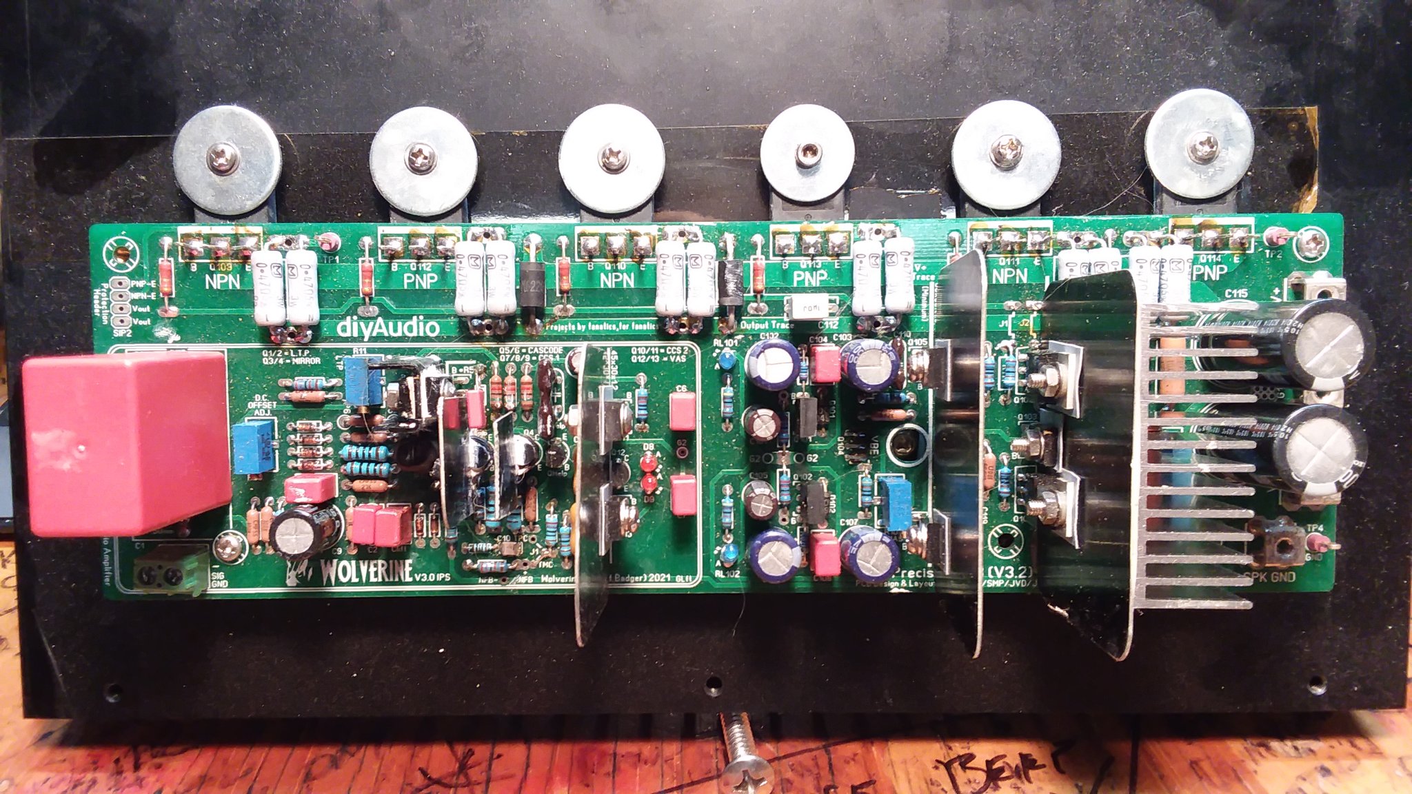

I have a question about bias thermal compensation. When I install Q104 I measured the Hfe at 177 with ElCheapo tester, and so I chose the 68 ohm resistor for Rcc. As I play with the amp, it seems that perhaps the thermal compensation is too great. I am under the impression that the thermal compensation is intended to hold the voltage across the emitter resistors relatively constant over temperature, perhaps slightly over compensated for safety. My voltage definitely drops a lot as the output stage heats up. Q104 is mounted to a middle output transistor, MJL3581A. Voltage starts around 92mV at 15C, stabilizes at 43 around 35C at idle. I drive the temperature up to about 45C at 50W output with 49 volt rails. Turning off the signal, results in 23mV. The stage cools and goes back to the idle temp and bias in the 40 -44 range per the build guide. The temperature is measured with a thermocouple clipped to the heat sink in contact with the output transistor. I'm not sure that the absolute temperature is correct, as the cold junction is "simulated".
This is an EF3-4. It seems to me that the compensation slope is too high (absolute value). Should I increase the Rcc under the assumption that I have measured Q104 Hfe much higher than it is, or do I need to go the other way?
Thanks for whatever help the experts choose to give me.
