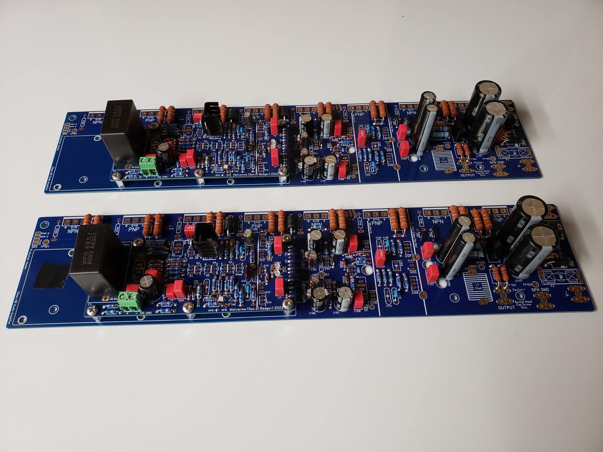

Wow. I'm so happy that its up and running. The first Wolverine amplifier to run outside of our build team. CongratulationsHI Guys,
The wolverine is running !!!!
Check it out:
Really happy with the sound so far, bear in mind this is in a shed recorded in mono from mobile phone microphone played on an old speaker....
Enjoy
-Dan

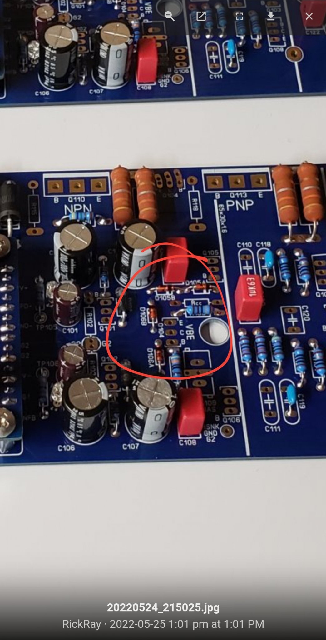

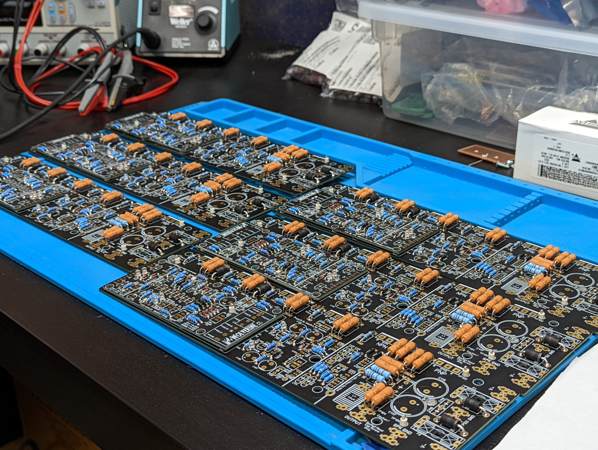

My one week update! On to capacitors now.
Just want to say theses PCB's are by far the BEST I have worked with, solderability is amazing and the carefully thought out layout, spacing and sizing! WOW you guys did an amazing job. Oh and silk screen component ID's on the bottom layer was a great idea too.

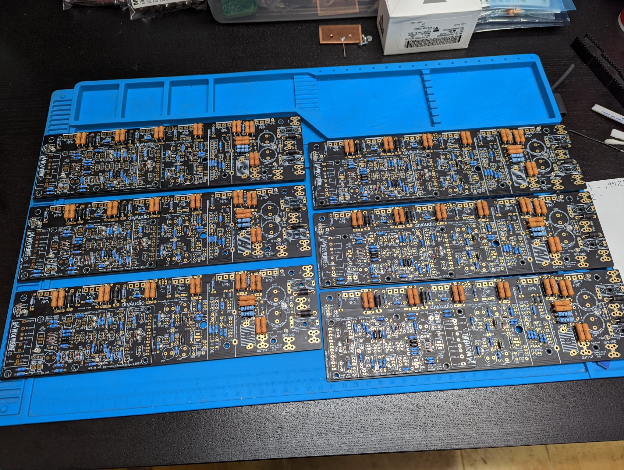

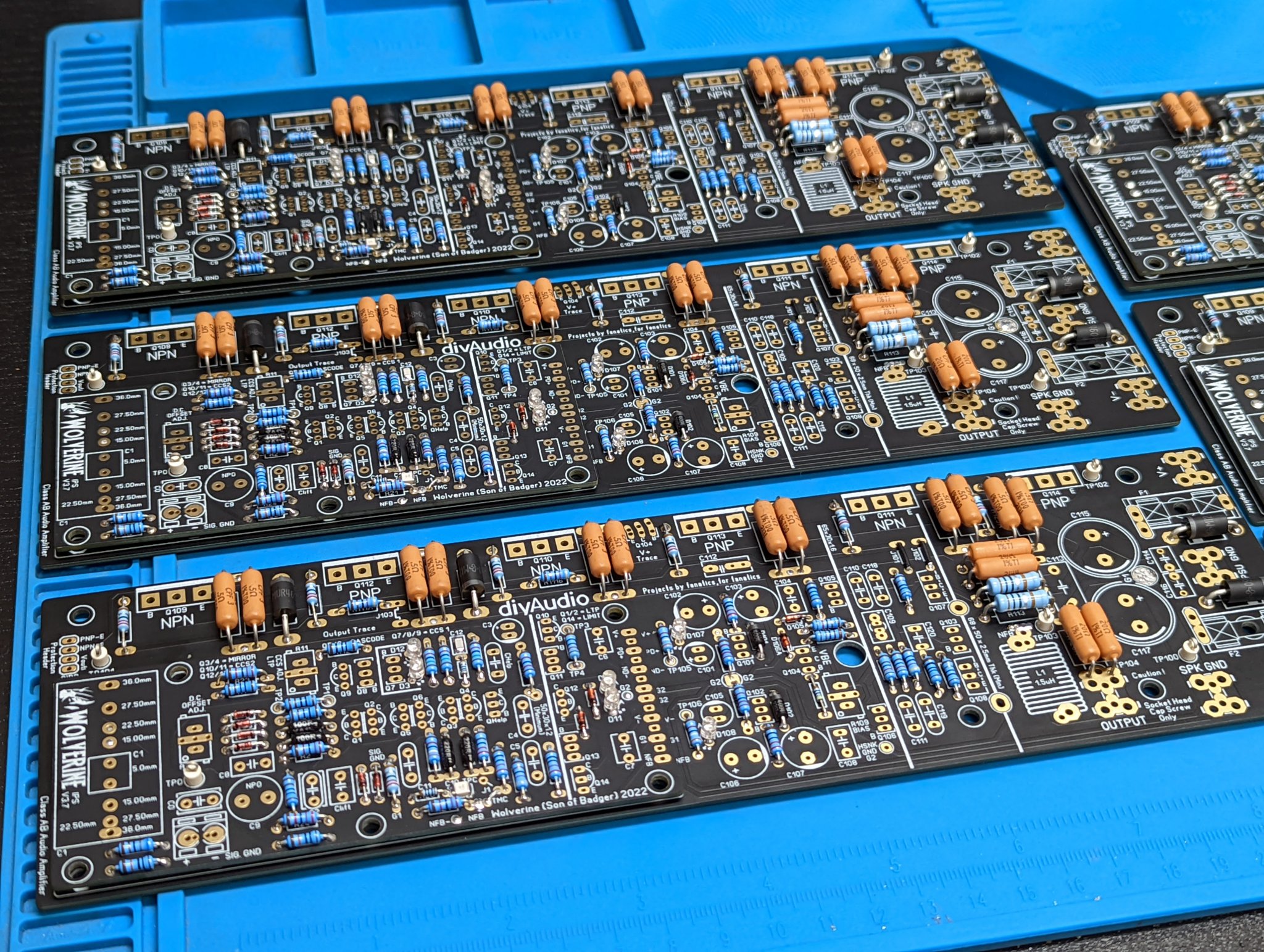

This is awesome, just starting my build now! Just finished my second badger litterly friday night!

Beautiful board build Stuart! Sounds good as well. Looking forward to the finished amp.Wow. I'm so happy that its up and running. The first Wolverine amplifier to run outside of our build team. Congratulations![]()

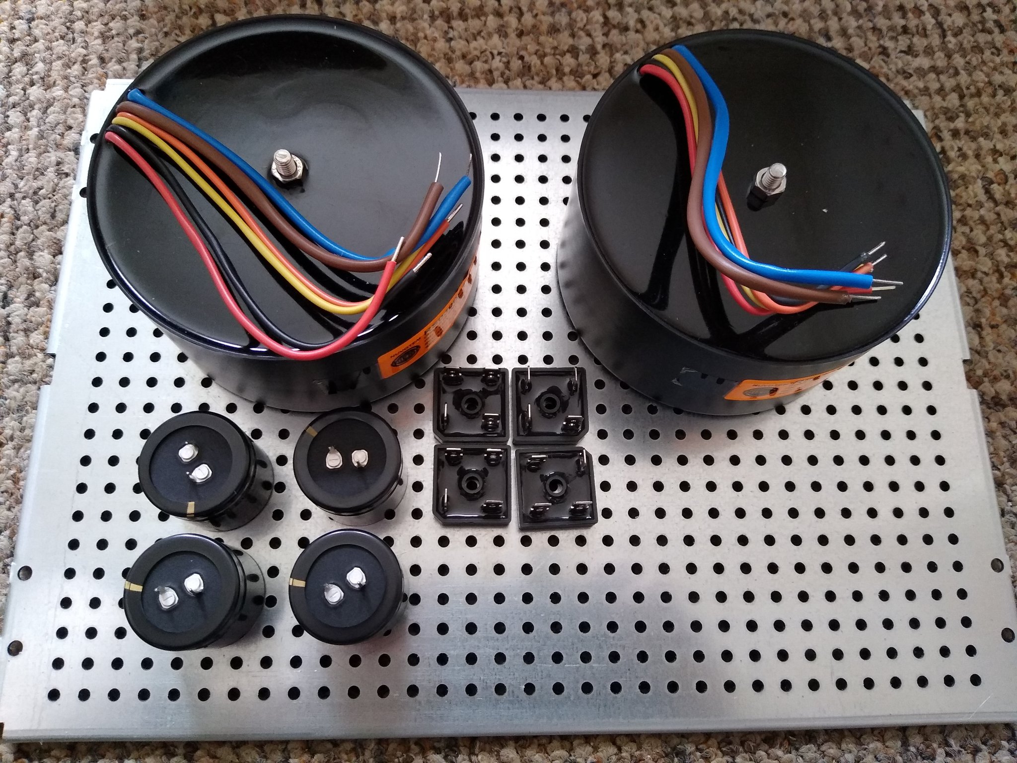

Question(s) for you all:
I know the Wolverine was tested using just a C-filter supply (transformer->rectifiers->10,000uF caps per rail->amp), but I noticed some plan CRC supplies. Would this amp benefit from the reduced ripple (what's the ripple rejection like?) or is CRC for this amp just "gilding the lily" (which is fine)?

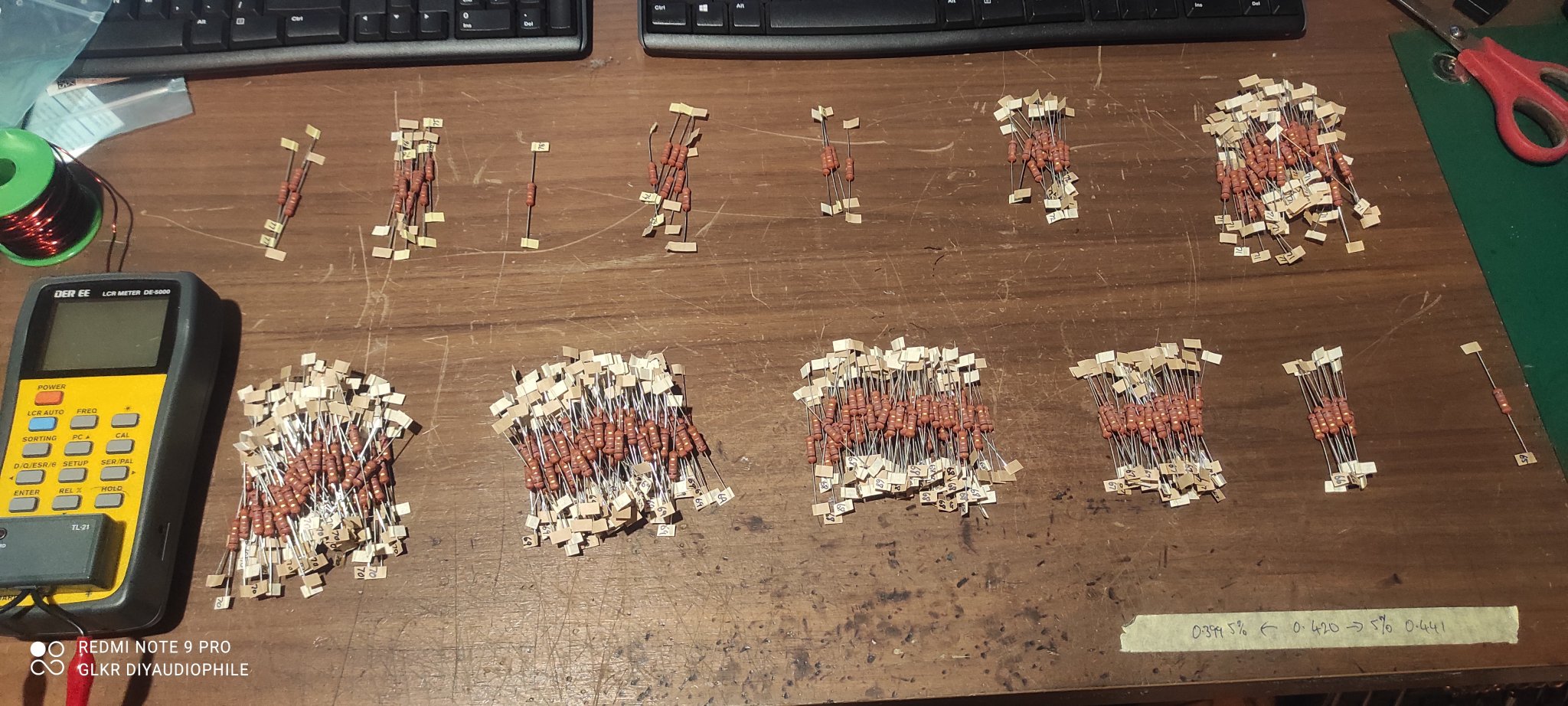

I managed to get this batch of resistors tested tonight.
I will use 3x 0.68 Ohm in parallel for my outputs.
These are TE connectivity 3W film resistors.
I figure the fact it will be 9W ability, the higher ppm (300ppm) won't matter too much

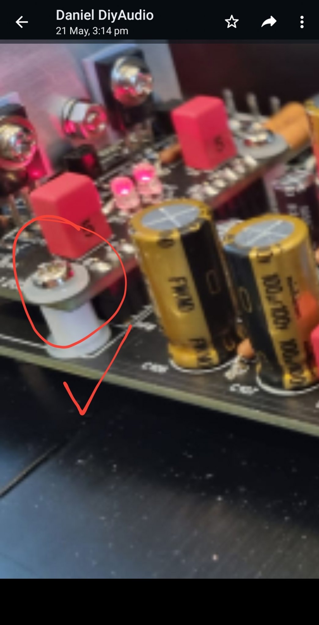

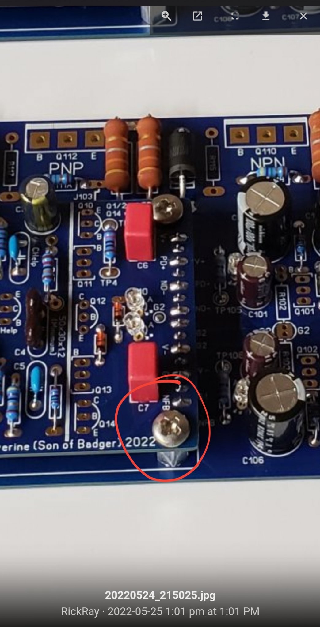

Also.
1. Are you not planning on running mica caps.
2. Watch your creepage of your bolt heads. Please use a plastic washer or a socket head cap screw
