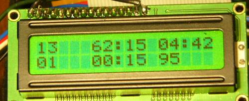

Status on LCD
LCD is 44780 Compatible.
On LCD show
Total Song
Track No.
Total Time
Elapse Time
Time of each Track

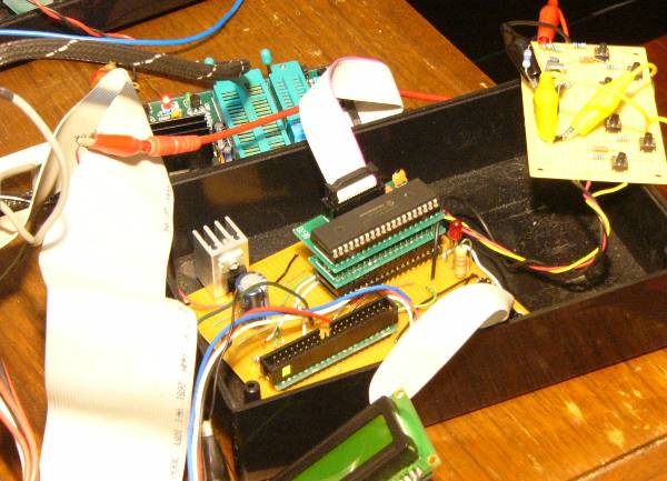

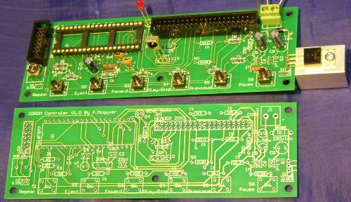

pradit_p said:Hello,
Thanks, This base on Mucop diagram design, but I swap some port and route my own pcb .🙂
oh. have you finished/got it working yet? keep up posted. 😀
Reguarding the posts on programming the PIC16F877A, It is compatible with the normal non-"A" chip, It is possible to program them with the simple DIY "JDM programmer" and the free IC-Prog software.
Hints here...
http://www.midibox.org/cgi-bin/yabb/YaBB.cgi?board=troubleshooting;action=display;num=1060700142
Hints here...

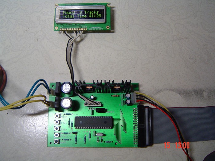

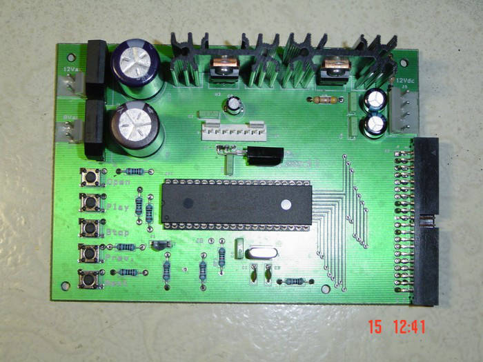

Davesaudio
Hello Mr. Davesaudio
Rightnow I also finished my board , bug fix and remote command.
Now my board is in on one week test run.
For Mucop code is work fine in select push button code and open-close Tray, after that you need to code new one for play, skip, stop and pause command.

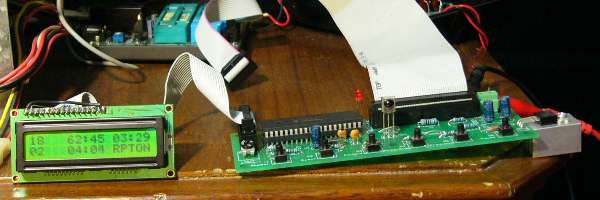

The features of the board:
- IR sensor for a Philips cd remote control (I used the remote from the cd-pro kit) ;
- 5 buttons on board for basic functions;
- 4 modes time display (absolute/relative/ascendent/descendent)
- 2 modes search speed ;
- repeat 1/all ;
- direct track access ;
- standby mode ;
- random mode ;
- 2x16 dot matrix display interface
Tested and works perfectly with following units:
Plextor PX-54TA
Teac CD-552E
Teac CD-W540E
BTC BCD40SB
LG GCE8520E
Asus CDS520
