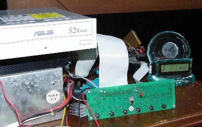

Just a thought but wouldn't it be better to have the control buttons on a daughterboard that would maximise the options for building the whole thing into a case?
Lupulroz,
What transformer are you using? Any source? Also, does the board support a backlit LCD or do you have to run separate power to it?
The transformer is just an ordinary one with AC output 9V & 12V.
You can add wires to put your buttons anywhere you want.
The LCD gets the power also from the board.

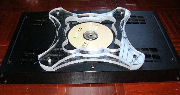

Great looking player
Nice one Pradit_P,
What kind of case are you using beneath the acryl?
Can't hardly wait to see more,
Michael
Nice one Pradit_P,
Michael
Hello Michael
That 's universal steel box that can bought in local electronic market.
Glad to see you like it.

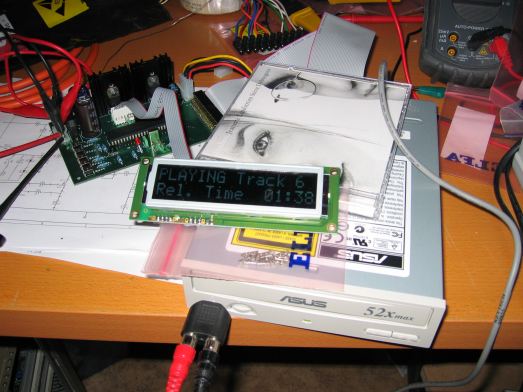

Just reporting that the CDROM controller in post #412 is working just fine. I tested first with a Sony U-710 which played some tricks and basically didn't work at all. I swapped it for an ASUS S520 (as shown in some other posts) and it works just fine. Only problem which suprised me is that the CDROM is vibrating and making quite a lot of noise at 1X which I did not expect. Maybe it's just this unit...
