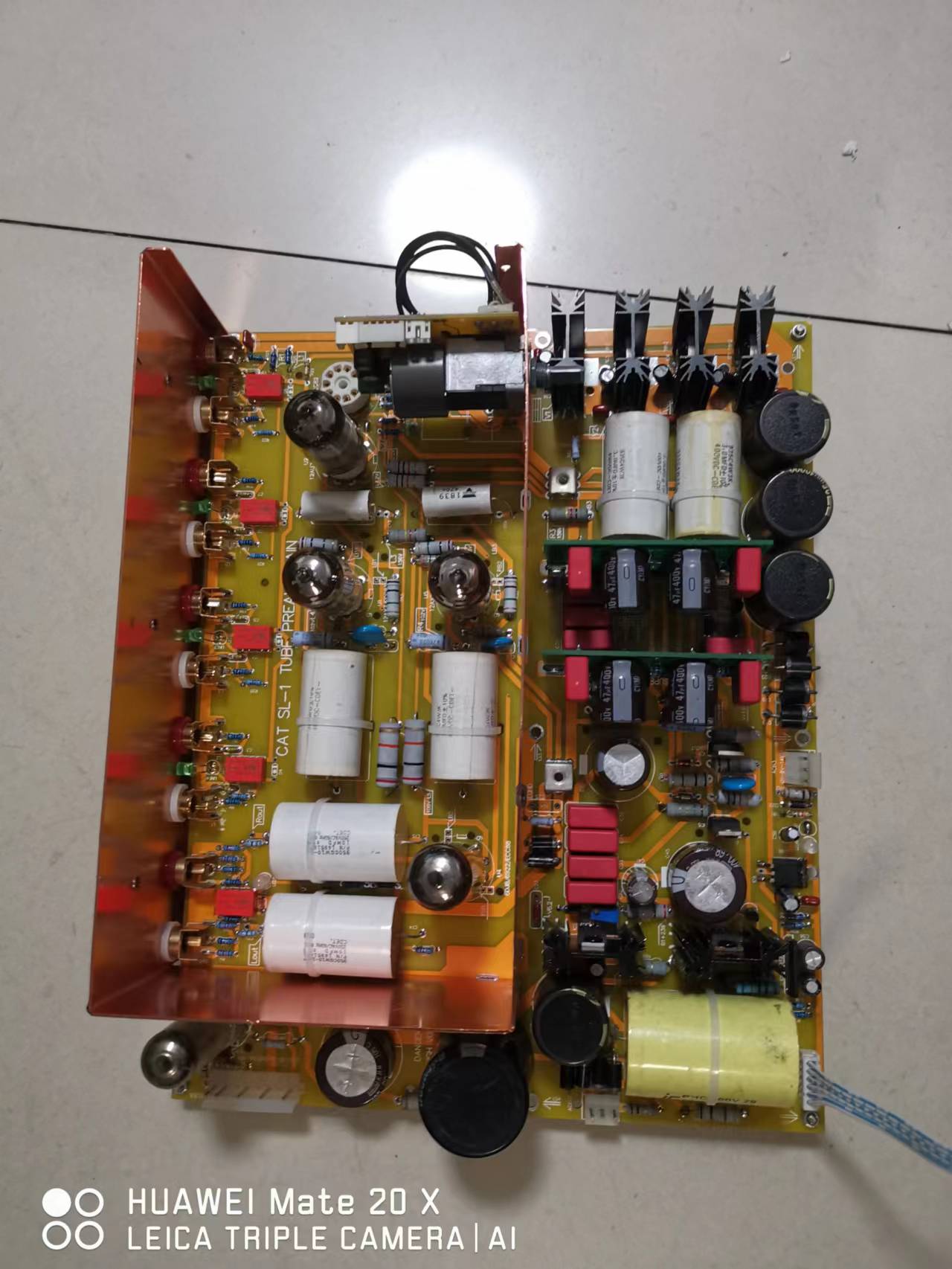

Thanks a lot for tracking and uploading schematics and parts layout. I am in the process of attempting to rectify an SL1 mk2 which blew the 317 regulators and checking to see if the mosfets have survived.

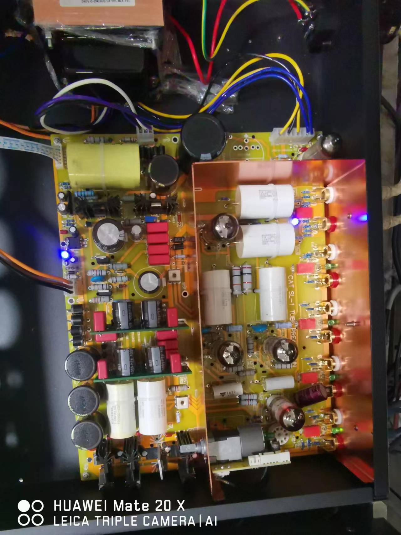

I know this is an old thread, but it seems the closest I have found to good information on this piece. MK2 version SL1 SN: 6064 The unit I am working on has a constant noise on both channels. I have replaced the tubes, with no change. The Power Supply has a burnt resistor R5 does anyone know the value it is supposed to be?
You may have some burned small mosfet all over the place, and even burn small LM 317 regulators. These small regulators are part of the Maida stype HV Regulator, should be ok if they are floating on the HV, but they are very fragile and get burn easily if anything goes wrong on the HV… I know I fixed a few. On my own version I ended up replacing the Maida regulator with a nice, slow start HV shunt regulator. It is much better, has lower noise and the slow start protect the small Mosfet.
With the power off, and any HV drain off! you can check the small mosfet, if the are short between Drain and Source, well they are dead and need replacement.
The small LM317 shouldn’t be short between an In and Out pins for obvious reason. Also in circuit, with the HV on, you should measure lower voltage at the Out pin than the In pin…
Keep in mind there is a long string of zener reference for the LM317 Q7. I saw also some unit with shorted zener that caused incorrect reference voltage.
Finally the original pcb is fragile, with small part pads, easy to damage when desoldering. Work with care on it.
