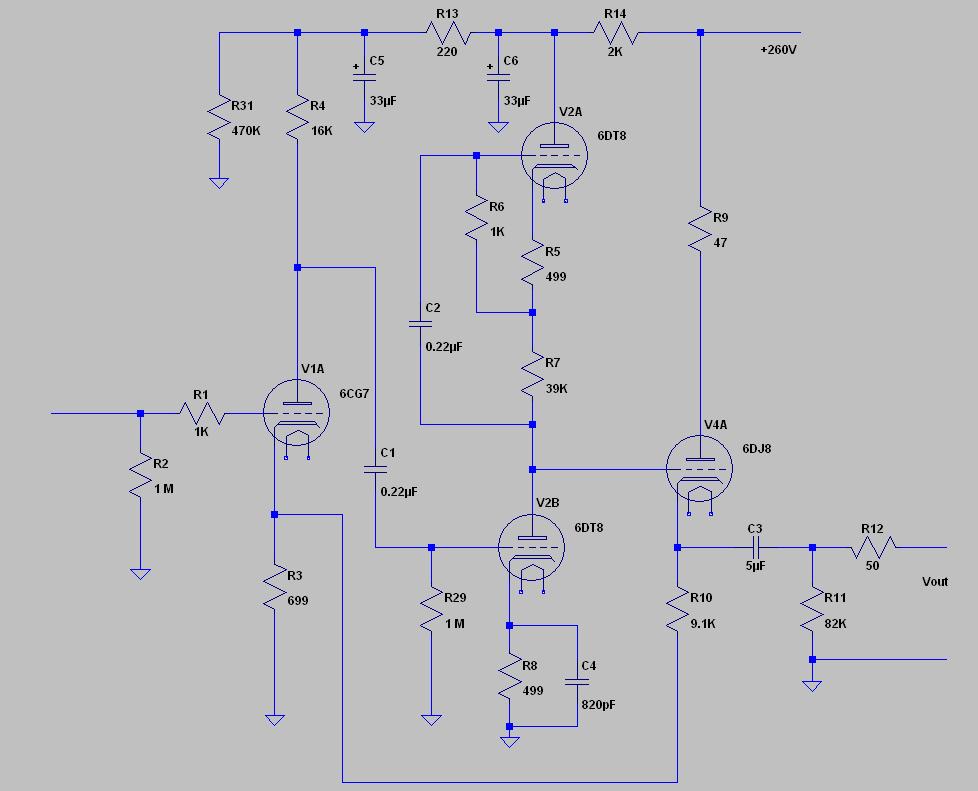

This is the circuit I built on the eBay board that I purchased a few years ago. The 6DT8 is basically a 12AT7 without a center tapped filament. I did test this circuit as I built it and I feel the front end is biased in a more linear operating point than the original circuit that used a 12AU7 (in the directions and schematic that came with the board). I used a lower closed loop gain as well. I'm not using this preamp currently but it functioned fine for me.

The upper valve already has the same drive as the lower valve just from having the same cathode resistor.
But this sets the idle current, the additional resistor modulates the current to a wished symmetry upper/lower valve... So my unerstanding of SRPP is such:
Lower valve cathode resistor is "local feedback", upper valve cathode resistor derives a drive signal.
u-Follower:The additional resisor ca be used to "replace" the drive from the upper cathode resistor with a correct sized drive, so that upper an lower valve are driven in a symmetric manner. I the current set is couple with 1M, so drive is only done with the additional resistor of the u-Follower...
(My explanation is no load condition-what is the case in the CAT1, because a cathodefollower added...
So, getting to the point Hans showd: Looking at the u-curves of the added datasheet, it seems that 3mA could be a stable u Area.
Hans said, 1mA gives a stable u... I can't see this. Please explain...
HJWeedon said:
I took a look at the characteristics of the 12AX7 as published by GE in December of 1961. These characteristics curves show that at 1mA plate current the mu of the 12AX7 is just about 100, essentially independent of operating conditions. When a device behaves that linearly, essentially no significant change in mu over a range of anode currents, the tube has to be the "cat's meow" as far as amplifier linearity is concerned.
In other words, if you operate the 12AX7 as a resistance coupled voltage amplifier with a 210V power supply rail the near optimal operating point should be with a 70k resistor in the plate-lead, (essentially equal to 68k) and the bias of the 12Ax7 should be adjusted to 140V across the tube and 70V across the plate resistor, a little more than 1mA in the plate-circuit.
To get the benefit of constant mu the valve has to see a high (ideally, infinite) anode load. This is because the transconductance (and hence anode impedance) are strong functions of current. 70k is far too small a load for an ECC83. You need at least 10 times the anode impedance, if possible. For that you need either a very high supply rail voltage and a high value resistor, or an active load.
In a mu-follower the extra resistor adds to the drive from the upper cathode resistor, not replace it. In most cases this means the balance is lost, so we now rely on the linearity of the valve. That is why SRPP is best for non-linear valves, but mu-follower is best for linear valves.
Running an ECC83 at 3mA with low anode voltage means that the grid voltage is low and inside the grid current region. This adds distortion by loading the previous stage. ECC83 is a wonderful valve when used in the right circuit, but behaves badly in the wrong circuit. This may be why it is so unpopular with some people.

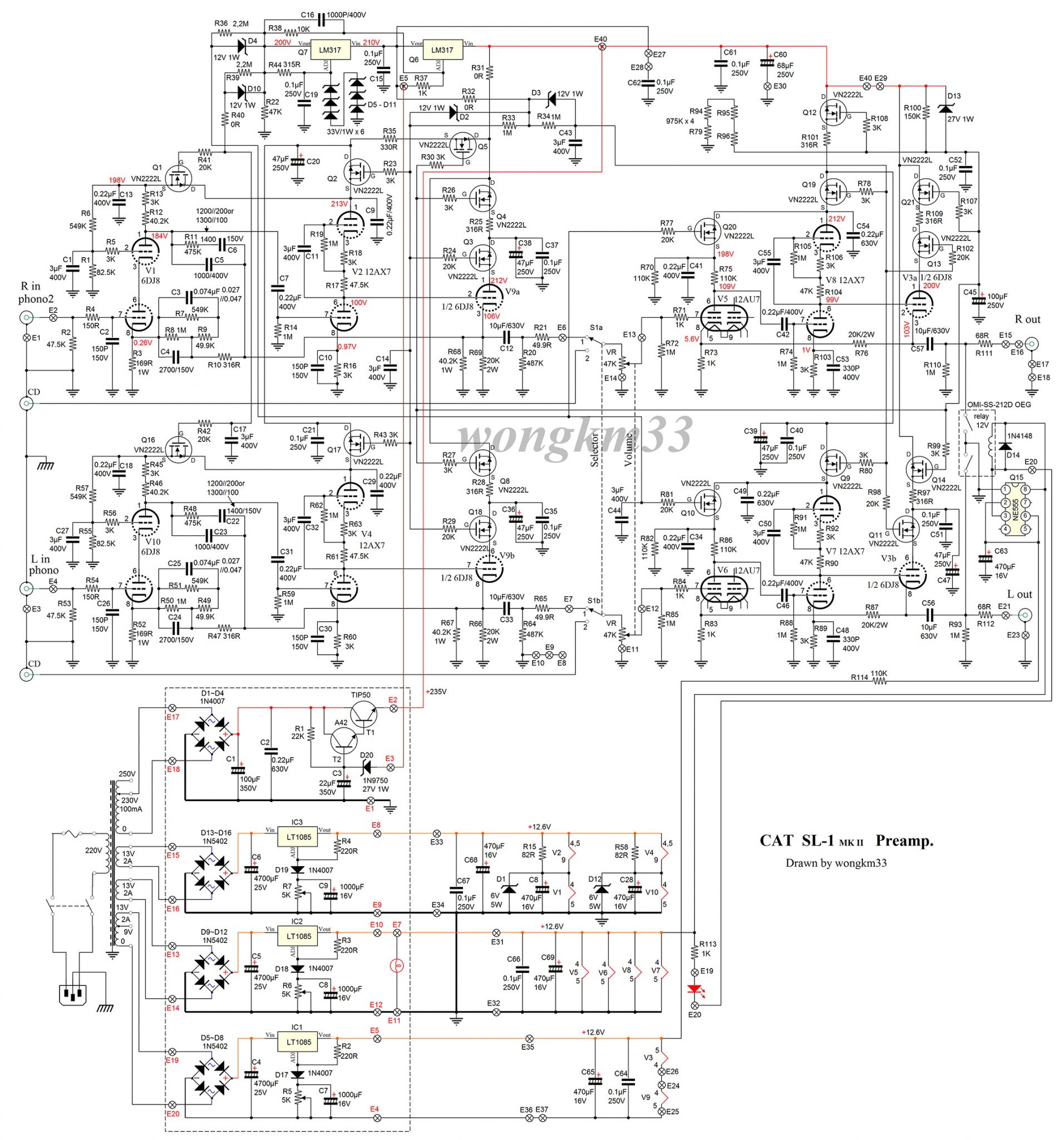

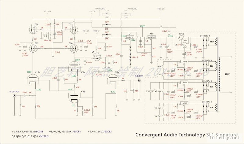

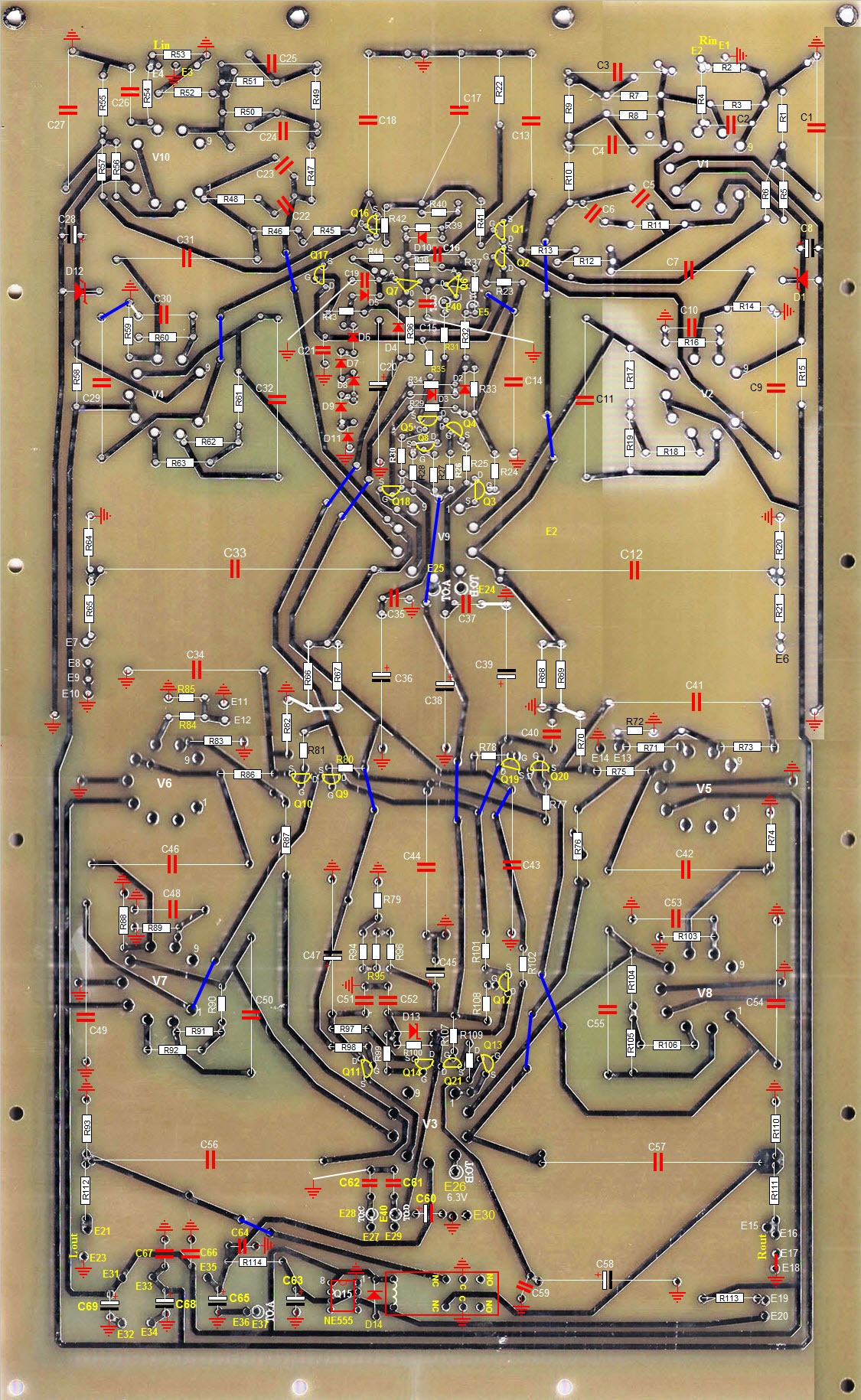

Waybackmachine managed to capture wongkm33's webpage one time, and with that, well worth details of the main and power PCB. Enjoy
