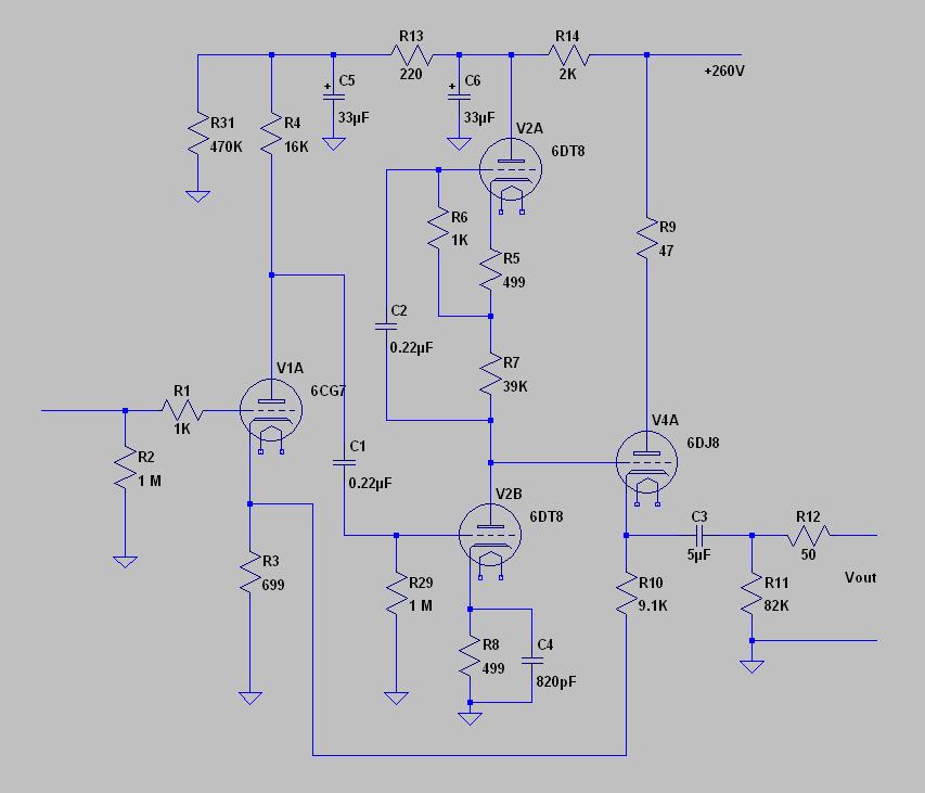

I bought one of the blank circuit boards on ebay a few years ago. This is the circuit that I used on it. It worked well and sounds fine, but I agree it is very complicated.
I really didn't think the original circuit was biased optimally, so I made several changes. I used the 6DT8 since they are similar to the 12AT7 but very avaialble and very inexpensive. I didn't need all the gain of the 12AX7.
The board required a trace to be cut or you'll but too much voltage on the heater-cathode. I used two heater supplies and boosted the top tube heaters.
I'd really only recommend this board if you want to experiment with the mu follower in a feedback loop.

I originally tried 1M at R6, I don't remember why I went to the lower value. The board showed 1K there but I made lots of changes to it. I'll see if I can find my notes.

Have you ever tried to remove C4 820pF and listen to the preamp or measure it's frequency response to see the differences with and without the C4 capacitor .I bought one of the blank circuit boards on ebay a few years ago. This is the circuit that I used on it. It worked well and sounds fine, but I agree it is very complicated.
Yes, if you remove the 820pF capacitor their is significant overshoot and ringing. Their are other ways to compensate the circuit but adding that zero in the response takes care of instability and the capacitor is already available on the circuit board.

HI,
the original circuit board design have the 12AU7 (ECC82) as the input stage while I saw it has been changed to 6CG7 on your schematic.
Anytime you do a direct coupled feedback the bias point of the input tube is critical. I chose the 6CG7 since it had a greater grid-cathode voltage at my operating point than the 12AU7 did and that allowed me to set the closed loop gain where I wanted it to operate. The voltage swing from the 6CG7 is minimal, but I have found it ot be a very linear tube if biased properly.
I never had any problem of instability or overshoot and ringing in any stage with completely unbypassed cathode resistor , IMΗO the problem is somewhere else and you can fix it with other ways , it depends on the experience of each one ( this is not a hint to anyone ) Thanks .Yes, if you remove the 820pF capacitor their is significant overshoot and ringing. Their are other ways to compensate the circuit but adding that zero in the response takes care of instability and the capacitor is already available on the circuit board.
As I stated there are many ways to compensate this amplifier, the capacitor is one of them and there was already a place for it on the board. I altered the value to compensate the amplifier as I designed it.
When you put a mu-follower in a feedback loop you have to account for the open loop frequency response. The problem is you have three poles in the circuit and and they are too close together. Other possibilities are to alter C1 and R29 or C2 and R6 and their associated components. Be careful not to get too close to the roll off from R4 either. You could rebias the input stage as well.
So what is the bais voltage of the 6CG7 tube?
The problem is not in the stage, it is in the entire loop. The capacitor gives some phase advance so the loop is stabilised.Dimitris AR said:I never had any problem of instability or overshoot and ringing in any stage with completely unbypassed cathode resistor
Yes , it is true , yet I haven't any problem with such stage even if it is in an preamp consisting of two or three stages and with the use of NFB , I suspect the way that the NFB is placed in this preamp , and other cases like the layout of the PCB 😀 .The problem is not in the stage, it is in the entire loop. The capacitor gives some phase advance so the loop is stabilised.
I don't think it is the PC layout. I know it is a result of the multiple poles at close to the same frequency.
