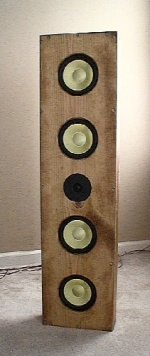

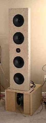

I even made a couple versions of the Phoenix, including one using ultra-cheap closeout drivers from Parts Express. They sounded awesome (photos) for the value, easily beating commercial offerings (until I burned out a voice coil, in which the closeout driver is irreplaceable). Remember, the Phoenix uses a complicated electronic crossover, so the expense is still high to build DIY versions, even with cheap drivers. How do I judge the sound quality? I have a pair of Triangle Acoustics Solaris monitors, a pair of Magnepans, and the Definitive Technology Celsius. My buddy has a pair of Martin-Logans Sequence II that we also use as comparison purposes.
IMHO, the DIY Phoenix is the best sounding of the aforementioned commercial speakers that I use as comparisons.
I also use a set of Phoenix dipole woofers to supplement my Triangle Acoustics Solaris in bi-amp configuration. Since there are very few commercial dipole woofers, DIY was the only feasible way to achieve my goals. The Solaris a high-end monitor, comparable to the other very high-end monitors reviewed in Stereophile, etc. The DIY dipole woofers are wonderful with the Solaris.

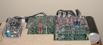

Do you by any chance have documented this project somewhere? Looks very interesting!
I used to have a fairly comprehensive website documenting the project, but lacked time for maintenance. The Linkwitz web site has a wealth of information: Linkwitz Lab - Loudspeaker Design
Linkwitz details much of the design philosophy. I highly recommend buying the printed circuit boards for the crossovers (photos below) - DIY circuit boards will cost about the same and involve a lot of work.

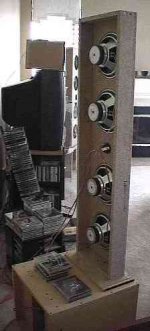

You can use Vifa, Scan-Speak, or Seas drivers with great success. Other drivers may or may not work, and may need slight modifications to the crossover components (i.e. a couple resistor values). If you choose different drivers, you may need to alter the geometry a little to maintain the proper mechanical ratios discussed by Linkwitz. I tried the Stryke 08 woofer (fiberglass), and it sounded terribly awful (photos below). There's some black art to dipole design.
I've been tempted to try a couple different types of the uber-cheap generic 8" drivers from Parts Express, just to see what happens.
For 12" woofer, you'll need something nice, like the big Peerless. I used Lambda 12" dipole woofers. Since dipoles are rising in popularity among the DIY community, there are more selections available. Expect to spend about $500 minimum for the required 4 drivers. Cheap woofers sound awful.
You'll also need three amplifiers to triamp the woofer, 8", and tweeter.
Overall, the effort payout was excellent. I can see why the Audio Artistry Beethoven got Stereophile's "product of the year". The Beethoven is about $30,000 (depending on finish and inclusion of amplifiers) and is basically a four-way Phoenix, using 8x12" Peerless XLS woofers, 4x10" Scan-Speak midwoofers, 8x8" Scan-Speak midwoofers, and 2x Scan-Speak tweeters.
