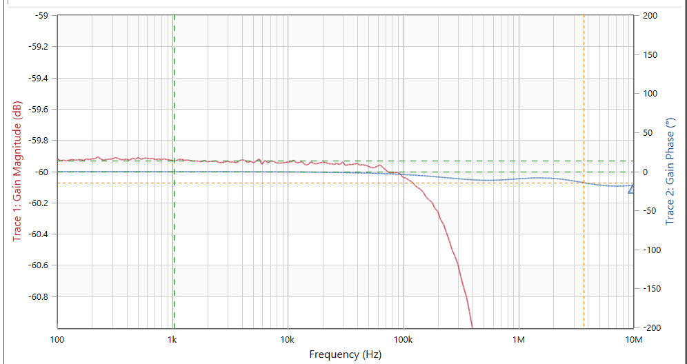

mbrennwa, perhaps one approach could be to compare a 100:1 probe, with say four dividers of different constructions - such as a 100:1 divider made from circa 0.25W resistors of 10M and a 1 Meg, and from 3M3 and a 1Meg, and another two dividers using 1-2W resistors of same resistance. The rms voltage across resistors is different, and the temperature rise is different, so may clearly show up THD improvements/differences, and then act as a benchmark for further probe comparisons.
I guess you could use REW and an RTX6001 to null any probe related residual harmonics for simple single frequency testing, but 10:1 and certainly 100:1 loopback may be the concern due to loopback noise floor.
I thought about this, too. I am a bit hesitant because I found both the 1:100 probe and the resistive voltage dividers to add harmonics to the result. So I'd be comparing two unknowns to each other.perhaps one approach could be to compare a 100:1 probe, with say four dividers of different constructions...
The loopback idea is interesting. I could use two identical probes: one for the DUT and one for the loopback. I believe most software uses the loopback to deconvolve the DUT signal from the loopback signal in order to compensate for gain, time delays, and imperfections in the frequency response of the sound card. However, the deconvolution inherently assumes a linear system, and I am not sure if/how deconvolution would play out with compensating non-linear distortion effects by referencing the DUT signal by the loopback.I guess you could use REW and an RTX6001 to null any probe related residual harmonics for simple single frequency testing, but 10:1 and certainly 100:1 loopback may be the concern due to loopback noise floor.

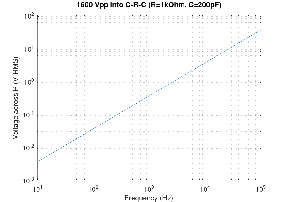

I just had a (maybe weird) idea...
So I want a capacitive dummy load of 100 pF for testing of my electrostatic amp. The bipolar 1 kHz AC output from the amp into that dummy capacitor would be up to 1.6 kVpp, or 570 Vrms(sine).
What happens if I replace the 100 pF dummy by a C-R-C series connection, with C = 200 pF and R = 1 kOhm? This modified dummy load would still be sufficiently close to a pure 100 pF load at audio frequencies. Most of the voltage drop would still be on the Cs, while the voltage across the R would be much smaller. The attachment shows the theoretically calculated voltage drop across the R. I could simply measure this voltage across R using the RTX. The fundamental at 1 kHz would be strongly attenuated, while the harmonics would be less attenuated (6 dB/octave). I could simply subtract the high-pass effect from the measured harmonics to compensate for the R-C high-pass.
I am pretty sure I am missing a few things here, and some might turn out to be roadblocks. Thoughts?

Try it and see. It's a good thought.
If you depart from a straight line, you have issues somewhere, but at least you know and can look at things from there. The only real issue I see is frequency stability. That would obviously change the impedance of your capacitors.
I would think the frequency of the fundamental (and hence also the harmonics) should be quite stable at the output of the RTX. If not, the impedance change of the caps will apply to the voltage levels of the fundamental and the harmonics in the same way, so the harmonic levels relative to the fundamental will not be affected.

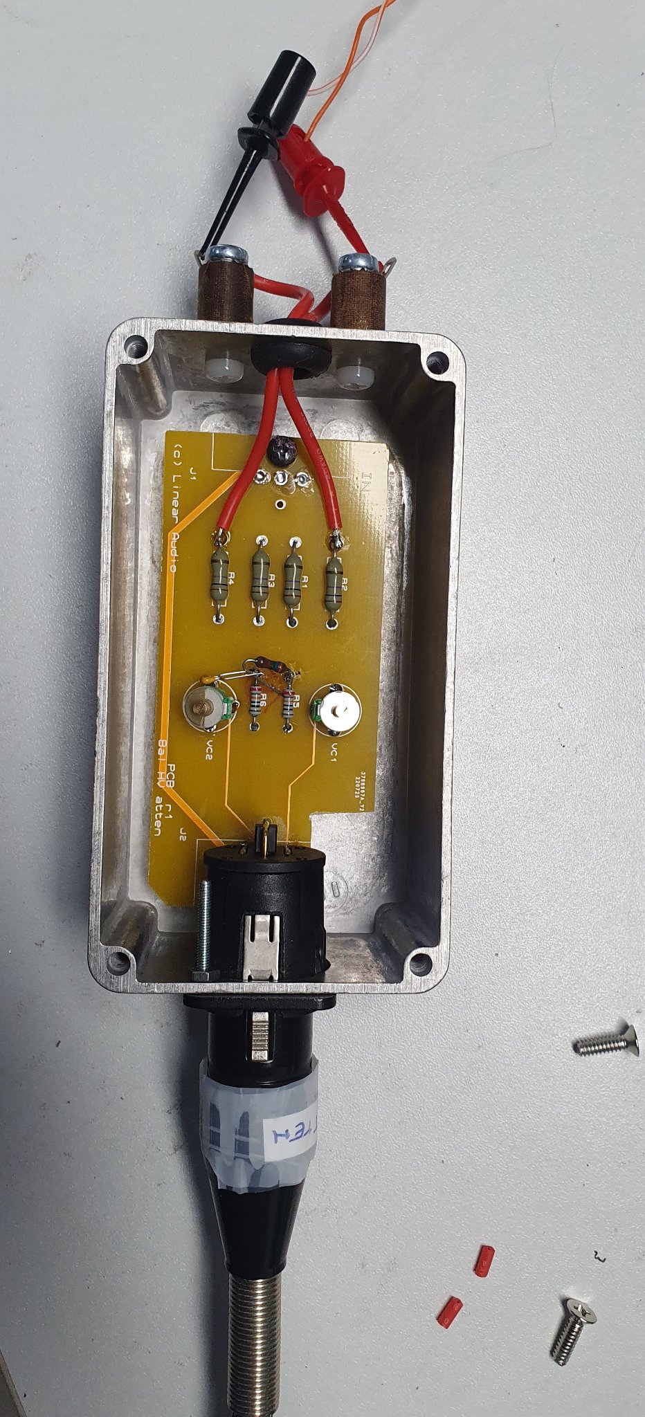

I was lucky enough to find some high-voltage 1000:1 attenuators from an HP high voltage calibrator.
It was a thick-film resistor 'plate' with a 1/1000 tap mounted in a steel box rated for 1kV flat to 100kHz.
But that was a lucky find, allowing me to directly connect the AP to the stators.
Before that I purpose-build a balanced hv attenuator for direct measuring on the stators. The trick is to design a measurmenet system.
The series element was designed with the needed attenuation with the expected load (in this case the 100k from thge AP with ~150pF).
Used a specific balanced XLR cable to the AP and accounted for the load impedance and capacitantance with some parallel trimmers, see pic.
Put a big label on the box and the cable to be sure that always the same cable was used!
Jan

Once you realize it's not audio but basic engineering, windows open up 😎

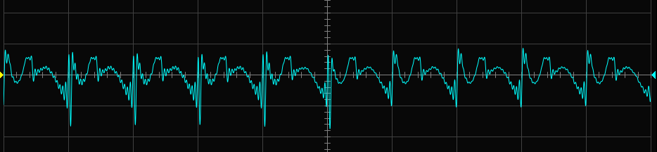

So I'd load the amplifier output with three caps in series, configured as a C1-C2-C1 voltage splitter with C1 = 0.1 uF and C2 = 100 pF? I also thought about this. But what happens with the input impedance (resistance+capacitance) of the RTX that will be in parallel to the C2 = 100 pF? This would need compensation across the C1 parts. Another option would be to connect an opamp or instrumentation amp across C2 to decouple the RTX input from C2. However, I'd like to keep things simple. Would like to avoid yet another rabbit hole if possible.A capacitive divider can work fine if the load is pure capacitance or mostly capacitance. A 1000:1 ratio with the series cap as 100 pF would have the load as .1 uF.
This is why I thought of loading the amp with a Cx-R-Cx splitter, where Cx = 200 pF and R = 1 kOhm. The 1 kOhm would be much lower than the RTX input impedance, so the RTX input would not affect the voltage splitter very much. I wonder if (or how much) the Cx would add any distortion to the measurement result.
Not sure what this refers to. Which 100k and 100M resistors are you talking about?The 100K would be matched with 100 MegOhms or essentally nothing.
This is what I see on the resistor between the two caps if the amp output is a clean sine. Looks like something is not going well with my C-R-C idea...Try it and see.
