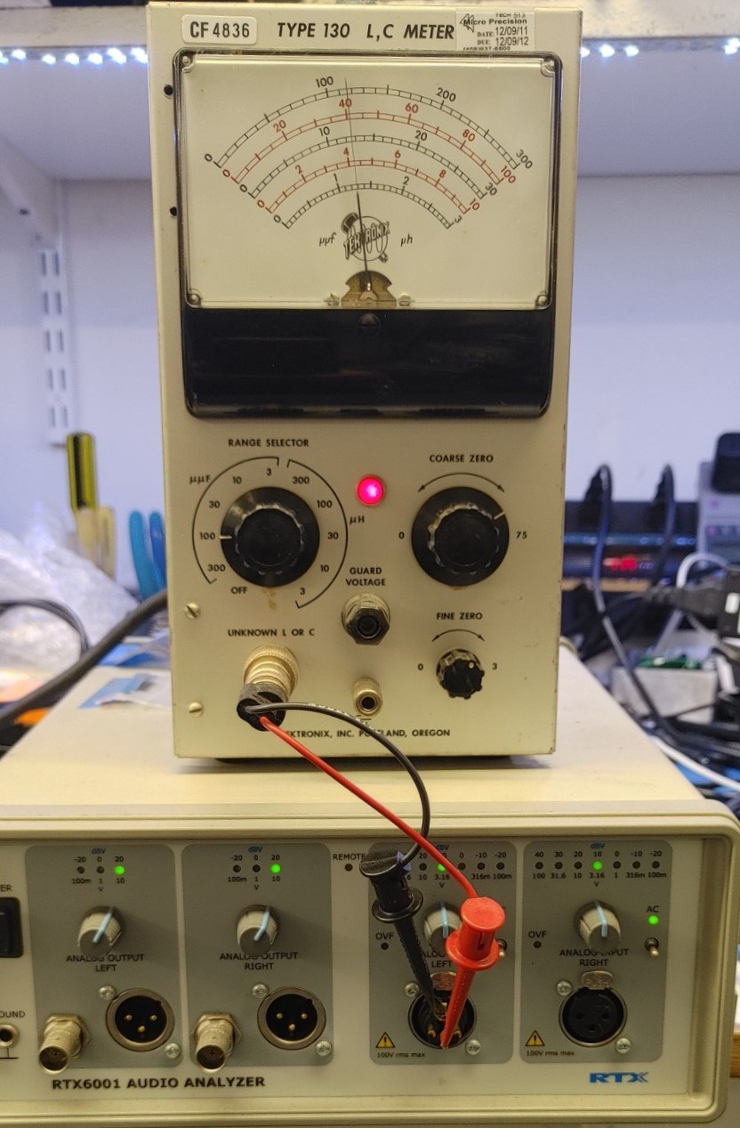

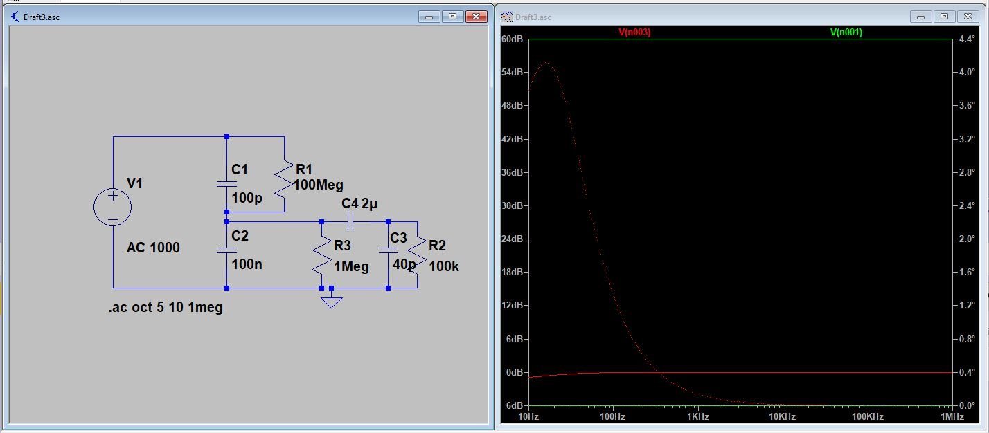

I decided to verify what I proposed. First the input C of the RTX is around 40 pF and doesn't change much with different attenuation. This makes it all pretty straightforward. The 100 pF of cap needs to withstand the full voltage with some headroom (or it could be expensive or worst lethal). its critical that the ground is connected. Also there is an input cap on the RTX which prevents a DC path to ground on the divider so any DC will transfer directly to the input. A 1 meg resistor at the output of the probe would alter the divider a little but would fix that issue.

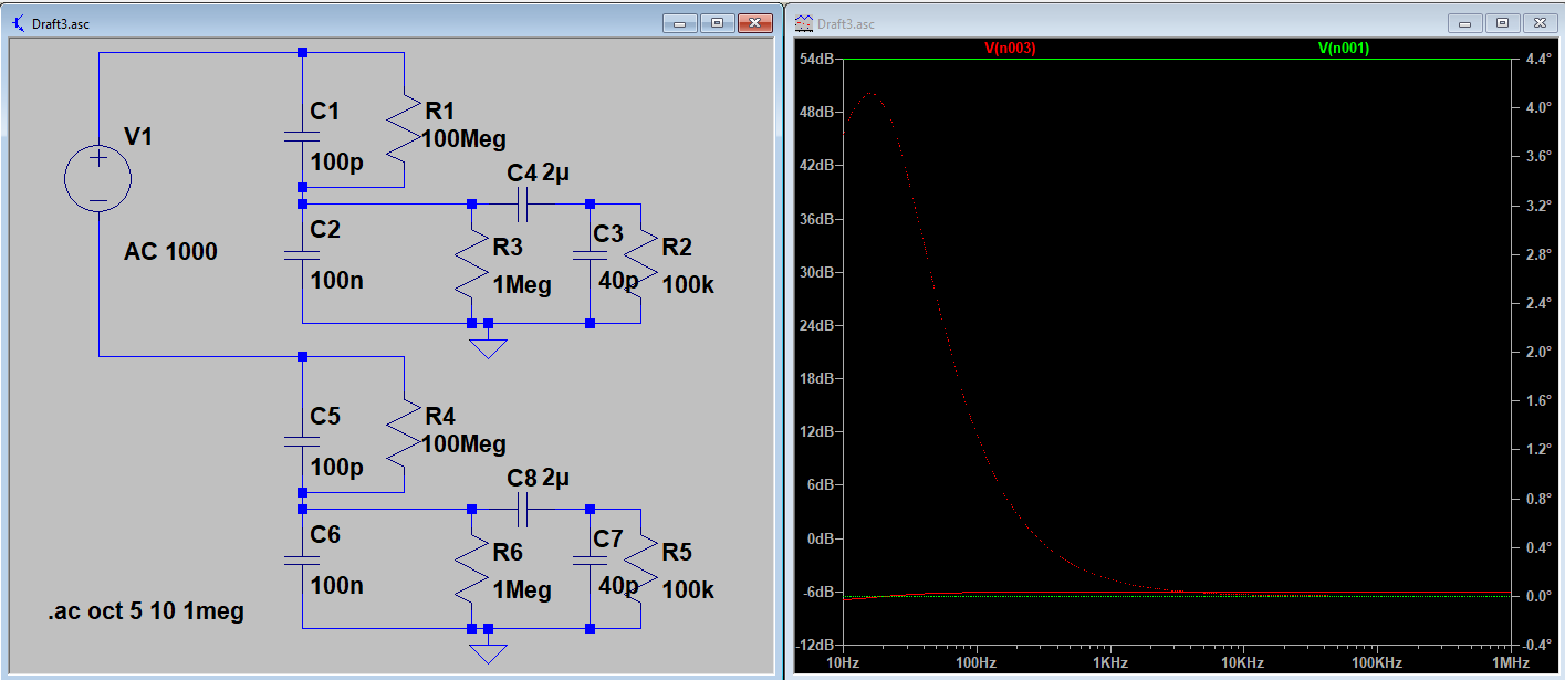

Differential application
Hmm, this does not have the amp outputs at GND, but the schematic still shows a GND. Which GND is that? GND = RTX chassis?
Also, I believe your new schematic uses two inputs to the RTX. Wouldn't it be better to use just one input in balanced/differential mode? I guess this would mean to do a C1-C2-C1 voltage splitter with C1 = 200 pF and C2 = 200 nF, and probe across C2. Similar to my C-R-C splitter idea.

Hi Jan,
At the moment I was trying to solve the measurement problem to find the cause. Period.
You are correct that a balanced signal does not require a ground, however since the input of any device that isn't 100% isolated from "ground" may have a common mode problem, you cannot ignore the possibility.
