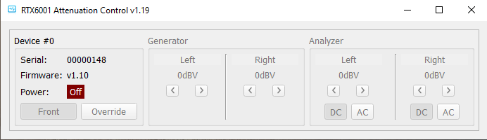

If you install the Attenuation Control Application you can check the current firmware version. If it is already V119 all is fine. Otherwise I recommend that you update to the V119.

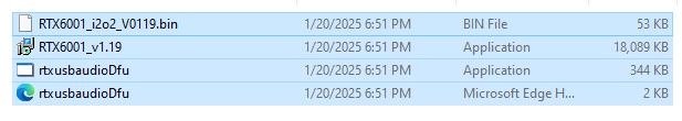

Hi again, do I have fw v1.10 or v1.19?
If 1.10 how do I update? Just run RTX6001_v1.19?

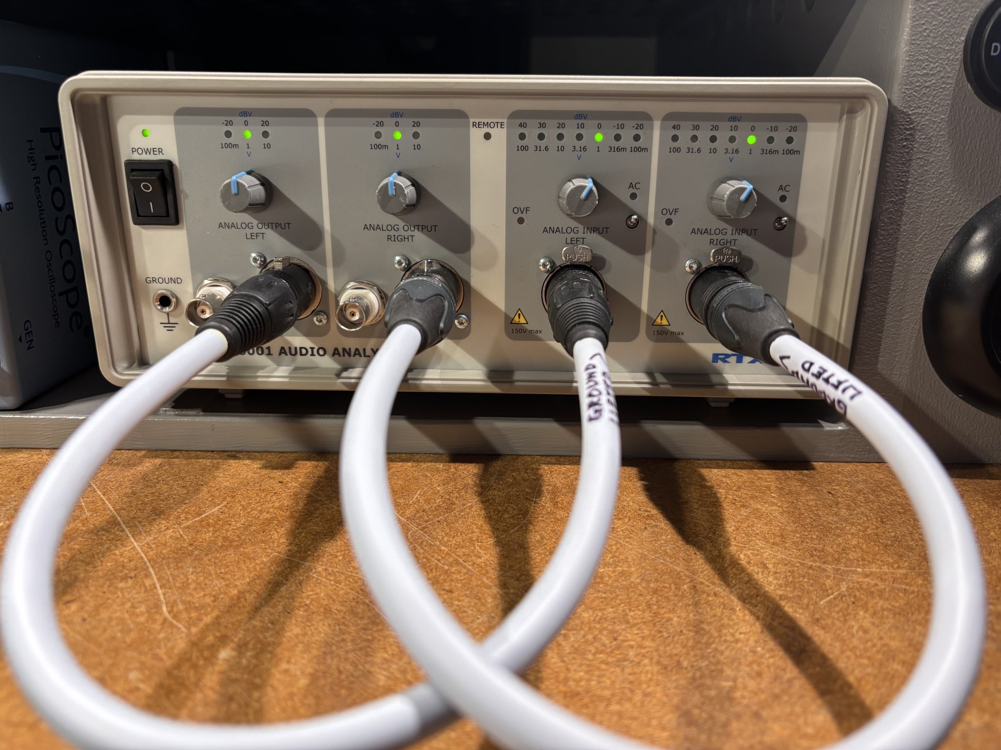

Cabling. What cables do you use for the 6001?
Loopback: Common XLR female to male?
Output: XLR Female to whatever is on the DUT for balanced and BNC to whatever is on the DUT for SE?
Input: XLR male from whatever DUT provides for balanced and XLR male with pin 2 to plus and pin 3 unconnected from SE DUT or do you use some kind of line transformer or SE to BAL converter?
It seems like your unit has firmware V1.10, so you should upgrade to V1.19.
Run the rtxusbaudioDfu.exe, select the RTX6001_i2o2_V0119.bin and let the program finish the update.

I just use XLR to XLR for loopback testing.
Jens, thank you for the RCA to XLR wiring. I'll make a set of cables, it will probably reduce mains leakage in the readings. I bought audio isolation transformers, but even the expensive ones add distortion.
