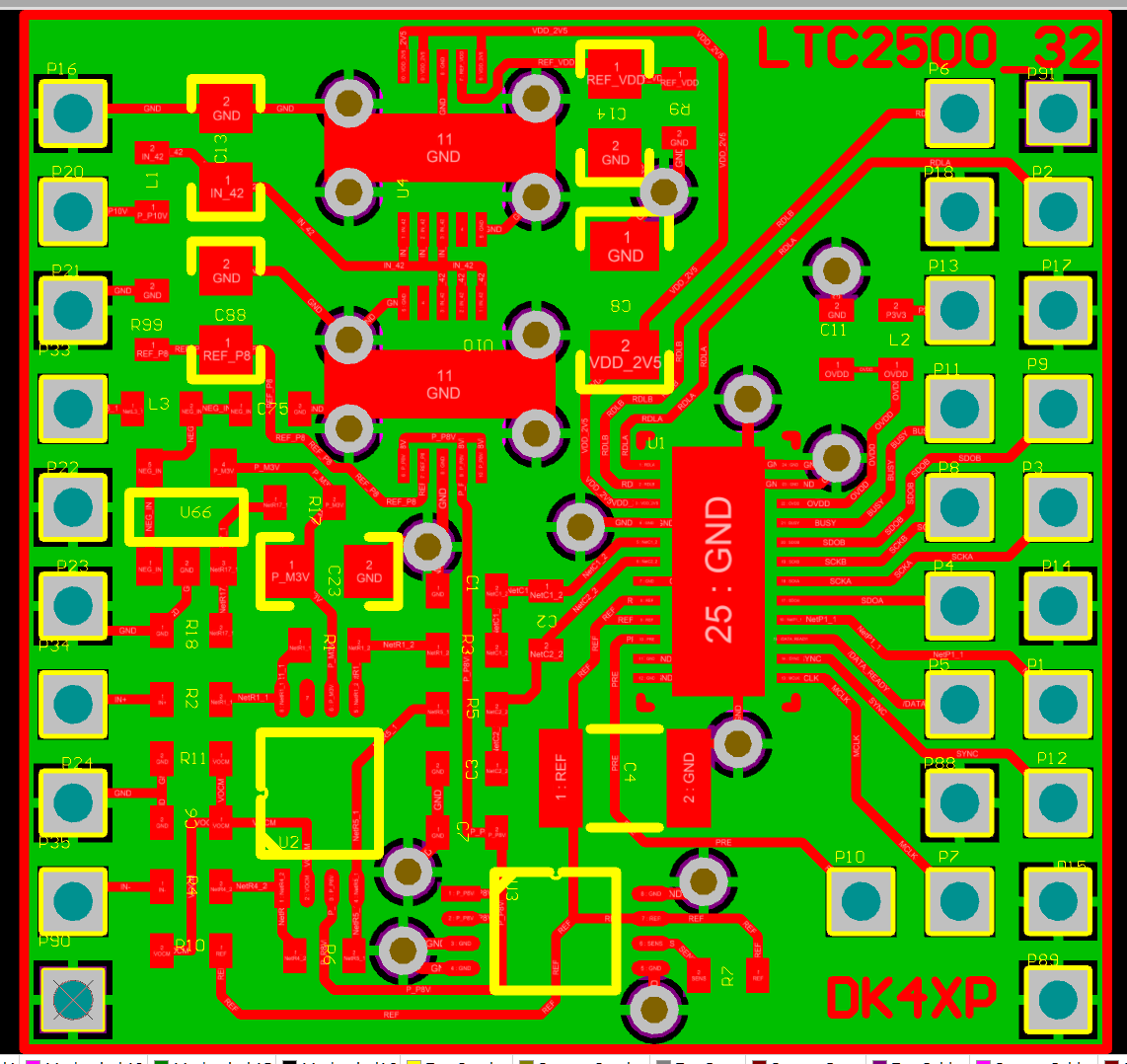

BTW I got this week the first LTC2500-32 ADC and made a layout for it.
It is just 1" * 1" and has 2 LT3042 regulators for the pos. voltages, a low drop
for the neg. voltage for the buffer, the buffer, the ADC and a LT6655 reference.
I will use the SPI interface to connect it to a BeagleBoneBlack.
The sample rate generator will be another stamp-sized board.
This is still highly experimental, far from a cooking recipe.
cheers, Gerhard

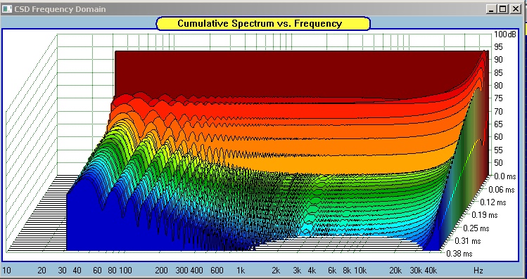

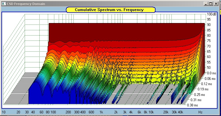

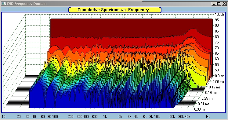

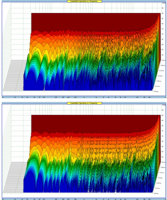

I tried their HiFicable & ASIO bridge using babyface pro running Win7 on. MacBook Pro boot camp, running through this setup is noisier than running directly through the MME driver directly.
Comparison of the two:
This is what the Babyface Pro looks like on the XP machine
This is the Echo Indigo iOS on the XP machine
This is an example of what happens on the Win7 with output at 48KHz and input at 96KHz set in Windows sound devices:
Possibly the sound engine has some compromises in that implementation. Typically truncation without dither or sample rate conversion. I'll fire up the hifi cable and try a test or two. In my system with 5 asio drivers it gets really confusing fast.

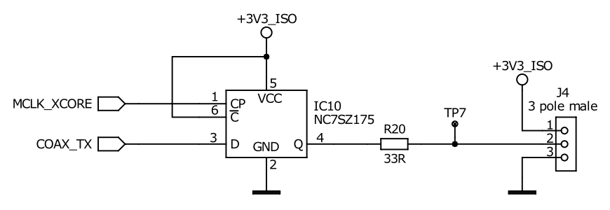

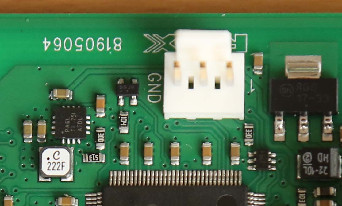

After 300k views on this thread perhaps it is time for some additional info about the RTX6001.
Some users have asked for the possibility of adding a digital output. I now have the possibility to reveal some new information regarding this.
I am a bit surprised that, at least as far as I know, no one has been curious enough to investigate what the small 3-pin connector on the USB interface was intended for 🙂
It is actually a (CMOS level) SPDIF signal! It is a digital version of the audio sent to the DAC. With a couple of resistors and a capacitor it is possible to get a SPDIF output. The 3-pin connector is electrically connected to the PC so I suggest to use a transformer as well, to isolate it. And I also suggest to keep the output isolated from the chassis of the RTX6001 to avoid ground loops.
A 220 ohm resistor in series with the output from the USB Board and a 110 ohm resistor in parallel with the SPDIF output connector will get you close to the recommended levels and impedances for SPDIF. Or perhaps 210 and 107 ohm if you want to fine-tune the impedance, assuming that the transformer will also contribute a little to the output impedance.
SPDIF is simple to make. But it is also possible to implement an AES output or a Toslink output. A 3.3 V supply is available on the connector, so no additional supply is needed. A schematic of the output circuit and the connector is attached. As you can see, the output is clocked by the master clock of the analyzer. The clock goes through the isolator, which does add some jitter. Since the clock comes from the crystal oscillators on the Main Board of the analyzer, the unit has to be switched on to activate the output. Otherwise non-standard frequencies would be sent out, which can be confusing.
GND and pin 1 are marked on the PCB, so with the schematic it should be fairly easy to get the connections right.
A simple way to implement it is to use a thin coax cable (for SPDIF) and take it through one of the slots in the rear plate.
The modifications are DIY only. RTX does not deliver any boards or provide any other support in relation to this. Be careful when working on the interior of the RTX6001. First of all, you must of course disconnect the supply. And avoid damaging the unit. Otherwise the warranty may be void.
