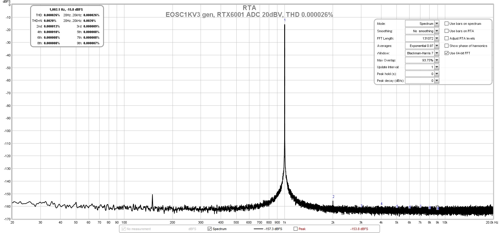

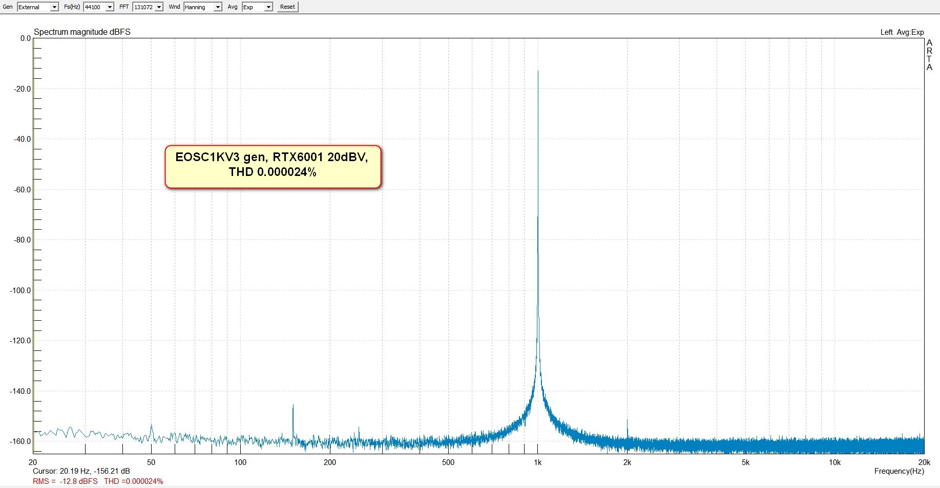

For the measurement in post 2254:
The settings: output 0dbV, input -20dbV
Loop back connection: BNC out - RG58 coax BNC cable - Neutrik BNC-XLR adapter on the input.
No signal playing (but with a 1kHz xdB signal present the hum part looks alike).
FFT settings in audiotester; Rife-Vinc3 window with 131072 points.
Sample rate 96kHz.

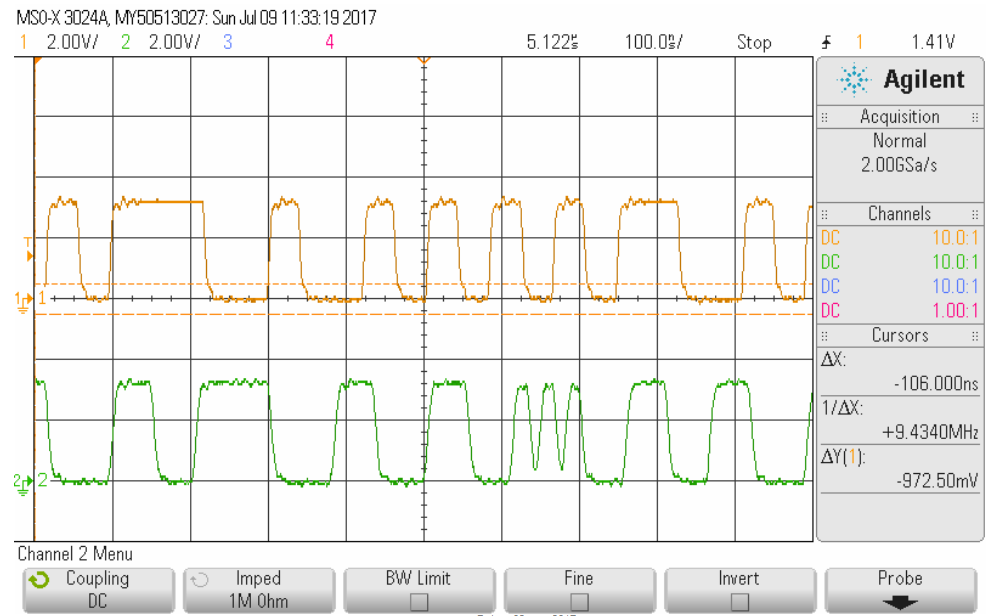

I have attached a measurement I made with 16 Mbps transmitters and receivers, Everlight PLT133/T9 and PLR135/T9.
Channel 1 is the input to the transmitter and channel 2 is the output from the receiver.
Most of the bits are transmitted correctly, but suddenly the received signal oscillates, just to the right of the middle. No receiver can be expected to decode that.
