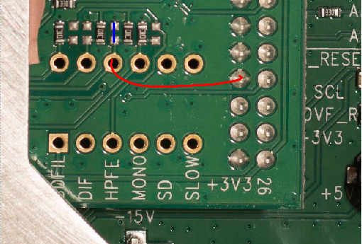

Jens: Let's assume I want to find out how this works simply by trying it (and voiding the warranty by doing this). Will grounding the DAC HPFE pin to GND upset the functioning of the electronics in any way? Will it cause a short, burn a part, or similar problem? I don't have a schematic of the involved circuitry, so I am "blind".
Grounding the HPFE pin will not "upset" the functioning.
If you insist, this is the way you can disable the high-pass filter. Either mount a 0 ohm resistor along the blue line in the picture or mount a piece of wire along the red line.
This is not an authorized mod, and any unauthorized mod will void the warranty.

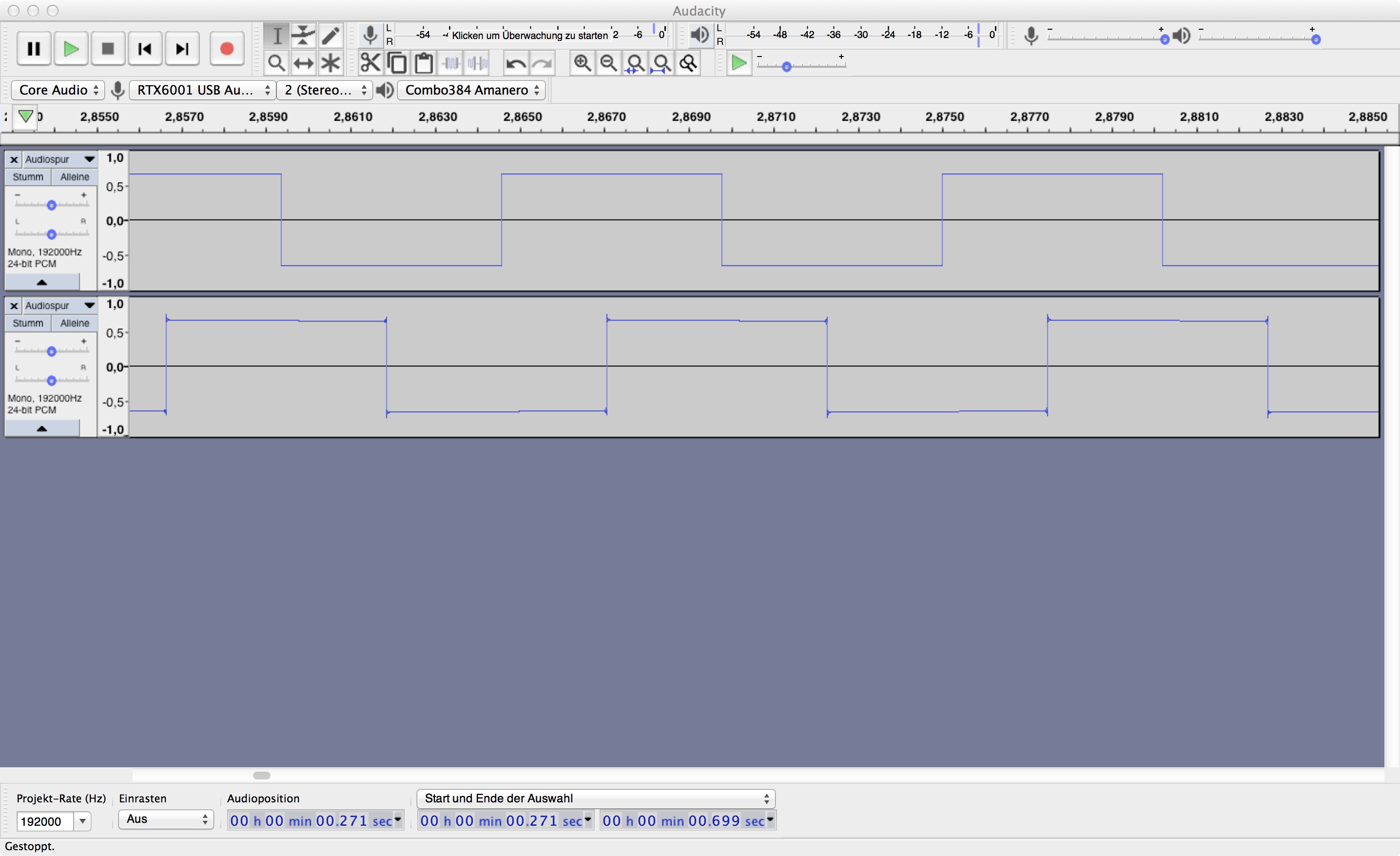

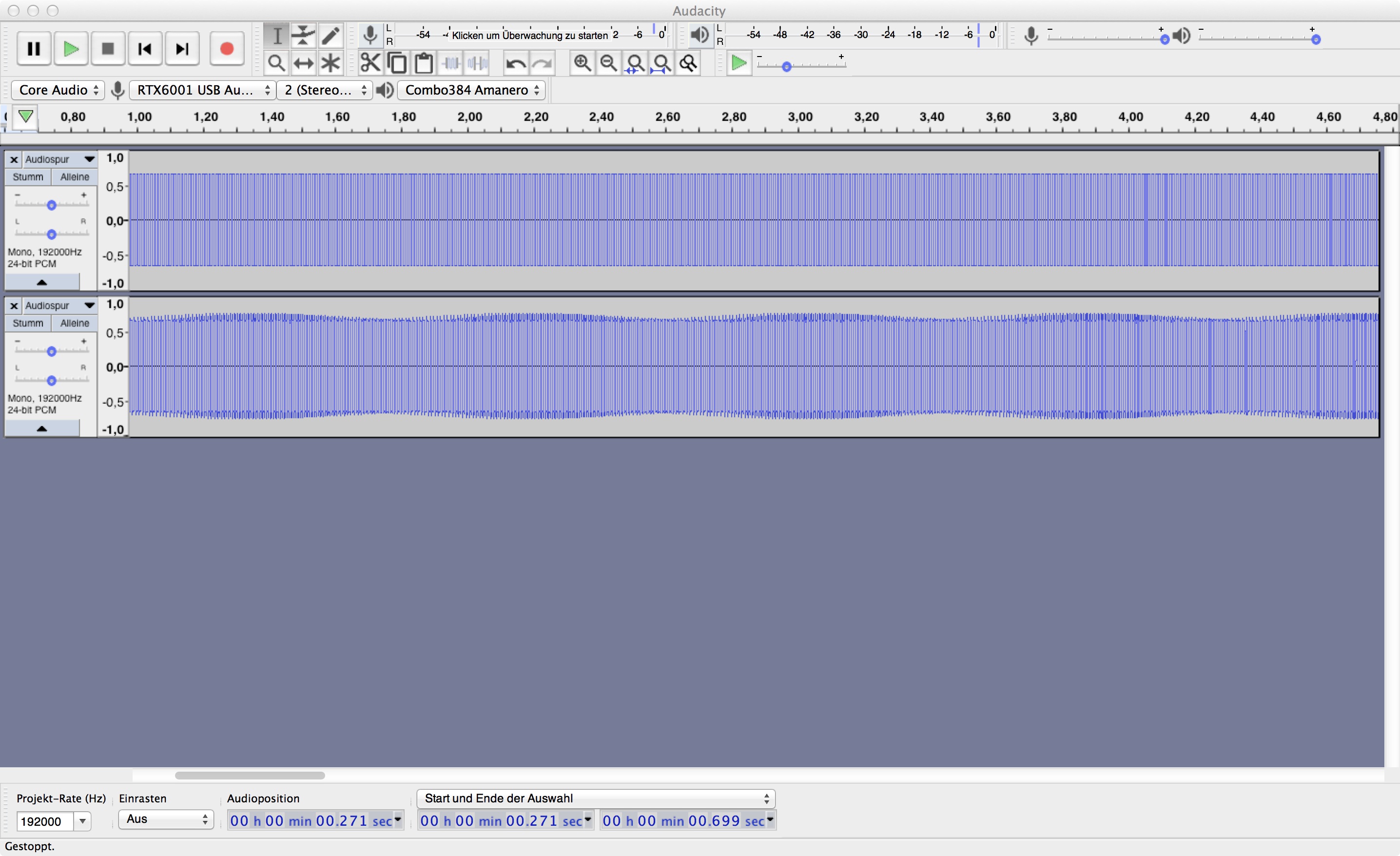

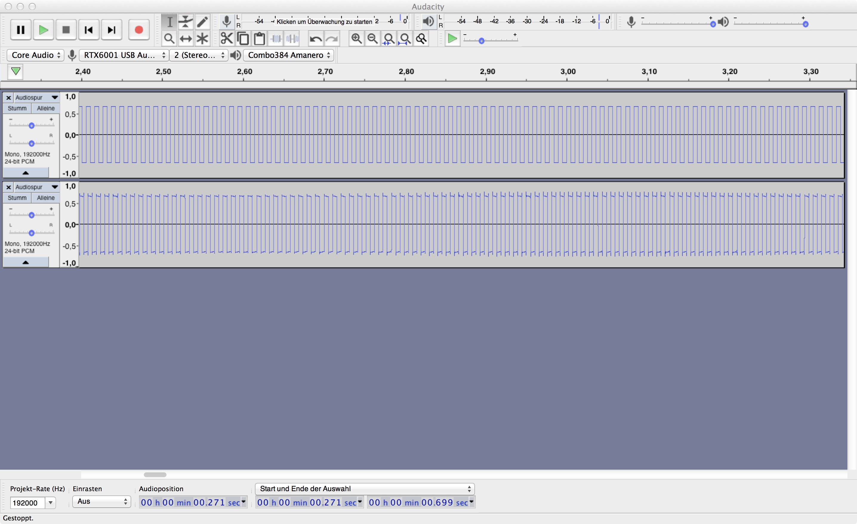

To get rid of the controversial topic "DC offset", here an example without DC offset where you see an effect of the low pass filter: A 96Hz square wave. The amplitude even visibly drops slightly inside a square, instead of being constant.
I used as source the Soekris DAM, if it does one thing next to perfect its square waves, when all filters are bypassed. This avoids additional effects of the filters on the DAC side.
Moreover there is a funny oscillation in the overshot, but I thing this is due to slightly different clock rates and therefore in the amount of hitting the quite sharp overshot.

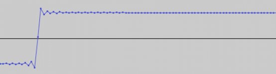

The "overshoot" is probably ringing from the digital filters of the ADC. If you zoom in to get a better resolution it will be easier to see it clearly.

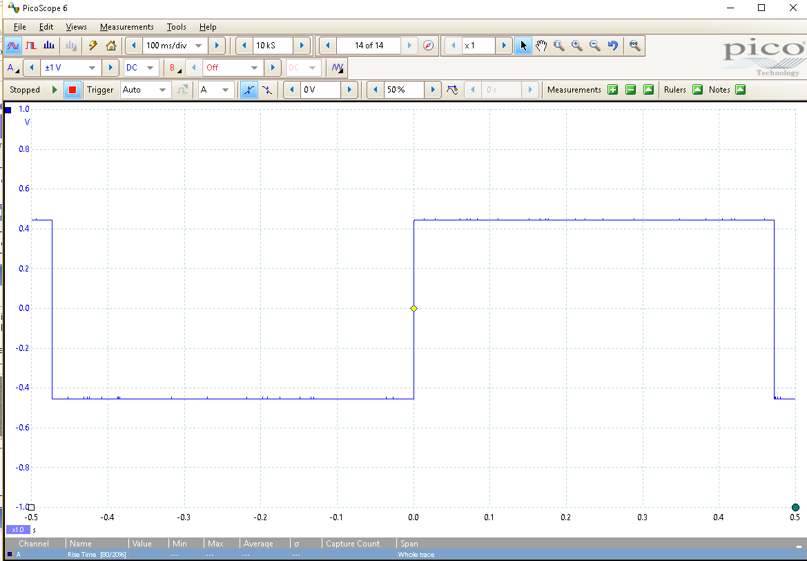

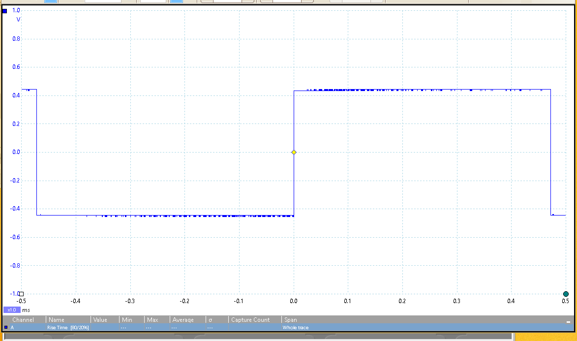

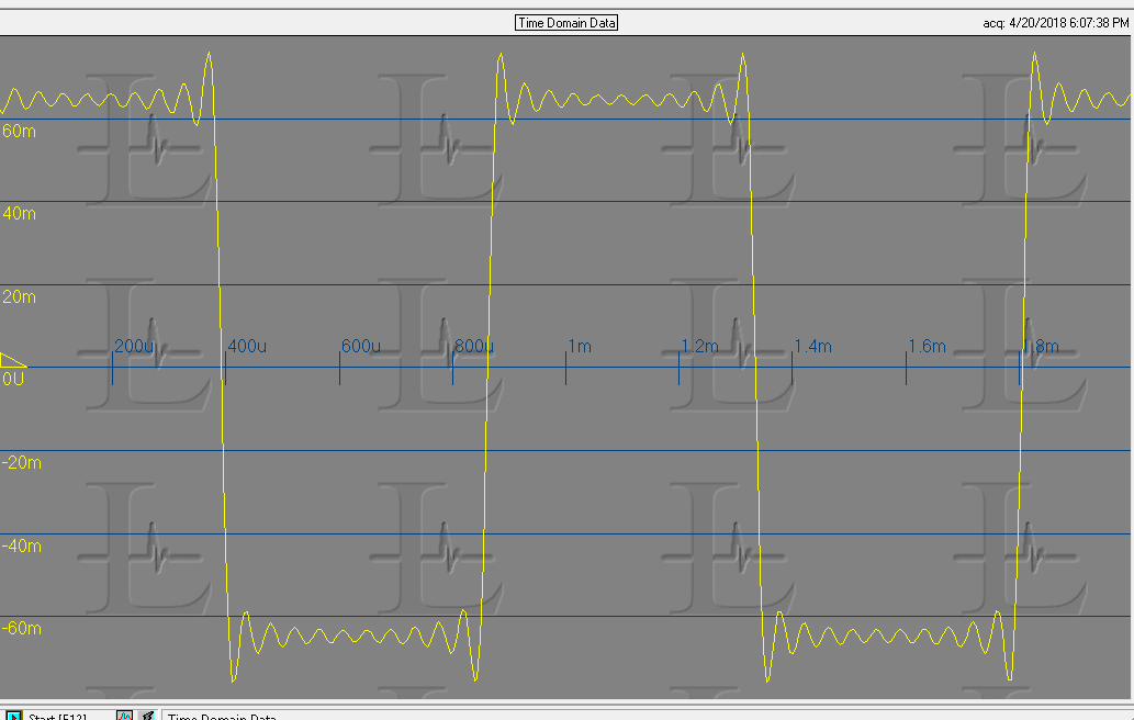

The ringing is I believe called Gibbs Phenomenon. Attached are three pictures of a square wave from a very fast rise function generator (Krohn Hite 2200). First is a 200 MHz Picoscope. The actual measured rise time is 6.5 nS, no ringing. Second is the ADC of the RTX6001 at 192 KHz. Third is the ADC at 48 KHz.

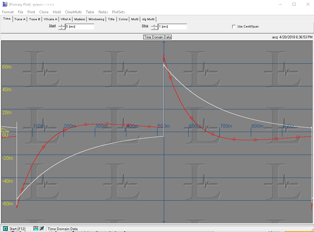

What you are seeing is the effect of the anti-alias filters. Then a 1Hz square wave through the DC coupled scope. Finally the same 1 Hz into the RTX with DC (white) and AC (red) coupling.
Nothing here unexpected.
Personally I find there are few situations where a scope is the right tool for DC measurements.

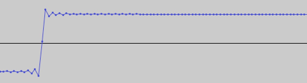

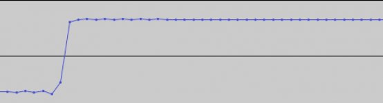

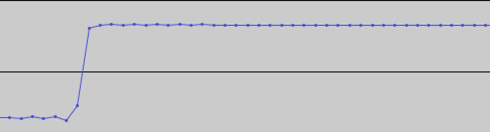

First I did a "typo", I meant you see a effect of the high pass filter without DC offset - the drop of the amplitude of the rectangle.
To the overshot: I do not claim the overshot itself a problem, I know it is the normal effect of the bandwidth limitation of the ADC. I only mentioned it as there is the funny effect that there is an oscillation in the magnitude of the overshot of successive rectangles (second picture on my previous post) or even more zoomed out here.
In my tentative explanation I used again a wrong word. I thing it might be explained in the different amount captured from the rising/falling flank of the rectangular wave due to clock differences of the DAC and ADC.
The oscillation is due to aliasing caused by the (low) resolution on the screen compared to the resolution of the measurement.
No. If you zoom in (or look at the numerical data) and compare you see it is reel.
That could be. So this is probably due to the phase of the input signal relative to the sampling of the ADC.
Looking carefully at the second plot from Demian in post #2205 there does seem to be a small difference between the two cycles also in this case.
