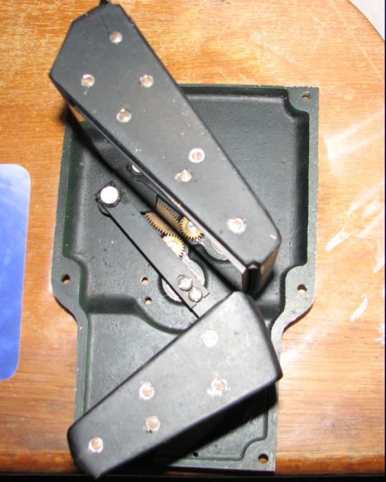

Great photo's, thanks for sharing... now I wonder the size of each of the wedges... could I bother you to measure thouse? Might have to order me some of the smaller ones...
Budd you still have the small ones working eh?
(Budd, we've got to get together! In-laws are gone and your intro is ready 🙂 )
Some more question...
Yeah thanks for the pics.
It looks old based on the prisms case castings. Do you know what year it was made, or who made it?
I can see the chip you were referring to in the front prism - a real shame. Cab you still use it or does it affect the image?
Please measure and post the prisms sizes as well as the distances between them. Could you replace those prisms with the J series prisms?
