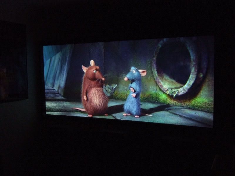

Got yours up & running? How bout some pix!
Bud
Bud Bray said:
Your sides are cut off....THAT's CHEATING! There is space on the left beside the pictures, see my posts...
But you don't seem to have the ghosting...RATS!
Give me hope I can fix mine(but your sides ARE chopped off)
Bud
RATS? Here are some rats...
I can only work with what I have from the projector. This unit does have at least 5% overscan which I identified with the overscan pattern on JPK DVE...
