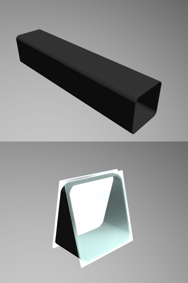

The idea with using square plastic pipes as frames for the prisms is a very good one. But you need to make sure you use a plastic that can be glued. I dont think PVC can be glued with normal Epoxy glues but I'm not sure. There's only one sure-fire way to find out. 🙂

BY THE WAY.... I'm still very curious what this PVC tubing is all about. Can someone at least describe to me how this tubing is used to house the prism? I just can't picture it in my head.. again, all I can see in my head is pvc sprinkler tubing.. even a large enough piece of that, I don't quite get how it could be utilized...

Regarding the PVC-tube:
Imagine a square crossection pipe with a width of 10cm. If you cut it at the right angles you end up with a plastic frame for the glass.
I made a simple illustration.

that's a great idea... Thanks for posting that illustration, Tor. Now, it's obvious and I should have been able to picture this... In effect that is very similar to some of my original ideas but even better!!

I went to a Home Depot/Lowes today and although I couldn't find tubing wide enough, I have some new leads. I'm convinced the tubing idea is THE way to go. (after reading posts by Tor and rwhitley)

I will be picking up some 5" "fence tubing" today, and will be cutting it over the weekend. Won't be able to glue glass to it until the following week after Thanksgiving, but I'm pretty confident in the idea. Seemed to have worked the first time for Rwhitley. My current working model will be retired as I made the sides from glass and would prefer a solid plastic w/ flat color to block any unecessary light spill. Also, I believe you can block the 'fill hole' with a screw which I'd like to have attached to the prisms for ease of changing the angles, and attach to a frame. You can't put a screw in glass to my knowledge.
