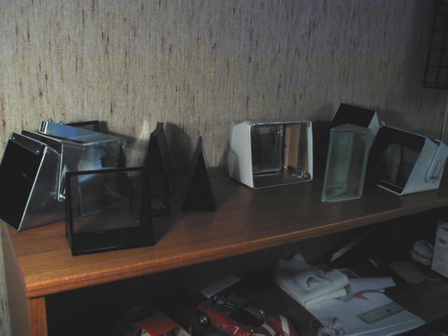

This lens offsets the picture vertically by a few inches. The lens can be used right-side-up or upside-down but it looks better in one of the orientations. I think the picture is offset downwards when the projector is ceilingmounted. I don't remember for sure, it's been so long since I tried it.
There are four housings (see attached picture) and ten different prisms on my shelf right now. The ones glued with silicone sealant have not leaked yet but the ones glued with epoxy leaked a lot.
