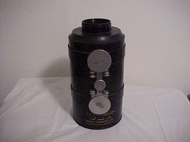

I am crap at glueing things - especially where liquids are concerned, so I went and bought a cinema anamorphic projection lens cheap off Ebay.
I'm crap? Yeah, but I found out something interesting:
Your issue about focus shift between top and bottom is something the designers of this lens faced, and they solved it by having TWO sets of corrected prisms.
Yup, there are two identical prism combinations in my apparatus (each a prism doublet corrected for chromatic aberations) - the first set shifts upwards, and the second set, arranged upside-down, shifts downwards again.
The trick is to angle the two sets so that the shifting and compression is even in both directions (up and down) and thus the image is largely undistorted. Each prism only provides half of the anamorphic compression, resulting in a really nice image.

Hi Tor,
I don't exactly know the details. It was sold as a "Hilux" and adjusted for a 200ft throw, but other than that I don't know more than I can tell from simple observations.

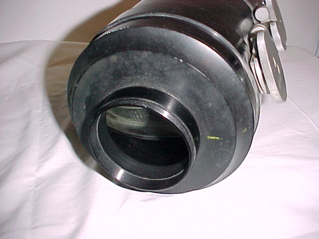

It doesn't have any lenses as such - just the two sets of prisms. It is about a foot long and four inches in diameter (obviously not intended for a very wide-angle setup), and on first tests produces a very nice image on my wall despite the fact that it needs a real good cleaning. (I'm also going to put a tripod mount on it so that it is fully compatible with my OHP-style optics.)
I manually tweaked the angles on the prism sets until they were balanced and gave the appropriate compression, and sat down to enjoy The Matrix...

no, more like this:
