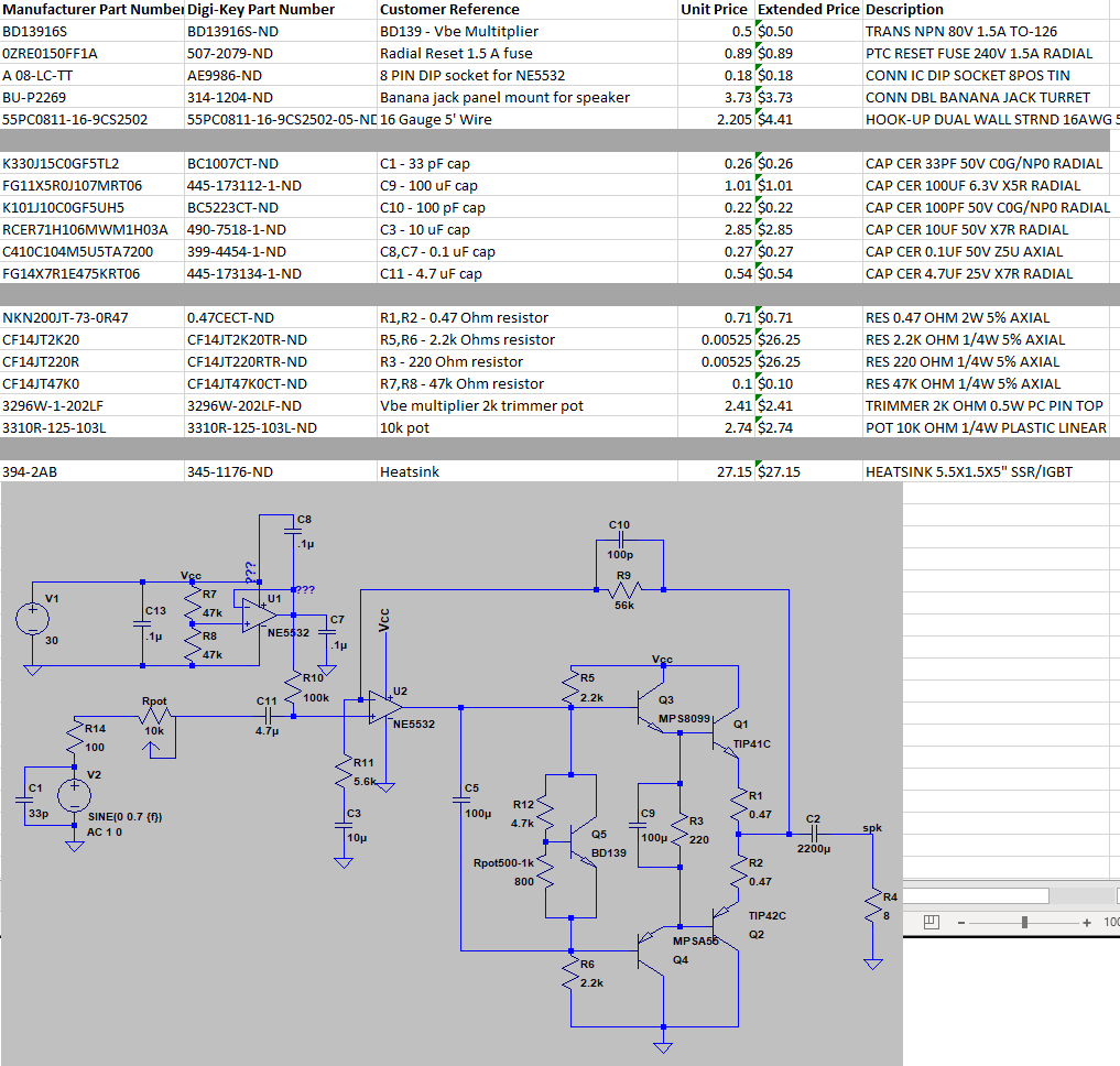

Awesome. What do you think about this? I chose all ceramics, except for the 2200u at the output. Is there a general rule of thumb about when you can get away with electrolytics? I'm still fuzzy on that. Anything not in the BOM is something I can easily get at school or I have at home, even some of the resistors I have I just thought I'd get a few extra.actually 345-1176-nd digikey has 1005 stock of. But the natural air resistance is 1.5 degC/w so it is not that much better than the one you picked out. I was tricked by the forced air number too.

Notice that I screwed up on two of the resistor ones, must have selected the minimum quantity 1000 option, but I'll fix that. Pic attached, and the xlsx as well, for easier selection of the digikey number.

BOM looks mostly good. You may exceed the voltage on the 100 uf 6.3 v ceramic cap & blow it up. NP electrolytics go higher voltage, like 50 or 100. I can't believe 4.7 uf ceramics are $2.49 now, last time I ordered some they were $5. Lots of people on here sneer at ceramics in the sound path. I think the speakers cover up all that little distortions. I'm using ceramic as the input cap to my 6 hour a day amp, but a COG 50 v one which should be more linear at 1 vac signal than x7r dielectric.
You're missing the zobel network on the output, which keeps your speaker from acting as a radio antenna and injecting RF into your amp. 10 ohm 3 W resistor, parallel 14 turns wire around a AA battery or suitable non-metal form (dowel rod, china marker). You'll need to order the 10 ohm resistor.

EDIT: Here's the 10 ohm resistor, I'll put that in. need to look at what a zobel network is one second.
EDIT2: So I looked up a zobel, I see usually it's done with a capacitor, does it matter in this case? 14 turns around any nonmetal/conducting "rod-like-shape" seems to be the inductor in series with the 10 ohm all in parallel with the speaker, correct?
I may have the name wrong. A network is put in series with the speaker. It is a 11 to 14 turn inductor, parallel a 5 to 10 ohm resistor. It is located as close as possible to the speaker jacks to keep the RF out of the enclosure.
Okay cool, I'll put that in simulation and will check it out.I may have the name wrong. A network is put in series with the speaker. It is a 11 to 14 turn inductor, parallel a 5 to 10 ohm resistor. It is located as close as possible to the speaker jacks to keep the RF out of the enclosure.

You can't buy cheap inductors of a defined inductance. I believe you said you were going to wind 22 turns around a toroid on your power input or something? I had in mind a big coil part of a old TV tuner I am parting out, but picking up one on the street is now non-productive because of the $10 disposal fee on the CRT tube. I put a 22 turn choke out of a PCAT power supply in my disco mixer to kill all noise coming in on the DC line. Followed by a 1000 uf cap, a 1 ohm resistor, another 1000 ohm cap, for a pi filter. The addition of second stage cap finally got rid of the hum. For a power amp, you'll need more than 1000 uf filters on the DC input, I imagine.
