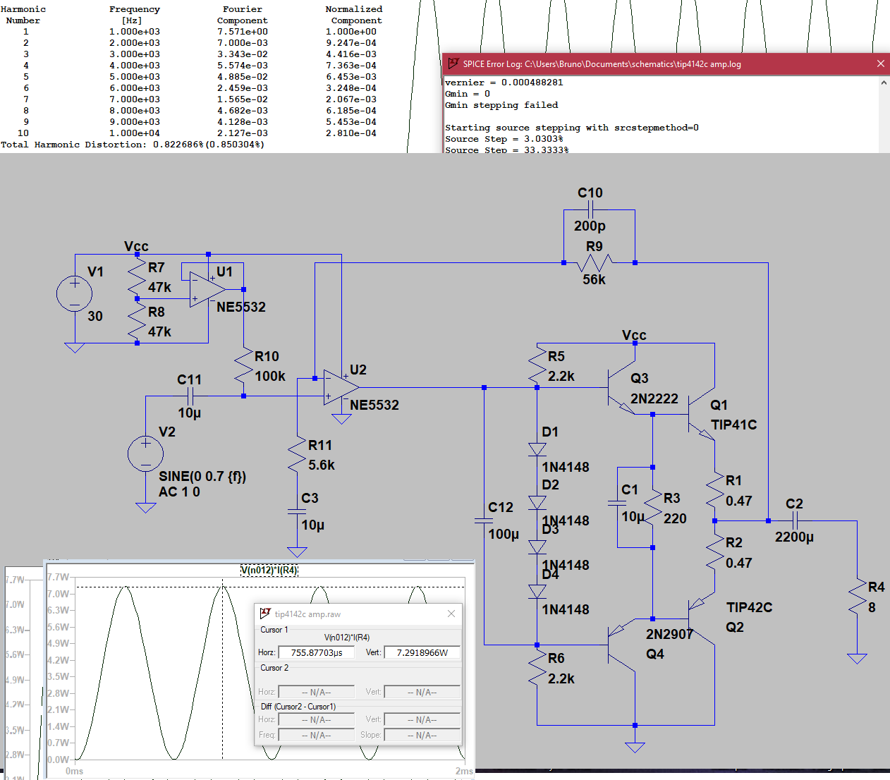

One thing is gain on U2 is Rf/Ri and I think your Ri is zero. R13 & R15 are some sort of ground reference but I think you need a Ri from + to C14. Say to make gain on U2 2 or less.
I also suggest you have a better ground reference than R13 & R15, either a center tap to a transformer, or a 15 v regulator from the 29 v rail (24 v *1.4)-1.2v . Then that could go in the middle of R3.
spice knows how much junction capacitance is in transistors, the peak current from a power transistor like TIP41 should be pretty high turning off. Why one uses smaller transistors with less BE capacitance for drivers.
Q3 Q4 Q1 Q2 are just current boosters, you'll get no voltage gain out of them. The op amp can swing voltage wise as much as 0.5*vcc - a couple of volts, that should be enough to drive a speaker. Current drive on Q3 & Q4 is mostly R5 & R6, the op amp just steers them from the middle.
Gain 8 on U1 is probably fine, 2 vac out of phone/radio, * 8 is 16 v swing, less about 1 for diode drops, 28 w like I calculated above.

Because you have gain of infinity on U2, no wonder the output is banging between the rails from the feedback.
I'd say delete U2 as a signal component and use it as the center voltage ("ground") driver. Make it unity gain (no feedback resistor, output to minus pin) and connect plus to the 47 k voltage divided from +29v and - rail. Bleed in from a high resistor input the input.
Then run the feedback from speaker cap input to a mixing point at inverting pin of U1. Connect output of U1 to the bases of the drivers. That is how Peavey does it in the PV-4C. They bypass the feedback resistor with a 10 pf ceramic cap.
BTW 2n2222 2n2907 have low enough capacitance to be driven by a 5532, but they are noisy little switching transistors. mpsa05/55 are amplifier transistors. If you Private Message your US mail address, I'll send you free five pnp mpsa55 I paid $.024 for and five mps8099 I paid $.082 for. If you can't find a simulation model for mps8099 use mpsa06. Or mpsa06, mpsa56, models for both, those are higher voltage (80v) versions of the mpsa05/55 (60 v).
c3, c4, c5, c6 as power supply bypass caps should be 0.1 uf or at least 0.01 uf ceramic. And they don't connect pins 4,8 of op amp to the supplies, they parallel the supply inputs of the op amp.

Okay, I think I'm finally getting somewhere. Take a look at this:
Max current drawn from voltage source: 960 mA
Feedback resistor: LP -3dB Point at 15.7k Hz with 56k and 200p
Inverting input resistor: HP -3dB Point at 2.84 Hz with 5.6k and 10 uF

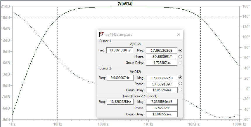

Let me get up a mag response. I'm also remembering you want me to change the drivers from the 2222/2907s, so I can add that later, and also not sure about the 220 ohm + C1 between the bases.
Edit: after looking at mag response, do I need to push it farther right, like cutoff at 20k?

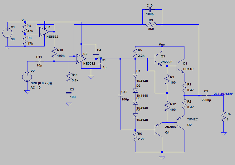

also you don't need U2 the signal op amp driving capacitance c1 & c4 to +rail and ground rail. You need U1 the voltage center op amp driving c1 to +rail and c4 to ground. However U1 driving the base of a TIP41 split between resistors between +rail & ground will get you a stable center voltage reference. U1 can drive the TIP41 capacitance because the signal doesn't change, it is supposed to be a dc value. then r3 & r12 can connect output of that transistor, buffered with more capacitors to +rail & ground rail.
actually c1 that you had in post 24 has been used by designers, but there was a reason somebody said it was a bad idea because ? If you do use the schematic in post 24, Make c1 a non-polar cap or a film cap instead of an electrolytic. electrolytics don't withstand much backwards voltage, except the NP kind.
Read you PM. If using a switcher supply as yours looks like, you need an inductive trap in series with the +30 coming in to stop the switching howl on the line. followed by a capacitor to ground of course. cheapest inductor I know of besides junk ones is the $10 doorbell transformer. MPSA55,MPS8099 are in the mail.

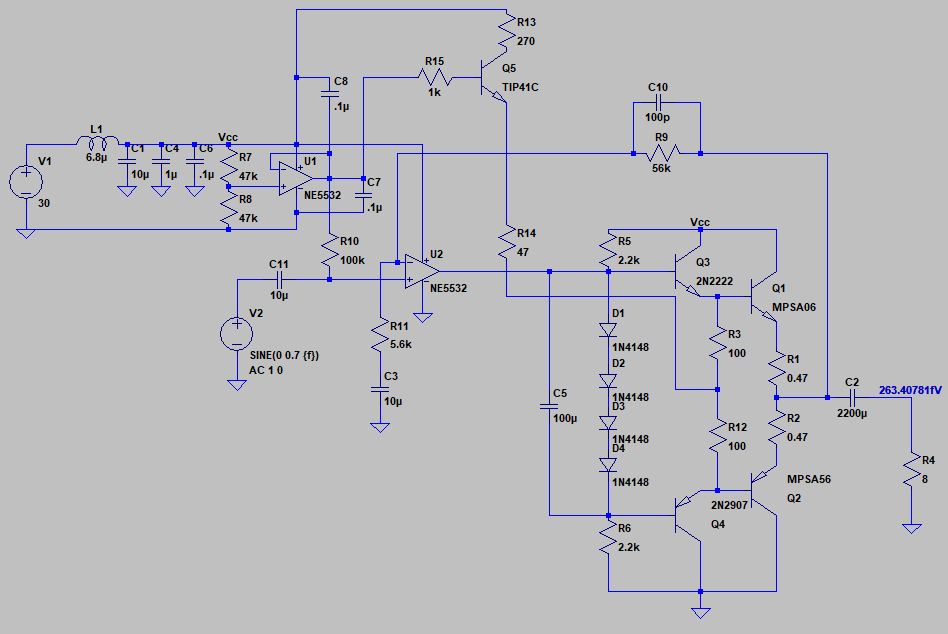

I'm unsure if C8 and C7 are correct, I mean, if that was what you were describing. C7 to me says, "super high f will see short and go straight to ground". C8 is a little unclear, but maybe, "super high f will see short to output, which will see short to ground".
The voltage regulated coming out of Q5 looks good to me, I need to do some math though and look in to why you chose 1k, 220, 47. 1k for ample bias current, right?
At V1 you can see L1, C1, C4, and C6. My thought process was, "low f sees L and will charge it and then pass through, high f will see open, but any that make it through will go straight to ground from that array of 10u, 1u, and 0.1u. Thoughts?
Output still looks good, I added the models for the MPSA56 and MPSA06. I had to switch the the alternate solver as the transient sims were gonna take an hour or so, and it seemed to work fine after that.
The collector of Q5 goes to the junction of R3 & R12. The bottom of R14 goes to negative rail, "ground". C7 & C8 are okay but you need another pair of capacitors from collector of Q5 to +29 and from collector of Q5 to minus rail "ground". 10 uf to 220 uf. This will make a center power supply for R3 & R12 to dump base current to.
I picked the resistor values out of the air. the current is lower out of the emitter of Q5 so that side doesn't need as much resistance as the collector. 250 + 47 ohms is 300 ohms, that would cause a 100 ma current, which gives a low enough impedance to dump base currents of Q3 & Q4 into without wobbling. A doorbell transformer is a 1.3 amp DC supply; presumably your wall plug switcher supply is even better than that. 100 ma of 1.3 amp is a negligable loss of power.

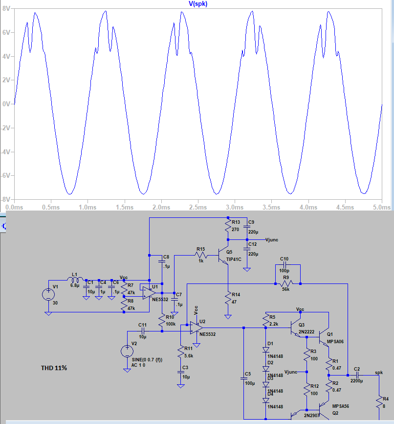

Trying to consolidate your advice. Is this what you're talking about? THD at 11%The collector of Q5 goes to the junction of R3 & R12. The bottom of R14 goes to negative rail, "ground". C7 & C8 are okay but you need another pair of capacitors from collector of Q5 to +29 and from collector of Q5 to minus rail "ground". 10 uf to 220 uf. This will make a center power supply for R3 & R12 to dump base current to.

that THD is bad. try moving junction of 2 capacitors Vjunc to emitter of Q5. Sorry, that is the voltage stable point.
If THD doesn't improve, just build it with the original 200 ohm & 100 uf between emitters of Q3 Q4. But use a non-polar cap, there will be negative voltage on it at times.
I couldn't figure it out. I moved back to the 220 ohm 100u configuration. THD down to 0.022181% (0.015590%). I'll make a BOM and post it here at some point.that THD is bad. try moving junction of 2 capacitors Vjunc to emitter of Q5. Sorry, that is the voltage stable point.

But if I add either the MPS8099/MPSA55, OR MPSA06/56, in the simulation, my transient looks fine, but my mag response starts rolling off at like 10k, where instead I designed it to roll off around 29k.
I've been tinkering with it for a few days, and it seems that I can extend the mag response by designing R5/R6 (resistors above and below diodes) to rune more current down that branch. This makes sense to me: more current down this branch, more biasing current flowing to the output transistors, this turns them on and will operate into the higher frequencies better.
But, there's a tradeoff it seems. The lower I go with the resistor values, so more current down that branch, my output waveform starts railing super hard.
Intuitively, this makes sense to me, but I can't put my finger on what exactly is going on here. Am I running out of voltage headroom? Is it the LTSPice models that I'm using? What is a good standing Ic (dc dissipation) that I should be designing for to keep these transistors on in a good operation region? Currently, there's barely a uA running through the output transistor branch at DC.
Thanks for all your previous help.
