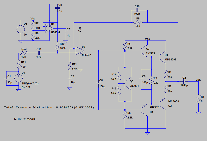

I was interested to read steveu's post 37 but can't figure out what post number he used to come up with the resistor numbers. Also dropping C2 requires a center tap transformer and you don't have that. ?? Also I can't read asc files since I don't simulate, so the suggestions don't mean much to me. Bootstrapping is fine, but I don't know what it is. Something about feeding drivers with output voltage through resistors, which sounds like a great way to cause oscillations. Also ostripper is one of the senior designers around here, author of the honey badger 400W amp at diysupply, but I can't read his asc file as a schematic diagram either.
MPSA06/56 are probably slower transistors than 2n2222/2907 but will be a lot less noisy at low volume. Also On semi parts are real factory controlled parts (mine came from newark), whereas central semi parts (I think you said you had) are generally whatever central can buy on the world market that is the cheapest part possible. As far as 20 k response, 1 your single speaker won't produce it unless it is 1" diameter or is a 4" with whizzer cone, and 2. most American males blew their HF ear response with firearms firecrackers or loud parties by the time they are 20. (My ears go to 14 khz tested at the factory, due to ear plug training I had in the Army and assiduous use of them. ) 3. Most pop albums don't have 10-20 khz, certainly not if they are mostly guitars & voice.
You want 5-10 ma running through TIP41/42 at idle (DC?) that is determined by the spread of the 4 diodes between the two bases of drivers. I warned you before about cutting one diode voltage down with a parallel pot with wiper connected to one end. If 2.8 v is not enough to make both output transistor turn on, add a schottky in the diode stack for another 0.3 v. Then adjust pot until idle voltage across a 0.5 ohm emitter resistor is 10 mv (5 ma).
Classic alternate way to get idle current would be to insert instead a "Vbe multiplier" instead of the 4 diodes, made of a heat sinked transistor like a BD139 or BD140, screwed to the single output transistor heat sink to collapse the voltage as it heats up. Search for Apex AX8 schematic for the simplest amp with that feature, as by contrast with Apex AX6 that I run with the diode stack on a terminal strip mounted over the heat sink. How much idle current you can get away with depends on your heat sink & heat washer: nobody uses TIP41/42 as output in class AB so I don't have a reference. But zero idle current sounds bad.
As far as limited voltage swing from this configuration, your power supply may only allow 1.5 amp or so, and that is 2.25*8 ohms or 18 watts. Your speaker was limited to 10 you said. 18 watts corresponds to a 12 v swing (rms) and I think with a 24 v supply this circuit can achieve that.
You don't have an input stage yet, I suggest a 100 ohm resistor followed by a 10k pot with one end shorted to wiper. Reason for the 100 ohm resistor you don't want to short your FM radio/cell phone when you turn the pot up to max volume trying to get your defective circuit to make some sound. Also put a 1uf or 2.2 uf or 4.7 uf capacitor in series with 100 ohms & 10k pot, some sources produce DC and the 5532 won't like that, responds assymetrically which clips one side before the power limit.
Also put 22 or 33 pf disk cap from input hot to input ground, to keep AM radio stations out of your circuit.
For emitter resistors on driver circuit, use 2.2 k as a safe way to start out. P=I*V and these are 500 mw transistors. Then you can tack solder on parallel 2.2k to lower it to 1.1 k and see if it helps anything or blows your parts. Compensation capacitor experimentation is tougher, you can tack some capacitance on with a parallel capacitor but to lower it you have to take out the old one and put in a new lower value one.
Your school lab does have a scope, right? You can check for oscillation at idle or ringing on fast slew rate inputs (square waves) with that. I don't have a working o-scope, I use an analog VOM and different blocking capacitors to see what frequency the voltage I'm seeing is actually.

What do you mean emitter resistors on driver circuit? Like slapping a 2.2k in between emitter of 2222 and base of MPS8099?I was interested to read steveu's post 37 but can't figure out what post number he used to come up with the resistor numbers. Also I can't read asc files since I don't simulate, so the suggestions don't mean much to me. Bootstrapping is fine, but I don't know what it is. Something about feeding drivers with output voltage through resistors, which sounds like a great way to cause oscillations. Also ostripper is one of the senior designers around here, author of the honey badger 400W amp at diysupply, but I can't read his asc file either.

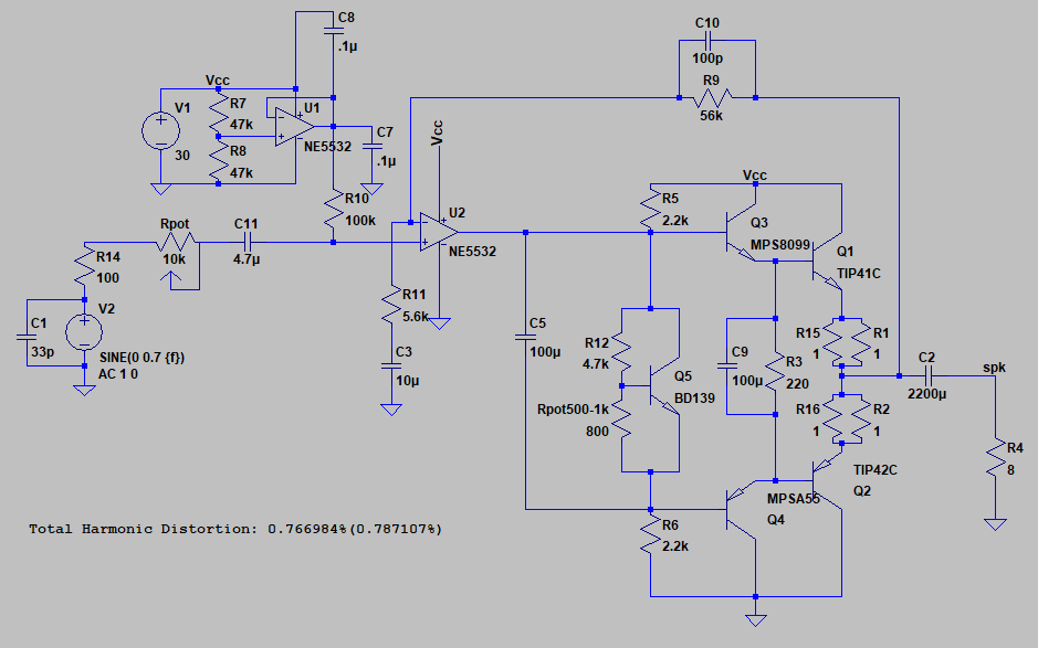

I was also wondering about the MPS8099, I'm reading the datasheet here and it seems its max Ic is around 0.5 A. Is this going to be an issue if in sims I'm running up to 0.9 A through it? Or is the 0.9 A going through the emitter, and the total device wattage will be in spec?
Could I do a Vbe multiplier with either the 3904, 2222, or 41C and get away with it? I could try that instead of the three-four diode drops.

Sorry, the power limiting resistors on the driver transistors are the colector resistor R5 in post 32 (2.2k) and the invisible one on the bottom.
People use BD139 or MJE340 in TO-126 as Vbe multipliers because they have a metal flange the die is mounted on. So the heat of the heat sink communicates fast to the transistor that it is time to drop the output idle current. Heat does not move fast into TO-92 transistors. Real 2n2222 in the metal TO39 cans, you could actually clamp them to the heat sink. But plastic transistors, no heat sensing. TIP41, yes it has a heat sink but the mass is pretty high to make a Vbe multiplier out of it.

I simulated this, seems to be okay, I could build this one I think.
As for 0.5 ohms, I was thinking about putting two 1 ohm resistors in series and therefore can share the power rating. Max power going through those in this sim is 377 mW, so two 1/4 Watts could totally share that power.

Check your math.
The MPS8099 MPSA55 were to replace the 2n2222 and 2n2907 drivers. Not the TIP41/42 output transistors. MPS8099 MPSA55 are also 500 mw transistors. You need TIP41/42 on a heat sink for output transistors. Or at least TIP31/32 or some TO220 package transistor. Vbe multiplier goes on the heat sink too. When you order your project board capacitors and heat sink, splurge $1 on a MJE340 or BD139 as a Vbe multiplier. Don't forget the heat sink silicon pad insulators.
Well that would make so much damn sense. I was getting so confused there. Alright this looks okay to me.The MPS8099 MPSA55 were to replace the 2n2222 and 2n2907 drivers. Not the TIP41/42 output transistors. MPS8099 MPSA55 are also 500 mw transistors. You need TIP41/42 on a heat sink for output transistors. Or at least TIP31/32 or some TO220 package transistor. Vbe multiplier goes on the heat sink too. When you order your project board capacitors and heat sink, splurge $1 on a MJE340 or BD139 as a Vbe multiplier. Don't forget the heat sink silicon pad insulators.

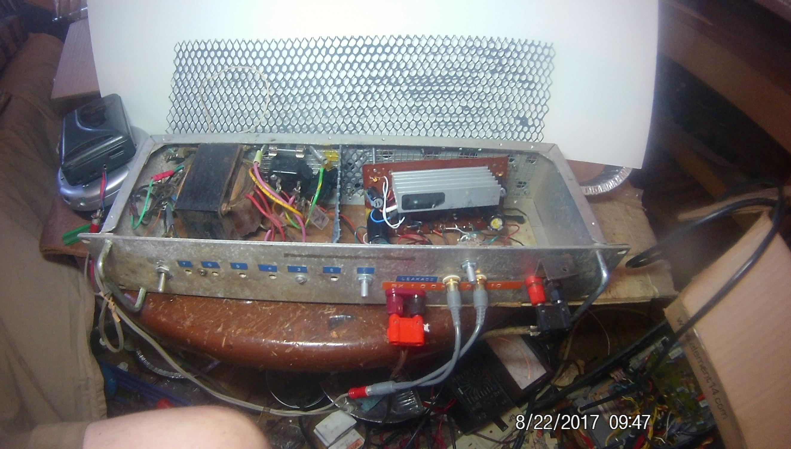

I bought a perf board from the school, I think ittl work let me check. Let me update this post I'm gonna check digikey and put a lot of that stuff on BOM
EDIT: Yup the NE5532 totally fits in that middle section

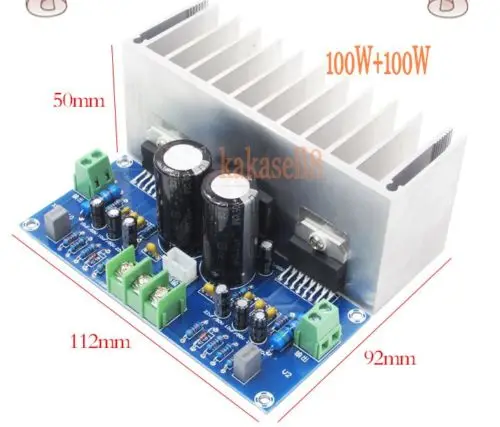

So something I'm a little confused about with the main hear sink. Do I put my output transistors towards the side, and then bend them down/over to be drilled in to the heat sink? I'm going to look up some images to get a better idea, but do you happen to have a solid reference to a configuration of what size / orientation the heat sink is supposed to be, and how you fit it near / on the board?
Edit: something like any of these?
I see how they're bent down and screwed in. Or placed at the end still standing up, adjacent to the heatsink. Am I looking for something like one of these, where I can set the board kind of "resting in the middle", and the output transistors can be hooked to each side?
EDIT2: Theres a big metal scrap box at school, I think I'll look through that and potentially make my own if I find something good.

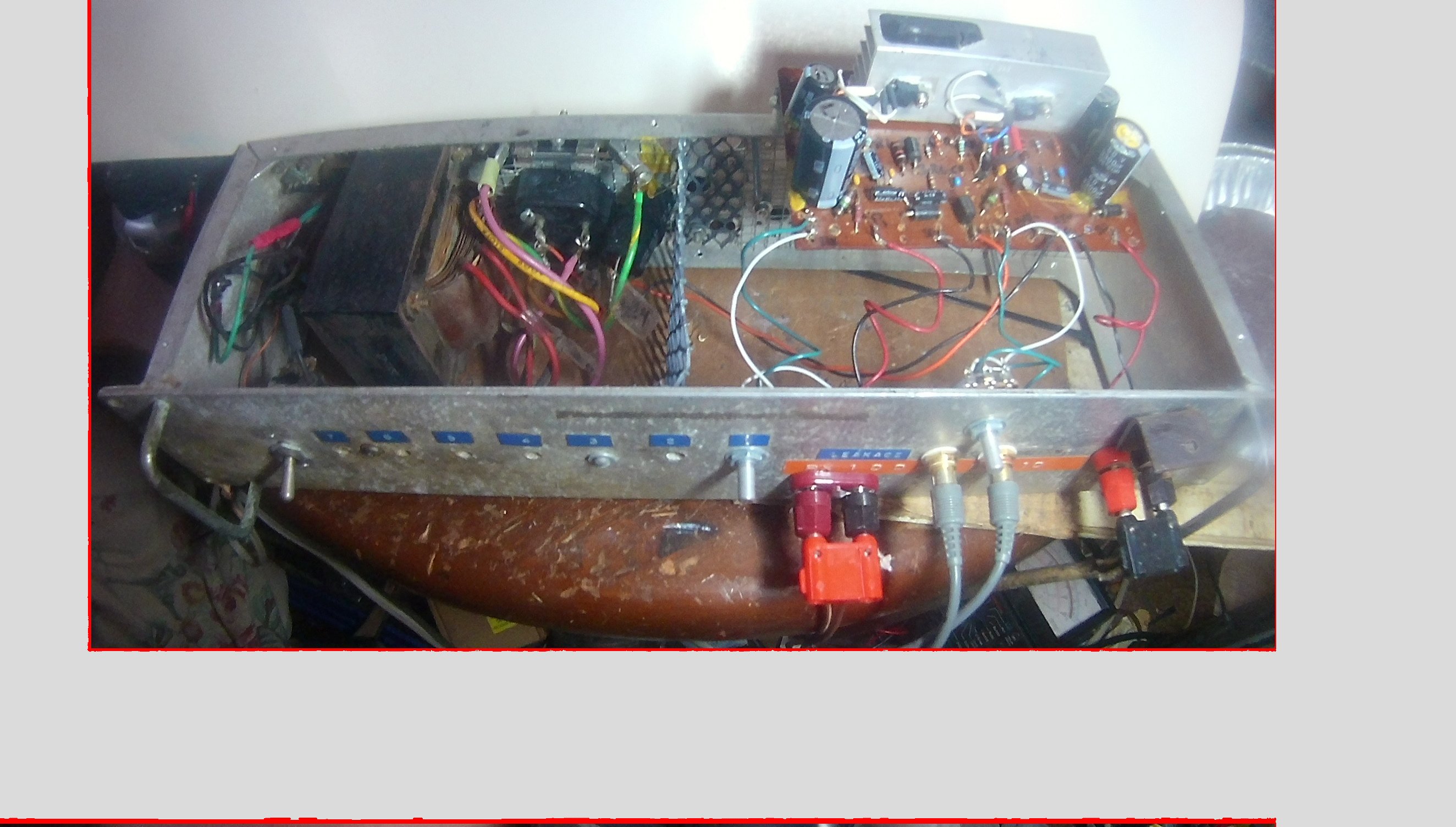

Here is my LM1875 board with the heat sink mounted to the board and the IC's screwed on it. I should have turned the legs down and drilled holes through the board for the 5 leads, but with 5 of them I didn't think I could bend them that far without breaking them. Doesn't oscillate at gain 10, I think I got away with having .1 caps 3" away from power leads. The heat sink has legs on the bottom, with a wired soldered between them on each end under the NEMA CE board.
Second picture is the amp board flipped down inside the case. There is a 3rd way, flipped over screwed to the angle bracket shown on the front, so I can adjust the wiring without the board flopping around. I have since added a fan to the left of the RF bulkhead blowing on the heatsink, after moving the mesh bulkhead right.

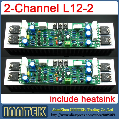

After is an e-bay amp sold without heat sink. Obviously the transistors are on the near edge with the heat sink about 8" x 8" underneath the board. So transistor leads are bent up 90 deg. The heat sink you see is the driver IC, a lme49810.
Most conventional amps have the output transistor on back edge pointing up, with heat sink vertical to the flat board. Screwing the board to the heatsink so the transistor leads don't carry the shock of dropping the amp, is a trick. You're going to have trouble with that since your project board doesn't have mount holes on it for brackets. I suggest putting the transistors on the heat sink, mounting it to the metal case, and run stranded wires from the output transistors to the project board. Make sure the Vbe leads, which are an input, are well separated from the OT leads, which are an output. Else Oscillation could occur.
Okay. I will take a look at the what is at school and then if I can't find anything good, I'll add a heatsink to the digikey order. No, I have not bought anything yet from digikey. The school also sells wire, I'm going to look and see if they sell 16 gauge.Here is my LM1875 board with the heat sink mounted to the board and the IC's screwed on it. I should have turned the legs down and drilled holes through the board for the 5 leads, but with 5 of them I didn't think I could bend them that far without breaking them. Doesn't oscillate at gain 10, I think I got away with having .1 caps 3" away from power leads. The heat sink has legs on the bottom, with a wired soldered between them on each end under the NEMA CE board.
