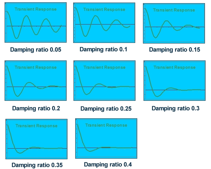

Hi Jim, ooops I double checked on the 3150Hz files you posted, and confirm they do show both lateral and vertical resonances near 4Hz. I must have picked up the wrong file to run the spectrum analysis, easily done, apols. The polar plots are definitely right though !
Of those methods, the logarithmic decrement can also deduce the damping ratio which is really the elephant in the room and no-one ever talks about.....
In this case, damping ratio works out slightly less than 0.1, perhaps 0.08 or so, which is fairly typical IME, and generally a bit skinny. IMO, about 0.15 is a good compromise/target.
Here's a chart of settle times versus damping ratio, you can see what I mean.
LD
LD

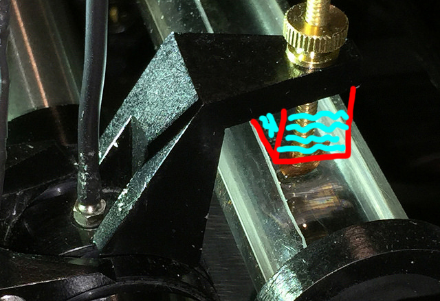

Super, I did read your post of cutting of frequencies above 30hz but somehow forgot. Sorry about that.
Super and AVWerk,
kindly see attached picture. I used the wrong word (enclosure) a tiny chamber filled with damping fluid. Will that work ? or one can use tuned mass damping like Dual tonearm.
Super and AVWerk,

Hi Hiten,
It works ONLY IF you have a mechanism to move the container along with cartridge.
I don’t know Dual tonearm so I can’t comment on it.
Jim
Jim

The silicone fluid I am using now is about 3500 CST. I can’t tell exact CST since it is a mixture of 3000 and 5000. I may use low CST once I modify the paddle. I think Walker Audio uses 30 CST which is like motor oil. I am thinking something like 1000 CST. High CST gives me wider range to adjust the damping.
Hi David,
Vacuum platter is nice but it involved a bit too much for diyer like me. Also, not all vacuum platter sounds same. Some of vacuum platter may reduce warps but in the meantimes, it may change the sound due to the material used for vacuum mechanism.
I don’t know if vertical damping will attenuate or shift resonance frequency. I will do some experiments to see what happens.
