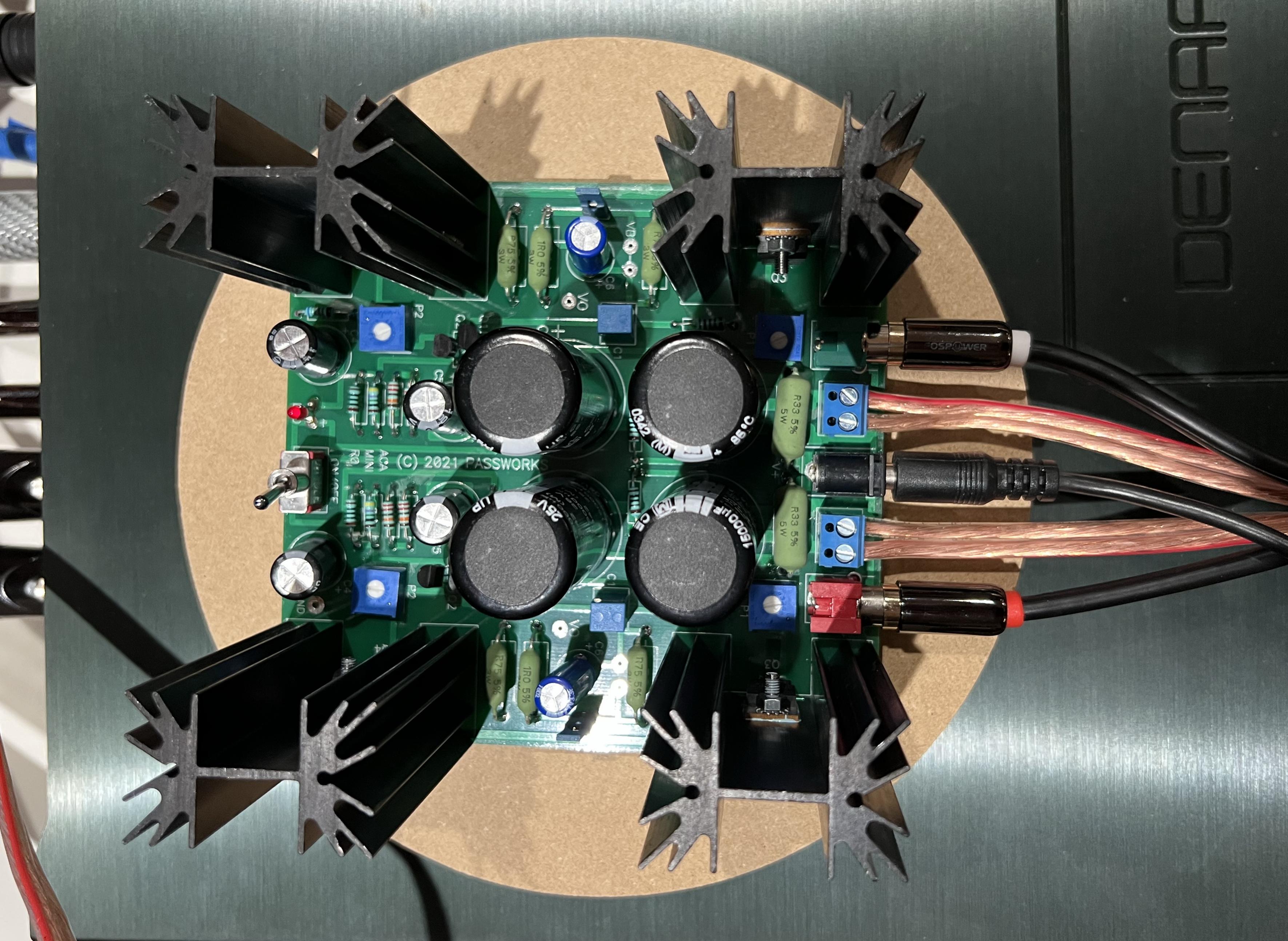

I finished my Mini ACA tonight. Thanks to Nelson and everybody else that made this possible. First thing I won in decades!
Very nice, straightforward build but special thanks to 6L6. Despite doing what I thought was careful checking of the polarity of the capacitors I managed to insert two of them backwards and it was only a quick glance at his pictures that let me catch the mistake before soldering them in. Except for that idiocy the hardest part of the build was scrounging up some 14 AWG speaker cord to fit the terminals. 12 AWG is just a bit too thick.
This little amp sounds surprisingly good for its size and cost. I like it better with the jumpers in. I have V0 set at 11.55 and VB at 0.39. Heatsinks at the mosfets are right about 56 degrees C. It has a lovely clear, forward kind of sound that reminds me of a mix of F5 and F6. It has just enough power to drive my Tekton Moabs to 80-85 dB without using a preamplifier with gain. It will be interesting to see if burn in changes the sound at all.
Bottom line the Mini ACA is a winner!

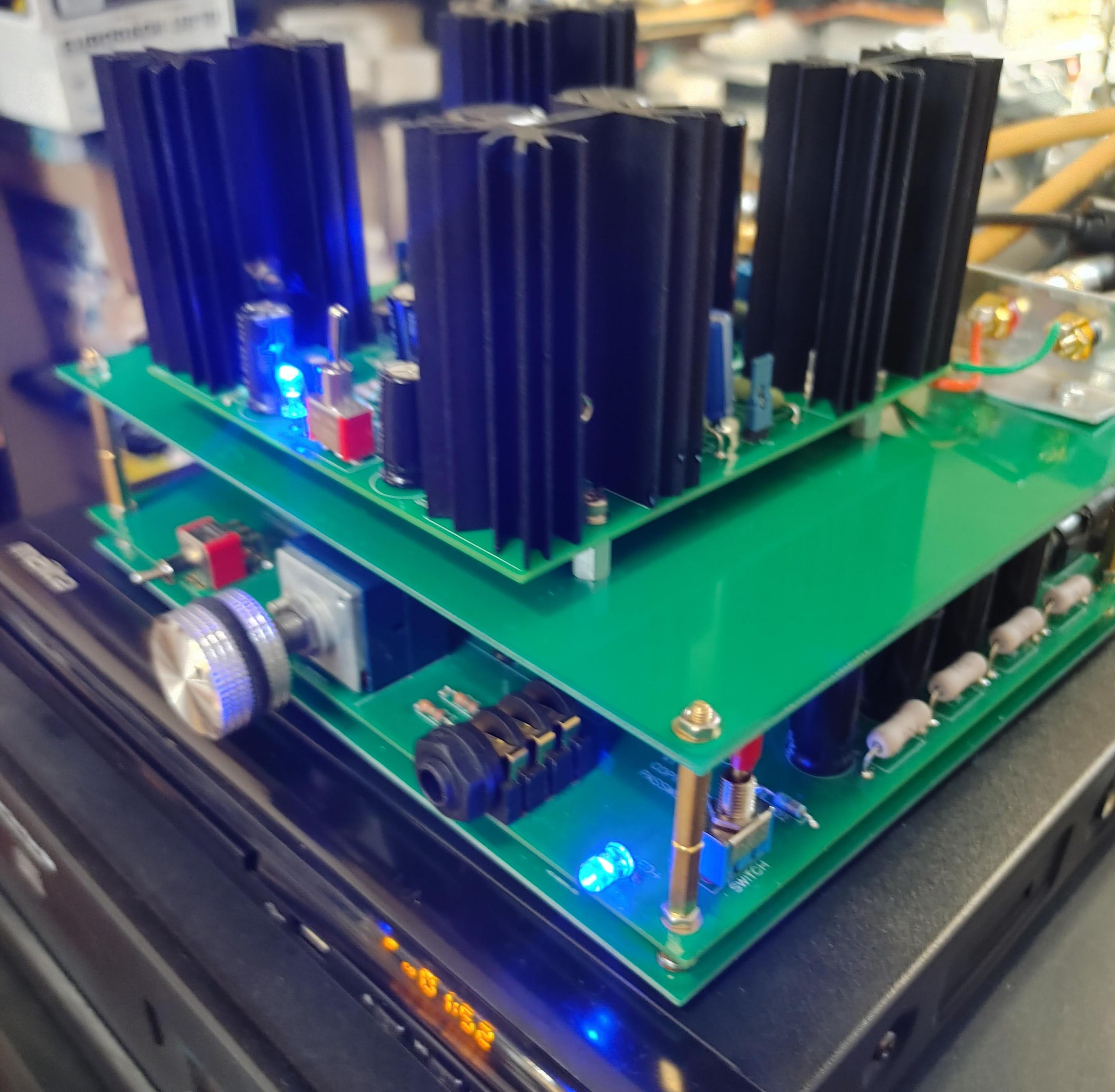

Finished the ACA mini yesterday. Used a spare ACP+ ground plane for mounting it atop the ACP+. Burning in nicely. Sounds really nice with good volume for the ONIX speakers I use as test monitors in my lab. Thanks again to Nelson for the design and for BAF 2021.
